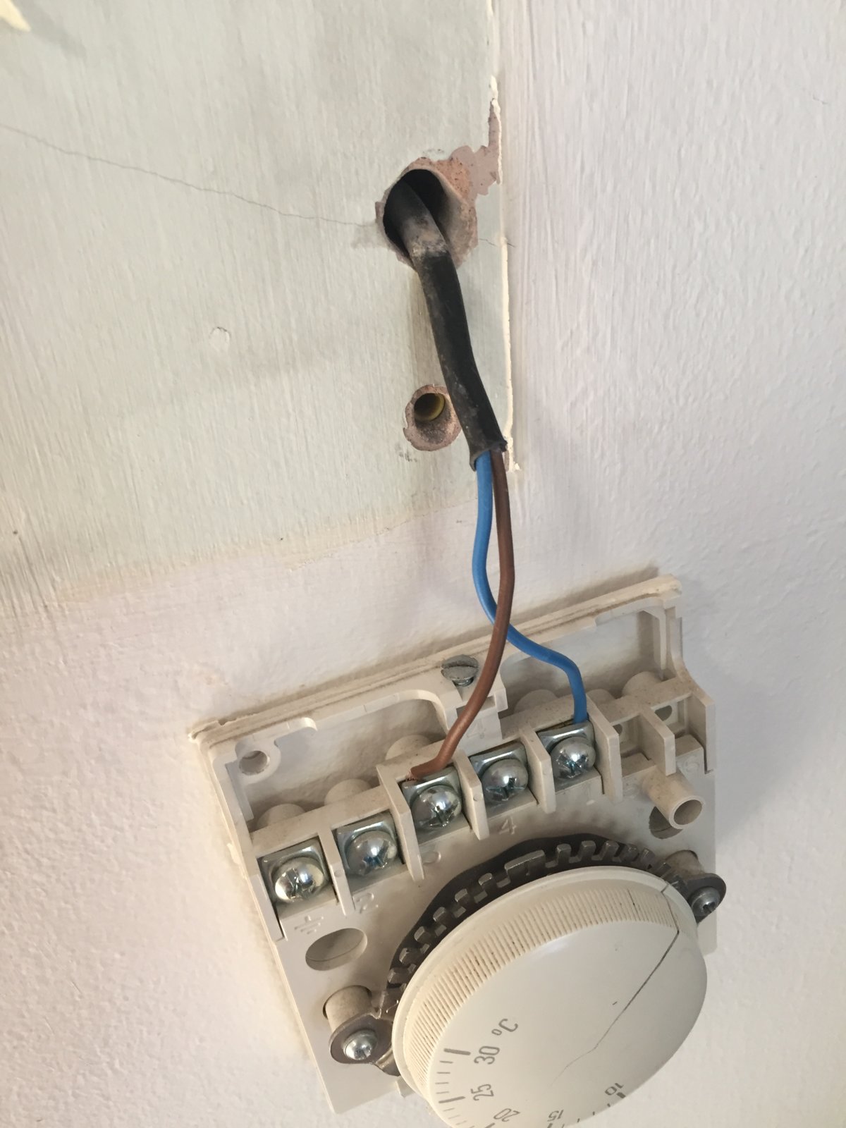

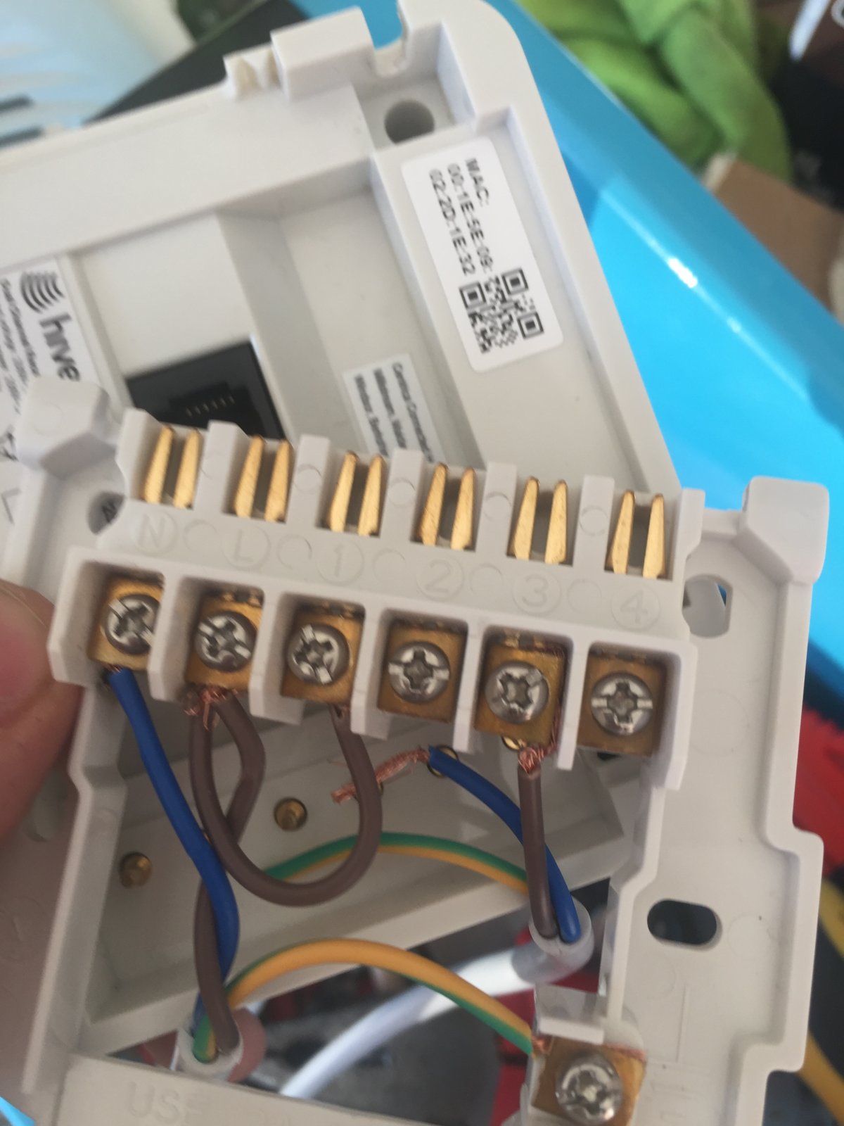

Right.
So. Managed to get a Hive thermostat dirty cheap on carboot sale. Looks new. Did all internet bits. Boiler is Independent 30. So u can hear clics whenever u turn it on/off. Had a simple 2 wires termostat before. Did loads of tries. Blue goes to number 1 brown to 3 etc. Linked tried a lot but now give up. Check the pic please. Some ideas ? Does it have to be connected to the boiler on same power cable ? (Tried and cried)

Problem is the wiring( I believe)
As mentioned Can turn the thermostad on/off App shows that burner works but it’s not. I did separate L N from socked and plugged in blue brown wire from the old termostat to 1 and 3. No luck.
There is quite a lot to read about fitting the Hive as a DIYer. Do have a Google. One thing that might help is if you are not going to remove the old room stat, then try turning it up to its Max and leave it at Max, now try controlling the boiler via your new Hive. This might be the answer to your problem.
As mentioned before old one gone now.

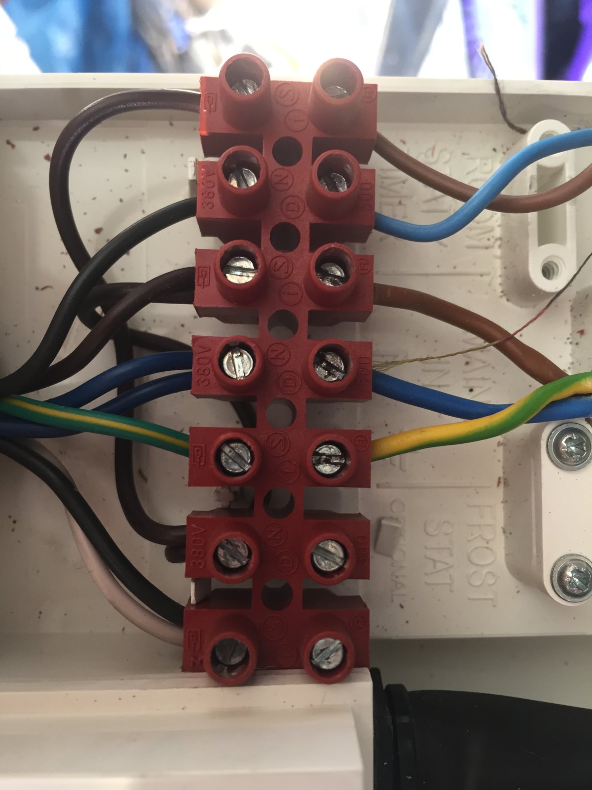

The only wires I have in the room is blue and brown. I can fit it in the garage next to the boiler. I did that in the matter of fact. Wired and plugged the brown and blue from old thermostat. See pic. I did try all possible combinations from this forum. There is no timmer. The only issue is that regardless how I do wires that Hive does not turn on/off my boiler but I see green light comming on and off

Downloaded manual Today and .. this is Dual Hive. I love to connect it. I had a go. Used L2 and L4. ( brown 2 blue 4) Other user suggested L4 only and link Live with L1 Another one same link with L3 :eek:. No luck. Still same issue. What I noticed therefore that both wires ( old thermostat blue and brown) are live !!:evil: So not sure now if all these tries not messed up with boiler ?? Any suggestions please ?

So it's a duel channel hive and not a single.
Yours is to control your hot water heating and your central heating independently .

This is a combi boiler.
Hive is a duel one.
Wiring of the combi as per pictures.

It could be possible, I say could, but not as easy.
Don't just try moving the wires about, you could do damage to the boilers pcb.
