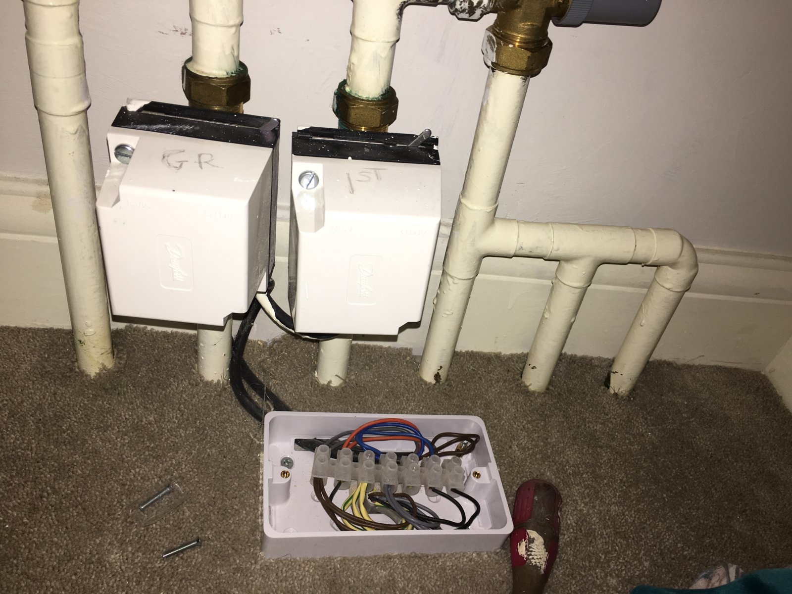

Hello all.
Just moved into a new build (ish) house (2015) which has a ideal logic es35 boiler and two danfoss tp(4/5)000 thermostats. 1 in the hallway and 1 int he master bedroom.
Looking to replace with a nest thermostat but it appears more difficult to confirm its possible than would first be suggested.
Out of the boiler is a large white wire going into the wall.
in an upstairs cupboard is a electrical box mounted to the floor with a connector block and multiple wires.
This in turn is connected to two which boxes which are attached to some copper water pipes (no idea what these are, would be greatful of an explaination).
From there it looks like wires from this area go to the two thermostats. Both thermostats just have a black and grey wires attached to points 2 (com) and 3 (n/o), with an unused grey wire and a ground.
both com and n/o dont appear on the nest compatibility checker tool and so im at a loss to figure out how to get one of these installed.
Whats more this electrical box with connector block has a multitude of wires, none of which are labeled.
Im a confident diyer given the correct information and understanding, is this a pro install needed or could anyone give me some pointers to figure out what all these parts of the system are (even just for my sanity).
Cheers.
