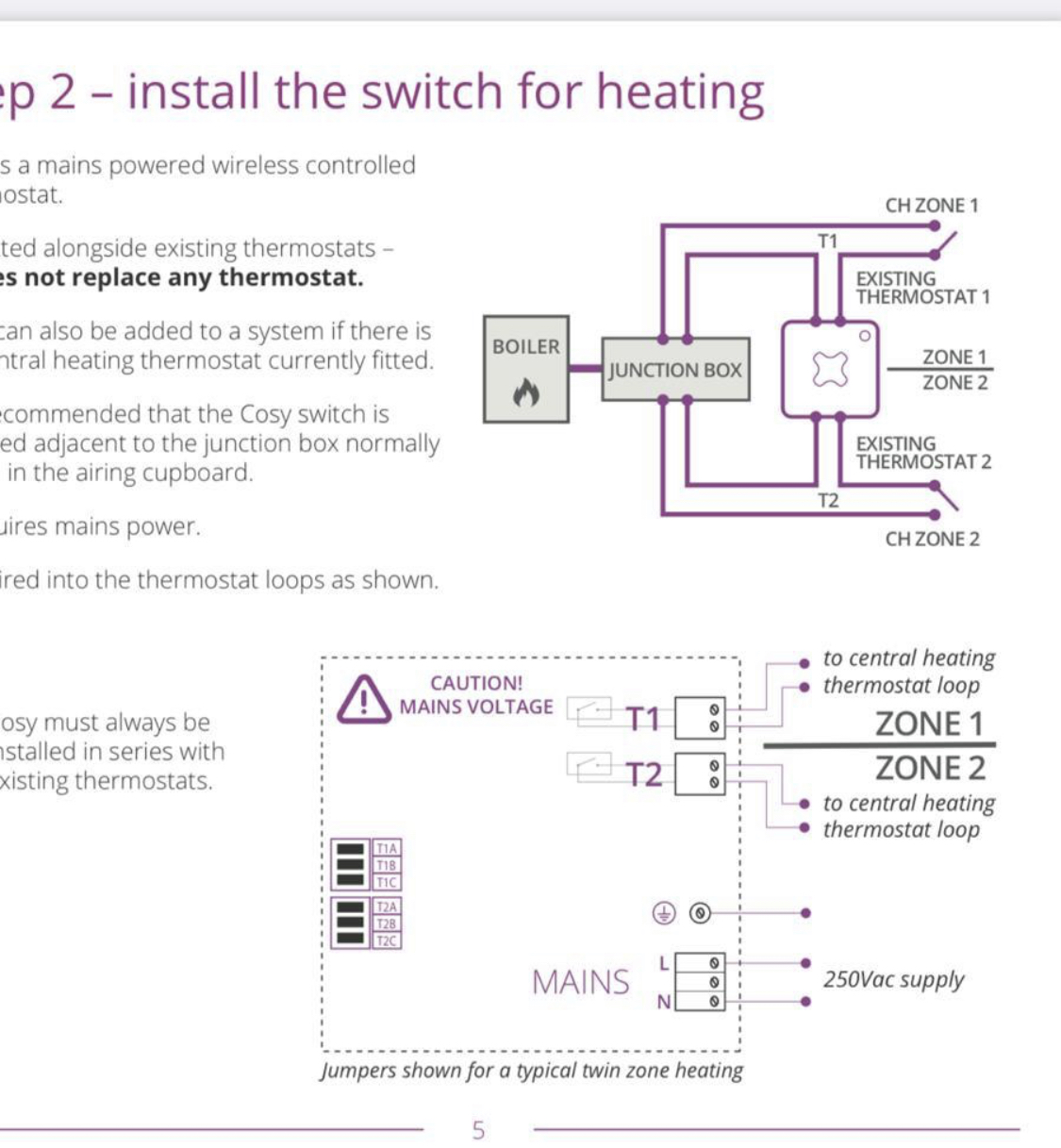

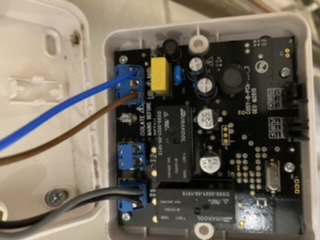

Hi,
Apologies if this is in the wrong place. We’ve recently moved into a house that has a cosy geo installed which we want to replace with a nest system.
Having had a look at the current installation I think I need to only use the two wires currently in the T1 box? If I’ve understood the wiring diagram right then the grey is the Com wire and the black is N/O?
The mains wiring isn’t required for the Nest heat link I think?
Has anyone replaced the cosy geo with the nest before?
Any help is greatly appreciated, we’ve been left with no instructions on what’s currently installed so it’s a bit of a nightmare!
Jim

It depends which version of Nest you have got.
If it is the Nest E, then what you have written is correct.
If it is the Nest Gen 3 then that does require mains.
As @Johnmdc if you have a nest E then that is correct,if it is any other Nest you will need a L&N to power the nest
Looking at the diagram the existing is an on/off thermostat, where Nest can be used both on/off or modulating, and if the boiler can use OpenTherm then it would make sense to use the OpenTherm option.

Thank you for the responses, it’s a nest e so will try and set it up later on today.
@ericmark I’ve had a look at the opentherm option but from what I can tell the boiler doesn’t currently support that.
