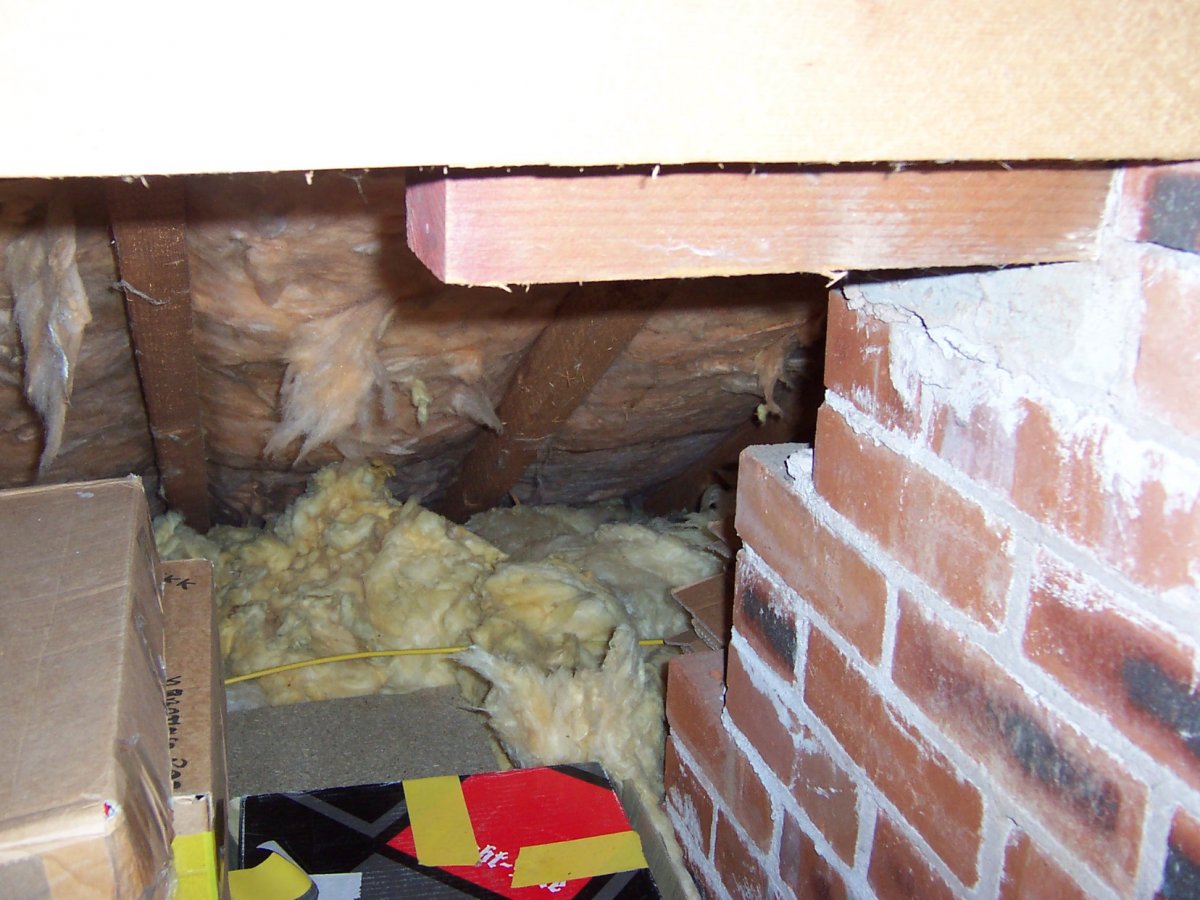

The other day I happened to go into the loft, and noticed a small amount of condensation on the underside of the roofing felt. The space between the rafters is insulated, and judging by the dry moisture tracks on the underside of this insulation this is not a new problem. There's no sign of any rot in the timbers so presumably this problem only occurs in very cold weather.
I've read this forum's Wiki on this topic and a two part solution occurs to me. One, there's little air movement in the loft and the internal space at the roof edges is too limited to allow easy access to clear away any insulation or create new gaps, so I need to have roof vents fitted. Two, the bungalow has a concrete floor and all CH pipework enters the loft through the ceilings, so I need to make sure all those gaps are sealed, along with the loft hatch.
Is there anything else I should consider doing to help the situation? We have extractors in both bathroom and kitchen and the insulation on the loft floor, which is boarded over, is minimal, so I can't imagine that the loft is particularly cold.
Don't understand that. Show us a photo please.
Also a pic of the eaves, in daylight (light should be visible through the gaps)

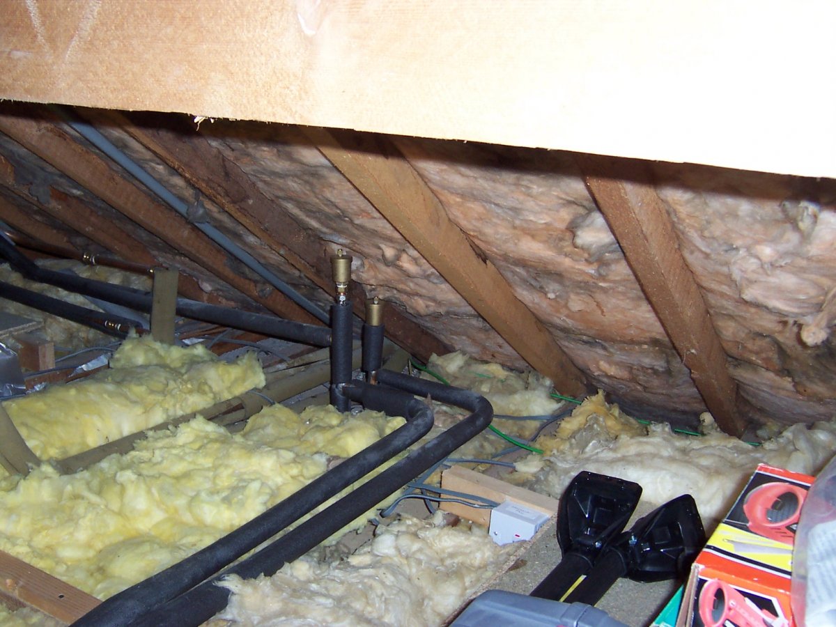

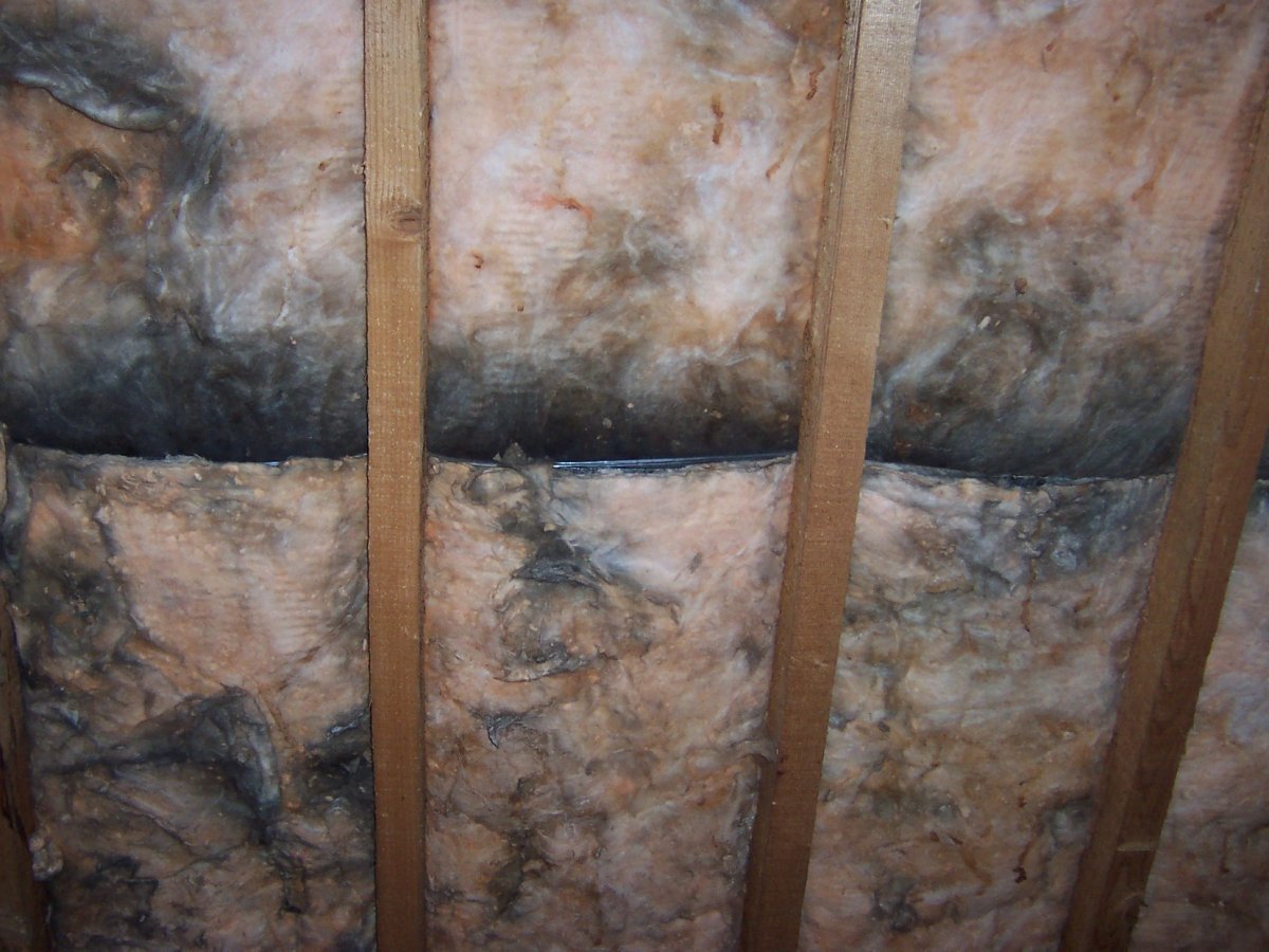

The gap on the underside of the roof slopes between the rafters has been filled with insulation, though I'm not sure how it's held in place because it was here when we moved in. This is the blanket insulation that comes on a roll, and which is normally used on the loft floor between the joists.
I don't think the eaves admit any light during daylight, but I'll post a photo tomorrow as requested.
so, starting from the outside, there are tiles, then felt, then mineral wool. Is that right?
That's correct, yes.
Pictures now attached: first one shows insulation between rafters, t' other two the access to the inside edge of the roof space.
I suppose with a bit of crawling I could get in there to ascertain whether any additional ventilation is needed; and if so, how it might be created.

That insulation is extremely odd, it looks like someone laid it on the rafters before the felt! And I'm guessing it's wet because there's too much humidity in the loft, so agreed that ventilation will help. Maybe you don't have any at the moment.
The surveyor said when we bought this property in 2014 that putting insulation between rafters used to be a common practice, but is no longer considered efficient. However, it's not something I've ever seen before either, and this is the fourth home we've had with an accessible roof space.
I went up into the loft before, in daylight, then shut the hatch behind me and sat there in the pitch dark for at least five minutes to give my eyes time to acclimatise. However, not a chink of light from the eaves did I see.

Just to add that in the pics the insulation does look extremely wet, but it isn't. The darkening effect is probably the discolouration of age, and its only where the felt overlaps that there's a small amount of moisture.
