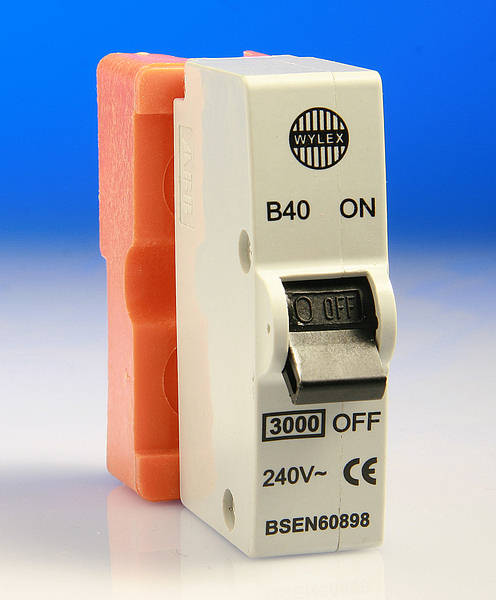

I have seen them for the WYLEX fuses and for the MEM but as they are all now obsolete, you might find it difficult to obtain one...
If you have the brown WYLEX fuses you can get a plug in MCB to replace the fuse
Wylex Plug-in MCB's
Rated 40 Amps
General Domestic Consumer Unit use
Wylex Plug-in MCB's detect overcurrents due to both overload and fault currents.
The MCB will operate and interrupt the supply to prevent damage to the installation.
Wylex Plug-in Domestic MCBs have a short circuit breaking capacity of 3000A (M3).
The current carrying capacity of the cable should always exceed the current rating of the MCB to prevent damage.
The operating dolly may be locked in either the ON or OFF position without affecting the ability of the trip mechanism to operate.
Direct replacent for Rewireable and HRC Fuse carriers in the Wylex Standard Range
It's pretty borderline but 6mm T&E should take 47amps if it's installed as per a normal house (ie not in a thermally insulated wall etc) and just buried in the plaster. This current carrying capacity only applies if you don't use a rewirable fuse. You must fit an MCB (as in the picture above).

I am 95% sure that the old Centaur rewirable fuses are the same dimensions as the Wylex rewirable fuses and the holder itself is the same as the Wylex one. If the Centaur whole fuse wire cartridge for the 5amp is white (wylex has a white dot), 15amp is blue (wylex has a blue dot) and 30amp red then the plug in MCB above will fit the Centaur CU and at about £7 each, it will do the job .... certainly a cheaper option than your unexpected board change, although that's a job you should probably think about at some point.
Alexnic, thanks - that's right, the Centaur has red 30amp, blue 15 amp etc, so that's good news. I think I'll nip down the local electrical wholesalers and see if I can get a plug in MCB - great news ! :D
Cheers,
Phil
I got a plug-in MCB just like in the picture you posted Alexnic, and it fits just great in place of the rewireable 30amp fuse, so I'm very happy! :D
