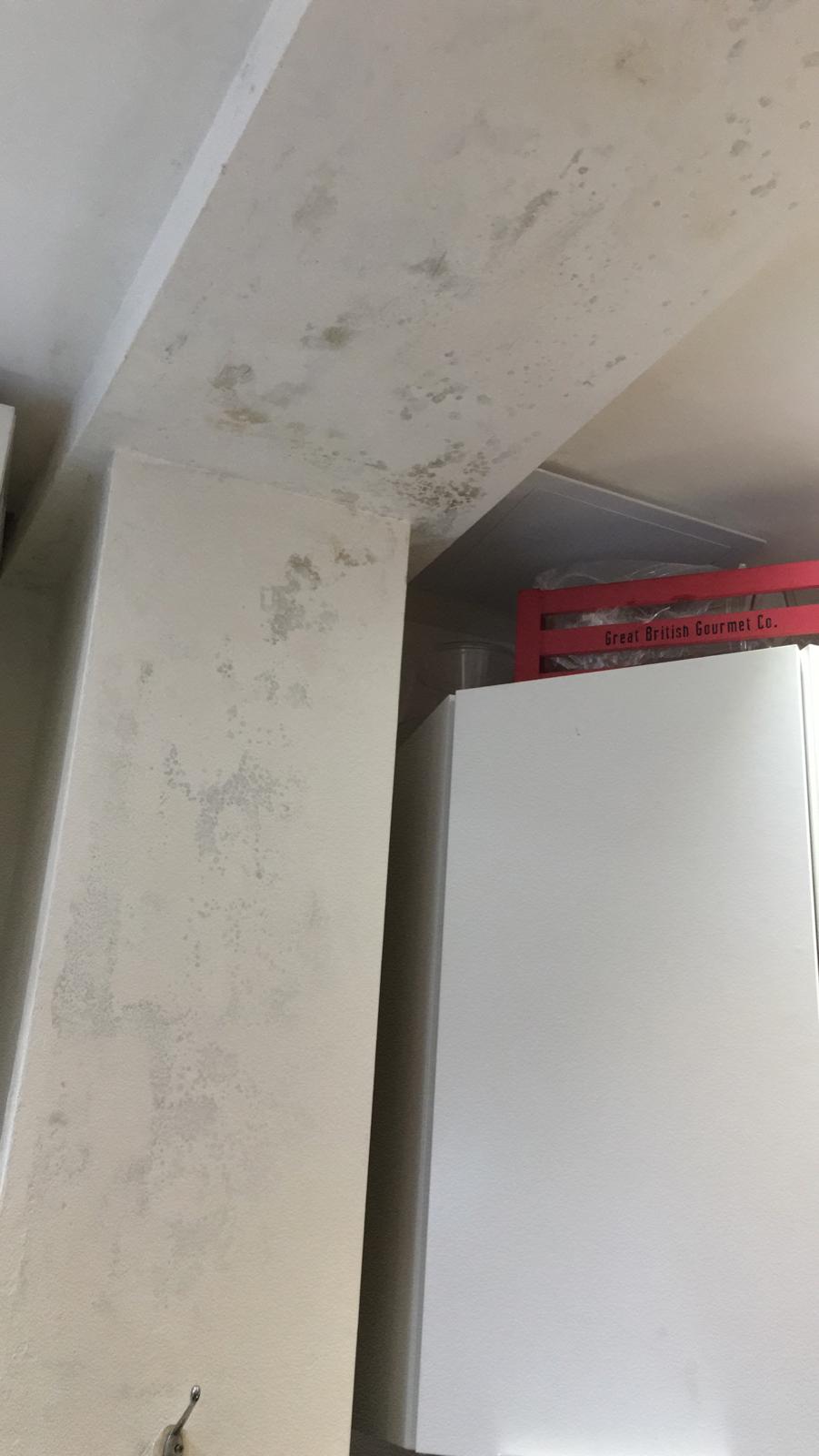

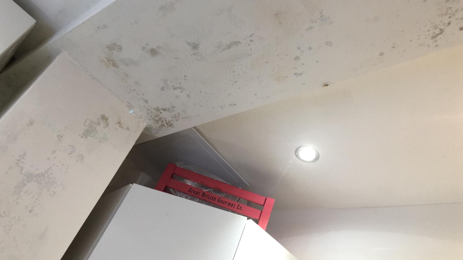

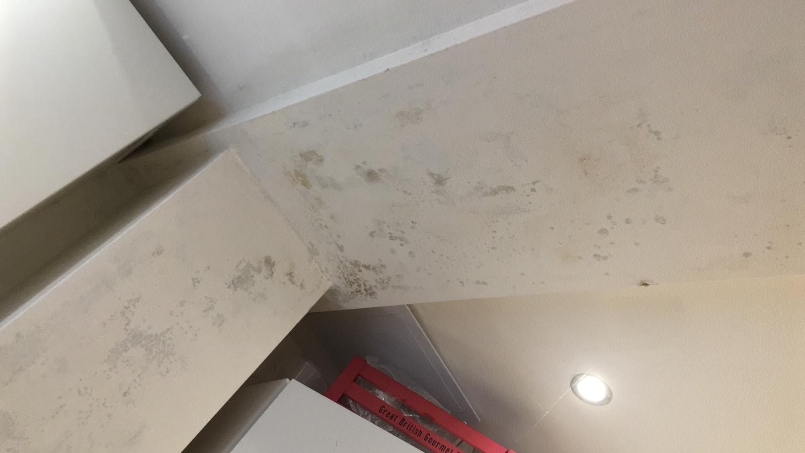

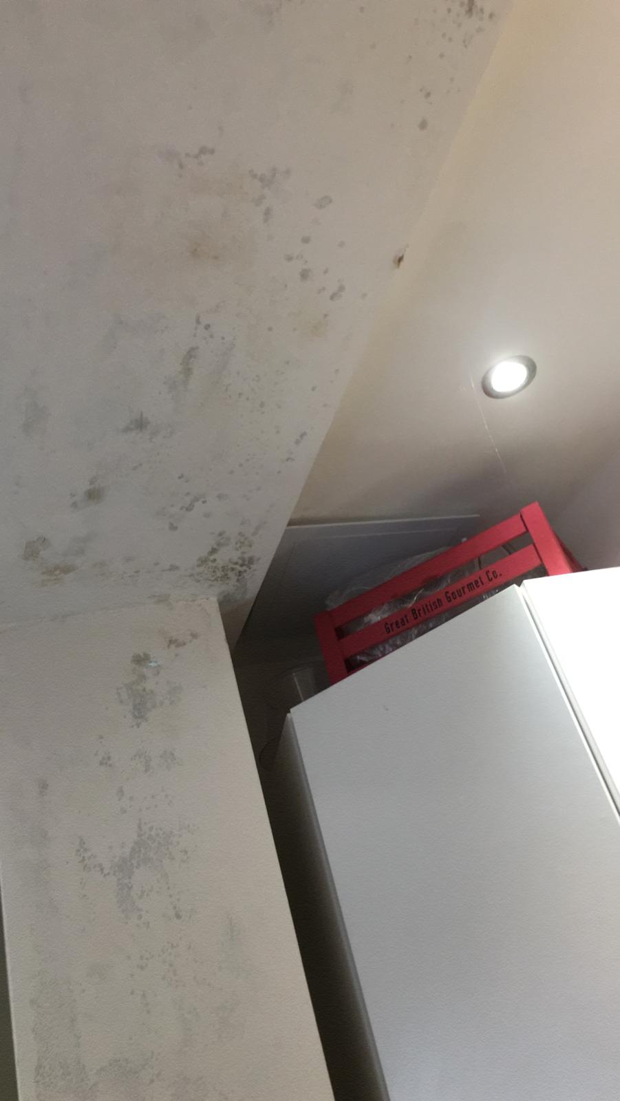

I ve seen a few paint flaking threads here and I’d just like some help in confirming this is damp damage.
Yes we had a leak from the flat above but it was a little further away from where it’s all peeled
can I just sand and paint again and what paint (zinnser) or otherwise should I use for a diy repair!!
ChloeRadshaw1, good evening.
It is not uncommon to find your situation, where the leak upstairs is some distance from the damage you can see inside your property.
What can occur is that the leaking water runs over the upper surface of the plasterboard untill it hits an obstacle or downward recess [the beam]
As for repair as you note Zinsser.
When did the leak occur? and [most important] has the leak been addressed?
Suggest you try to place a piece of Kitchen roll on to any larger damp patches and see if the plaster is indeed dry? the paper will attract moisture quite fast, if the wall is still "damp" suggest you beg or borrow a fan, do not bother with any heat, just adjust the fan so it is playing on to the walls and beam.
Ken.
Thanks so much. The leak was a few months ago and has been fixed.
Now it’s dry. What paint is the right one to use. Zinnser 123 or zinnser primer sealer
Go for Zinnser bullseye 123, Chloe - not as quick drying as the ‘bin’ but seems to stick better.
Very limited smell and covers everything, especially the likes of nicotine which always bleeds through.
John :)
Amazing thank you. Do I have to put a top coat on or can I just use the 123 a few times and leave it.
Thanks again
