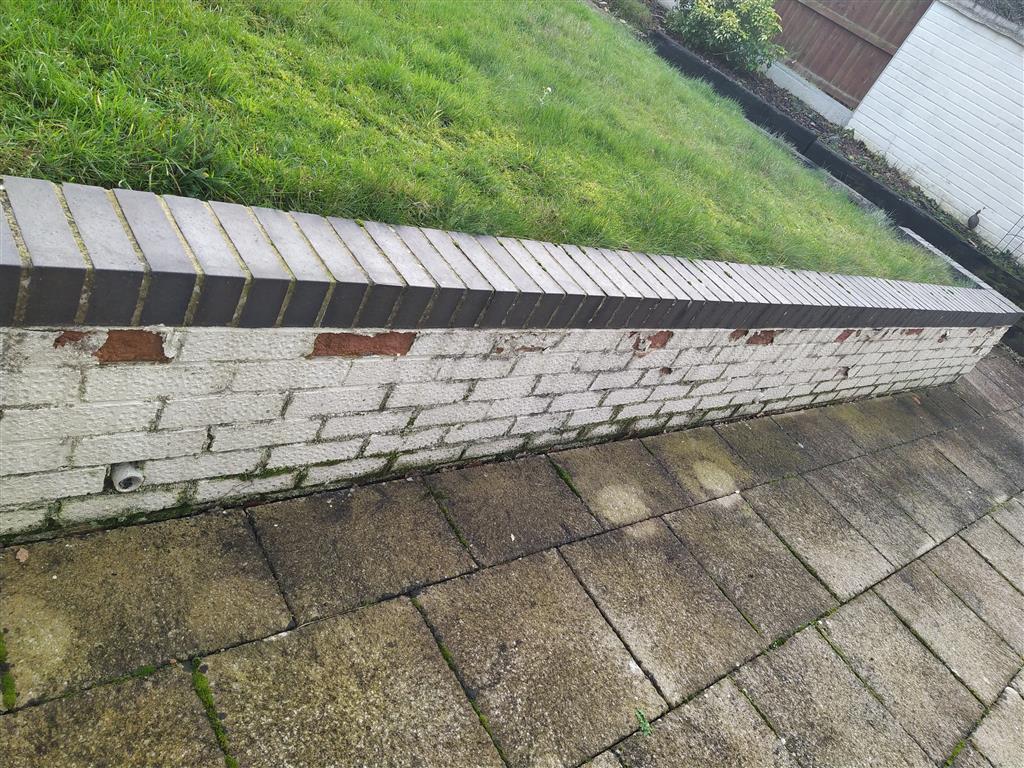

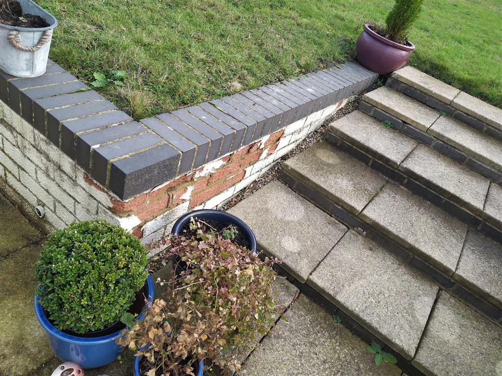

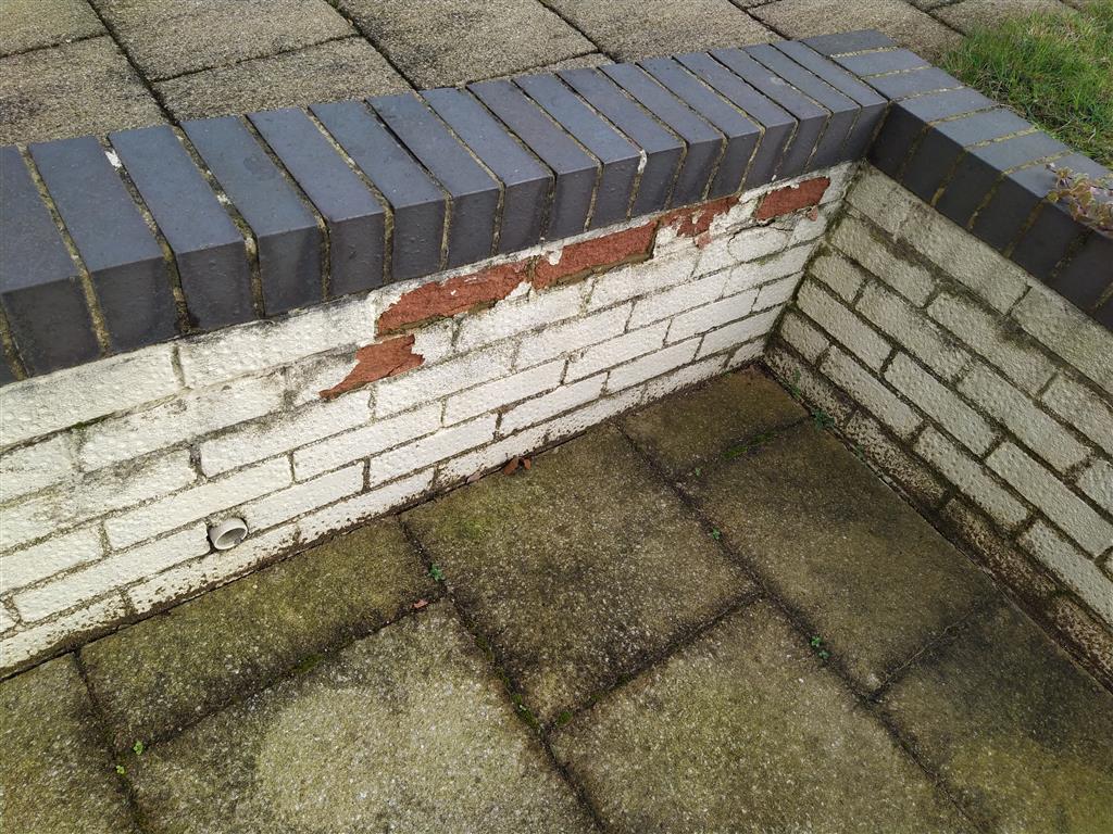

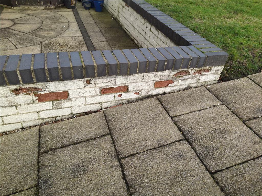

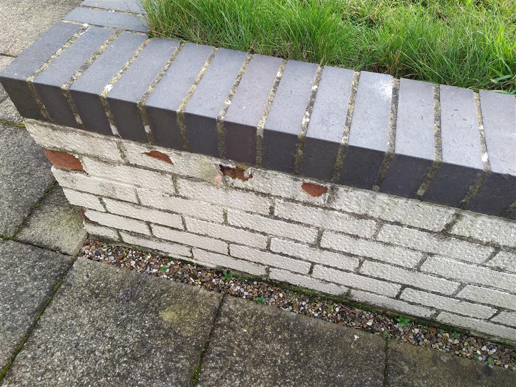

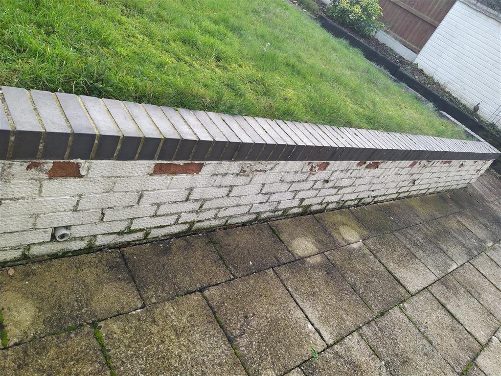

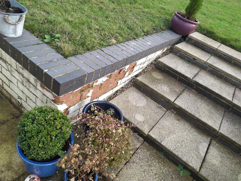

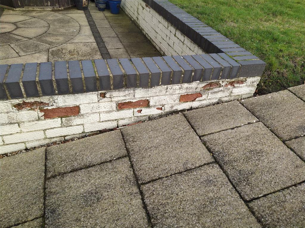

Our retaining wall looks dreadful. Bricks blown, we painted it but the bricks keep blowing.
What do we do.?
End result would be nice to have the engineering top and paint the sides but want to have a solution that will last and looks nice.
Holding back the earth as you can see.
Some blown parts of the wall don't have earth behind, some do.

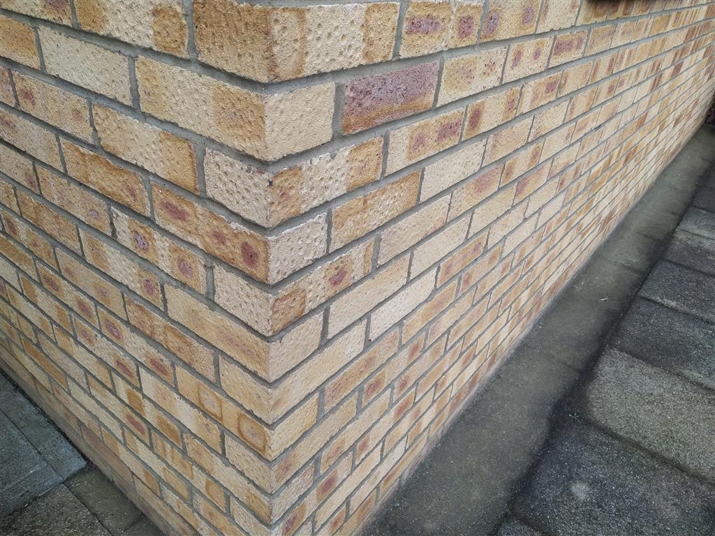

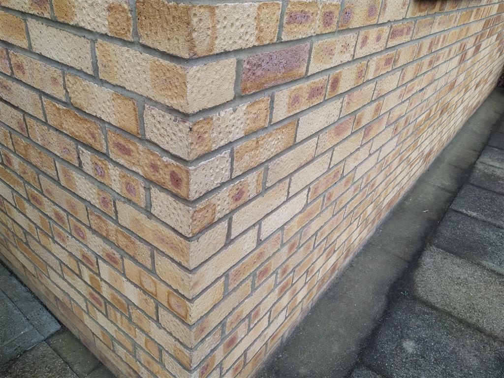

Can we recover anything of whats here, remedial?. Do we need to rebuild, engineering bricks/concrete blocks etc. These were Golden Buff, same as our bungalow bricks none of which have blown (pic attached of them), it looked really nice .. once . Painted it looked nice but we are fighting a losing battle.
Any advice appreciated.

They're London Bricks (LBC). They're known for being useless with frost, the worst possible choice for a garden wall. It was probably done to match the house, they're OK for a house as it will be heated and much drier, but even then they can still pop. They're rubbish.
Some off-the-cuff suggestions...
The real answer would be to replace it with better bricks. Ideally concrete ones, e.g. Marshall or similar. The good news is the foundation must be OK, if there are no signs of movement.
The workaround would be to replace the top with something that has a lip to stop the water running down into the bricks below before freezing and popping them.
It would be a waste of time rendering it as the bricks are falling apart so the render will probably come off.
Dig out behind and refill with 20mm gravel so the water can find its way to the drainage holes you already have.

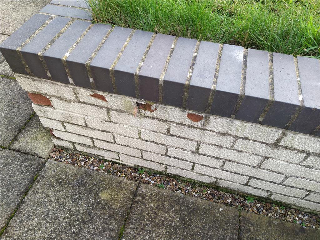

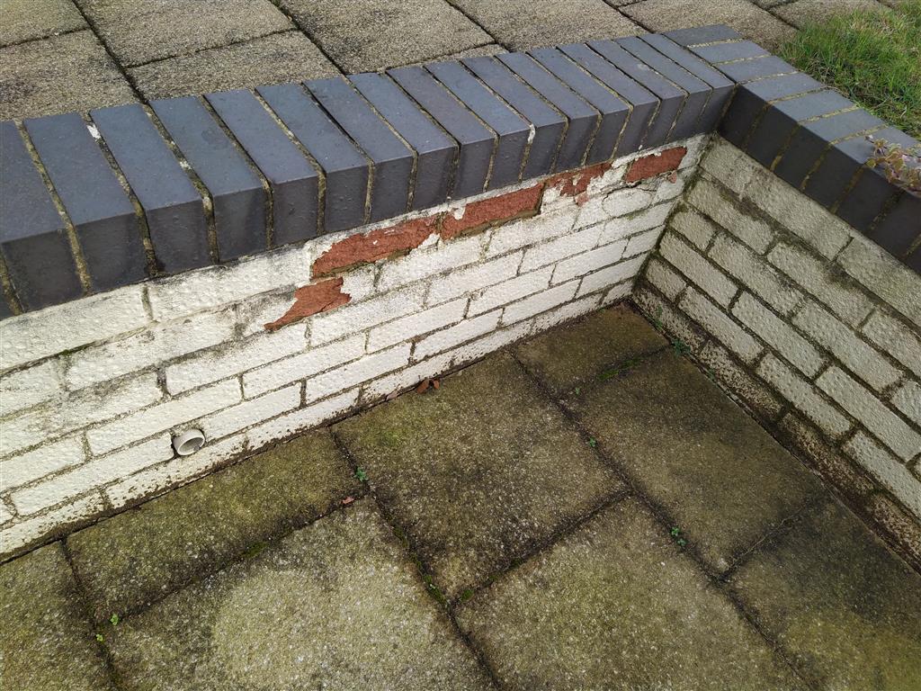

Bit of an update, There was a builder opposite who had a plasterer working with him. They came up with a solution to place a coping brick on the top with a slight overhang and also dig out behind and put in a sheet membrane barrier. Stop/reduce water penetration down and from the back.
For the front face, pressure wash clean it up, bond it, then add a mesh and then plaster it with a silicone plaster mix which is waterproof and doesn't need painting as its coloured.
He echoed the concerns about the brick, more surprise at how quickly they had blown but he observed its mostly the top layer of brick so water is more than likely getting through the top layer.
The membrane down the back is a good idea. I always use bitumen or similar waterproofing paint on the back of a retaining wall, a similar idea. Paint is probably preferable as it soaks right into the bricks and can't get punctured. But it probably won't work on one that's already been buried so is muddy. There will always be a route from the bottom of the membrane up behind it via groundwater pressure, as its bottom edge won't be attached to anything.
Definitely get some gravel behind the membrane too. Ensure there's a path to the drain holes, and that they don't get blocked by the membrane. It may (will) move after being buried.
I'd still be concerned about the render/plaster detaching, it's a risk but only time will tell. The risk-free answer would be rebuilding with decent bricks. It may sound like a more drastic course but in reality your builder's approach is still a lot of work and materials, there may be less difference between facelift and rebuild than you'd think.
