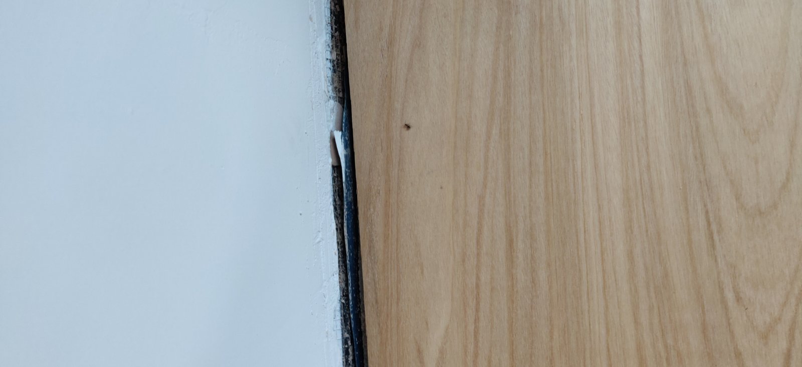

We've had a screed floor poured in our extension. A 0.5mm gap has been left around the perimeter, I presume this is a measure to avoid damp?
Most of the room has skirting boards fitted, but one section where there will eventually be a kitchen (and no skirting board) seems to have a few Ants walking about. Not loads, typically 4 or 5 along the 6m stretch. Been there for a few days now.
Do I ignore this? Ant killer? Some sort of sealant? Bit which doesn't create conditions for damp?
Grateful for any advice!

You could apply decorator's caulk or similar to the gap, having first put down ant powder
That should also deal with the ants, unless they are entering the floor from elsewhere.
There appears to be a membrane under the screed, this is to keep out damp not to ventilate the area so closing the gap should bo ok as long as the adjoining floor - if it is suspended - remains ventilated.
I imagine the gap (surely 0.5 cm not mm) is there after the "shuttering" was removed.

Thank-you. Does it matter what side of the membrane I apply the caulk? Or over both sides? And to be clear, there is no risk in bridging the wall an the floor with the caulk?
If the screed has been properly protected when laid and is allowed to dry out, there shouldn't be a problem. From my perspective as a DIYER modern building methods should mean moisture, if any, transferring from screed to plaster will be either minimal or will dry out.
Remember that the wall should have a dpc with which the floor membrane laps.
But seek professional advice if you are in any doubt
