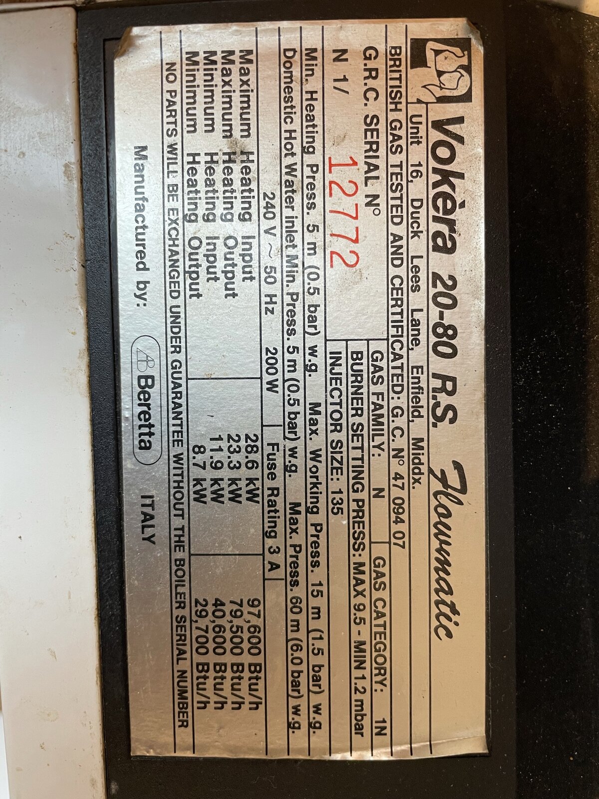

Out of curiosity, am I right thinking that Vokera does not have a modulating burner, too old? So turndown is done by manually adjusting the burner pressure.

No the OP say he has a Vokera Excell, these come in two models, Standing pilot , and electronic ignition, both have modulating gas valves, the max CH output (range rating) can be manually set on the boilers pcb, but yes the answer to your question is yes they do modulate , it is not the burner that modulates (it never is) it is the gas valve that modulates, condensing appliances mainly adjust the fan speed and this in turn modulates the gas valve, on older boilers it is done via a modulating regulator on the gas valve, that is electronically adjusted via the thermistors and boilers PCB
Thanks for that. I hadn't thought modulating boilers were available that far back, but clearly I was wrong.
I appreciate modulation is by adjusting the gas valve, thereby varying the pressure into the burner. On my 22-year old (non-modulating) boiler the burner pressure is adjustable on the gas valve with a screwdriver. On the nameplate posted in #2 the max and min outputs correspond pretty well with the max and min pressures.
yes even with a modulating gas valve you have to set the Max and Min burner pressures on the gas valve, what you have is called a range rated boiler where you set the max pressure on the gas valve, but a combi needs a lot more burner pressure when running HW than when running CH, and that pic in #2 is a Vokera RS Flowmatic, the OP has a Vokera Excell, they are not the same boiler, havent a clue why that pic is there to be honest

... and that pic in #2 is a Vokera RS Flowmatic, the OP has a Vokera Excell, they are not the same boiler, havent a clue why that pic is there to be honest
DP put it in to show that old models can be kept going.
