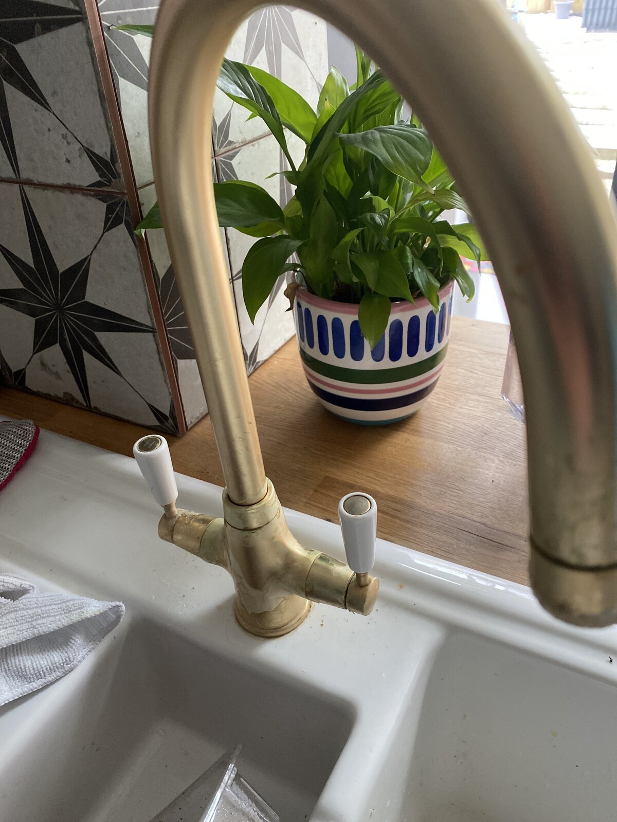

Any idea how to get the cartridge out of this?
17 Apr 2015
3,780
820
Howdens. 4 years old and dripping. Usual ways of opening it up (that I’m aware of) don’t seem to feature…
on the handles there will prob be little allen key screws holding them on
Unscrew the stalk marked H&C and you may find a fixing/screw where it screws in.
cheers guys, didn’t spot a little grub screw on the underside.
