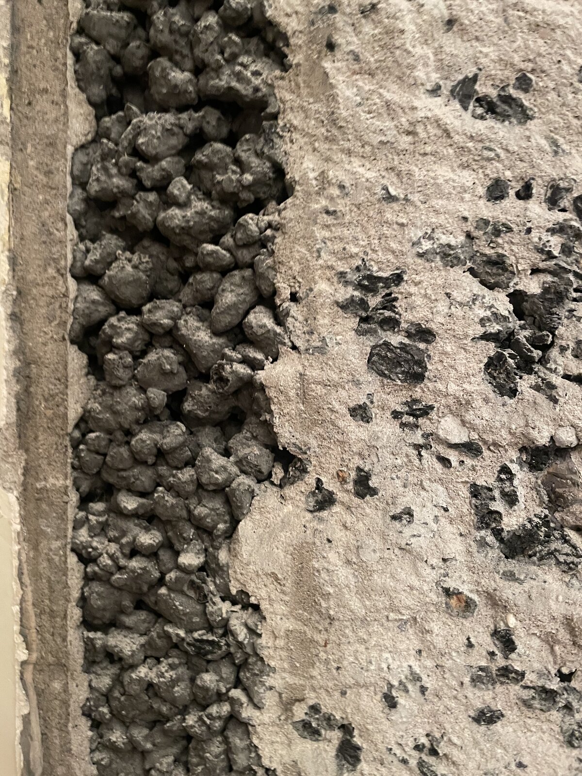

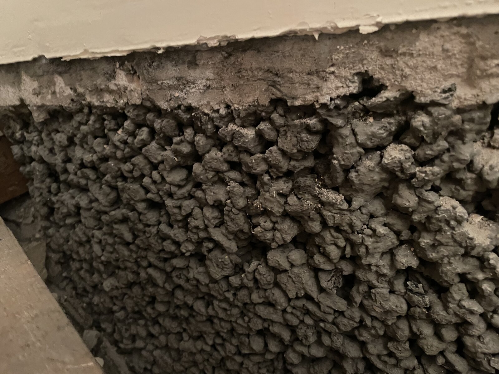

Any idea what type of block this is?
8 Oct 2021
19
Hi, I’m currently internally insulating walls by PIR and plasterboard over the top (aluminium taped and PB staggered joins)
I’ve started to remove the plaster from the brick (house is brick>cavity>block) to gain an inch or so.
Can’t anyone tell me the name of this block type and/or its density? It’s soft as hell!

It’s a mid terrace 1950s ish. I didn't realise what that type of house was, but I had heard of Boswell non-standard construction which was classed as defective… it appears Wimpey isn’t?
Thanks for replies. In terms of internal insulation and as it’s density is very low, would d&d or adhesive foam be better?
As the block is so aerated, I wondered if one would be better than the other for holding power
My 1930s house has these same blocks in places so not necessarily a wimpey house etc. The blocks I have are actually very heavy and very dense.
Thanks, does anyone have any idea how could I determine what build it is and wether it's a wimpey or not? I've contacted Building Control who said they have no idea as their records don't extend beyond 1989.
It has all the hallmarks... no-fines, pebbledash exterior etc but I think I need to be sure.
As the OP's blocks are 'as soft as hell' then you hardly have the same blocks do you?
I did think board adhesive but with it being no-fines, unless I scutch it level till the cows come home I may need the flexability of d&d. I've seen that IWI isn't appropriate for no-fines, but I'm unsure (if I seal/tighten the envelope properly) why this would be the case.
