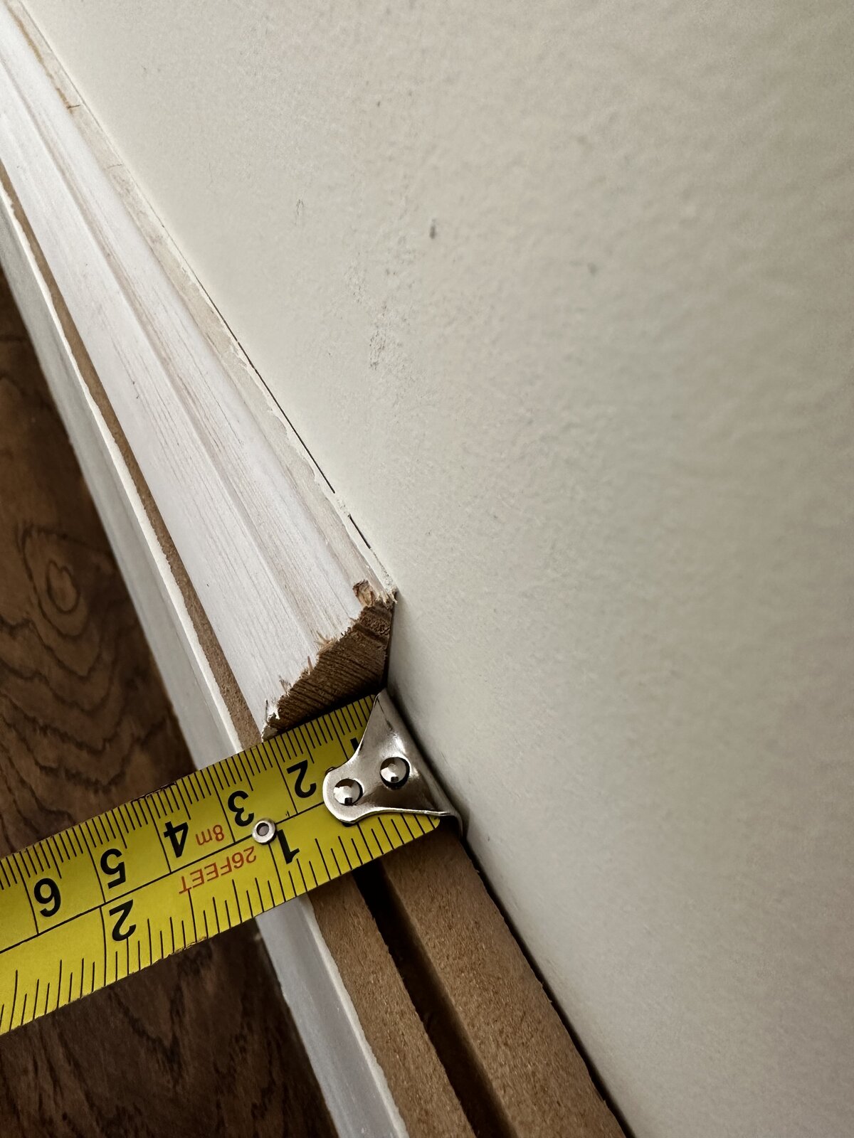

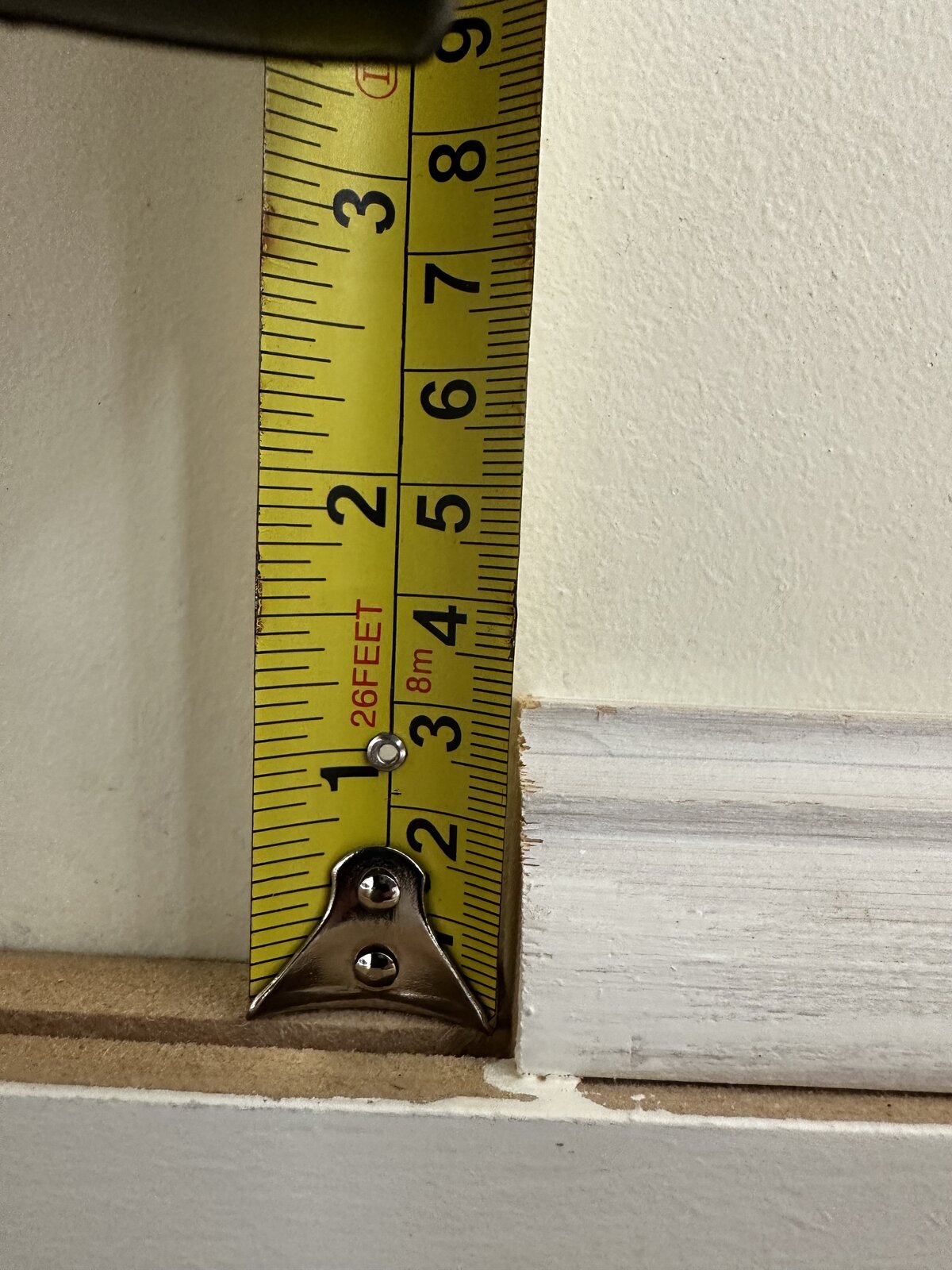

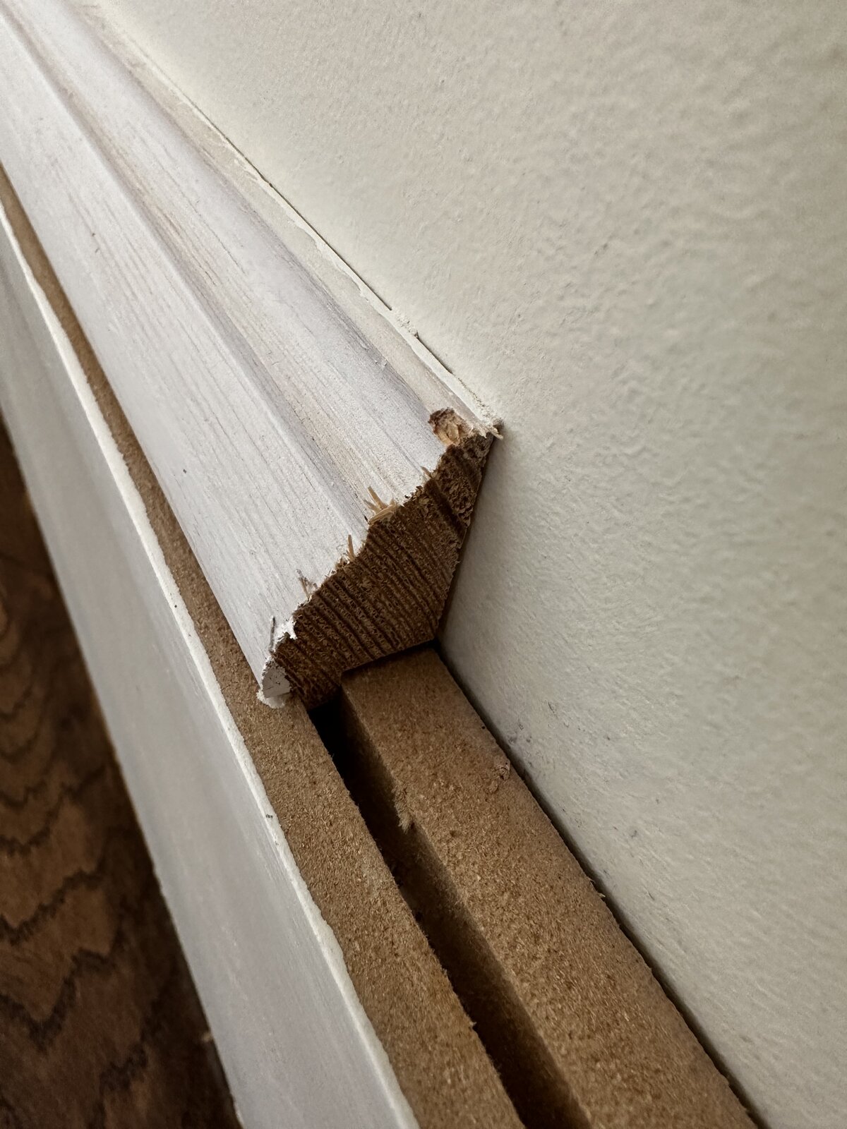

Hello. Any ideas where I could source this kind of topper to the skirting? Have a section missing where a radiator is being removed.

It looks like a common architrave/moulding. Although you will have to basically cut a small slice off and shop around or find a way to trace the profile.
The skirting looks like it’s made up of common parts.
If you cannot find a wood yard with that profile you could …
Take off all the profile in the room and replace with new as close as possible
Find a wood yard /shop to copy the profile. ( this might be expensive)
Remove the profile from a smaller room if it’s the same, fit new to the smaller room.
Or if there is a wardrobe/cupboard, steal it from there.
As above, it might be cheaper to replace the whole lot.
The last time that I asked my local timber yard to replicate some missing picture rail, they warned me that it would cost £300 just to have the spindle moulder cutters made.
As an aside, why are there gaps in the MDF?
My local yard is £40 to set the cutter then X amount per metre to run off.
Cutter is just a allen key and adjust to get the shape I think

The gap in the MDF is where the top part attaches to the base of the top part (it has a small piece at the base that fits the gap)
