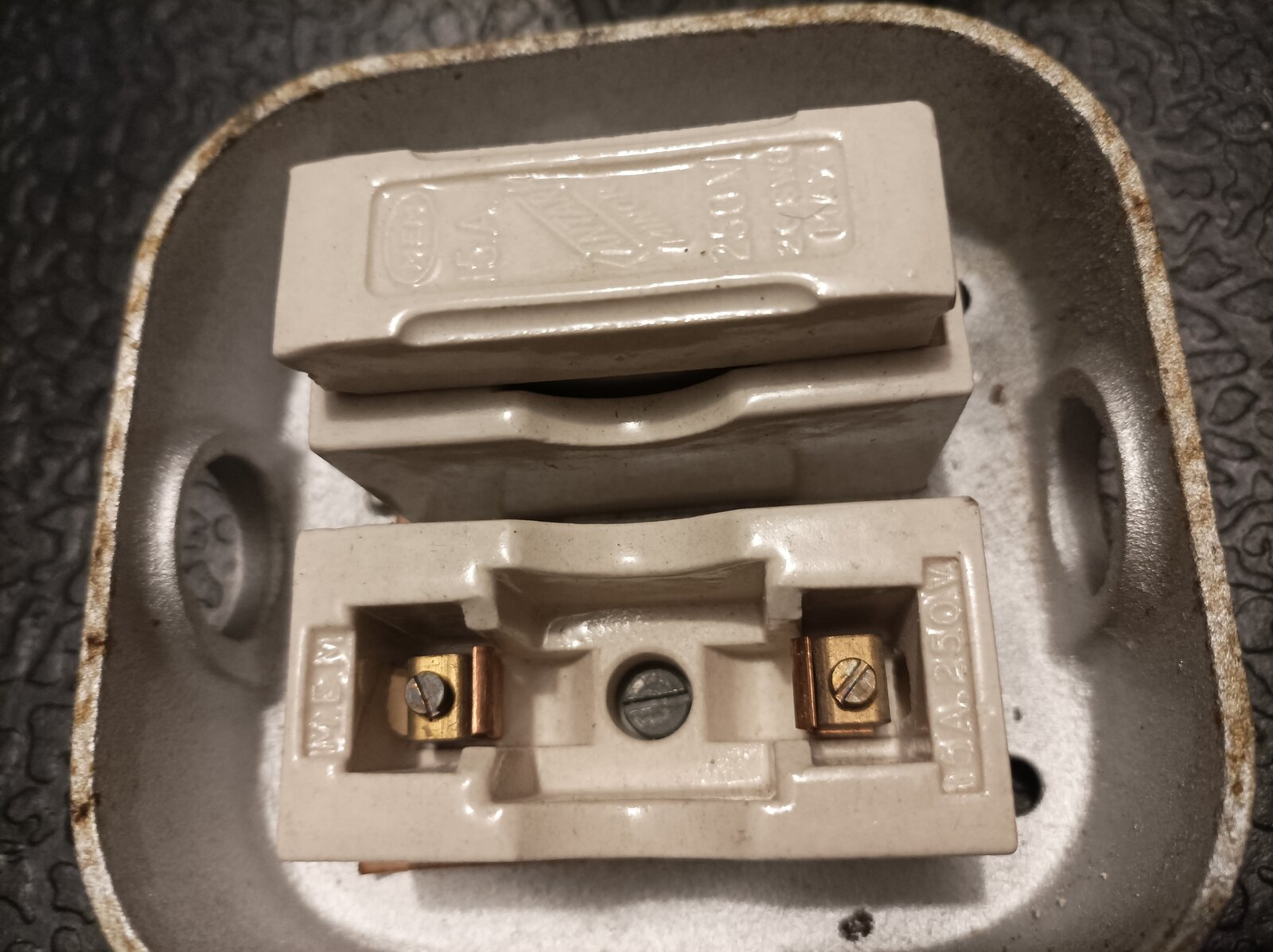

Any information on these vintage items?

Age, use etc?
Both brand new.

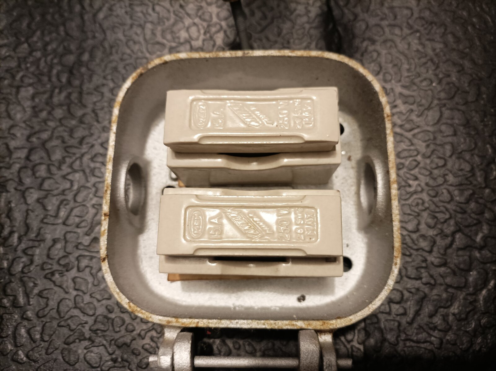

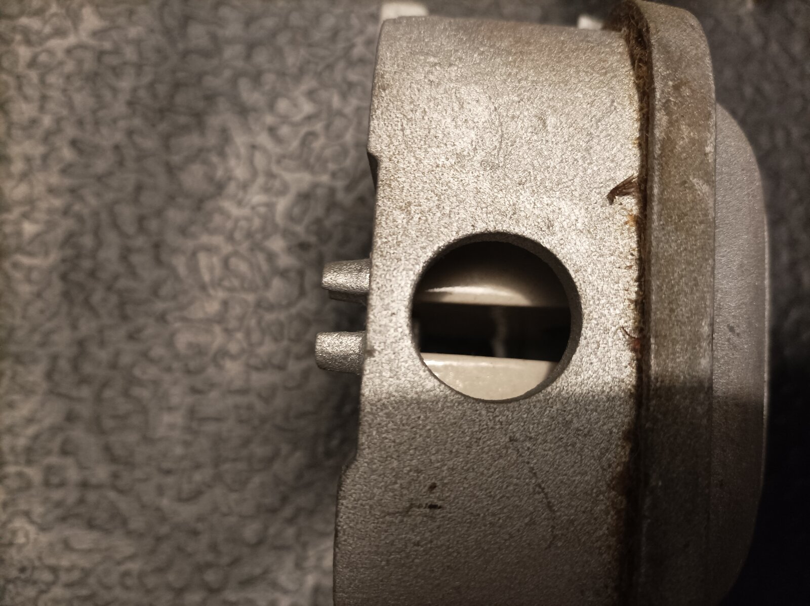

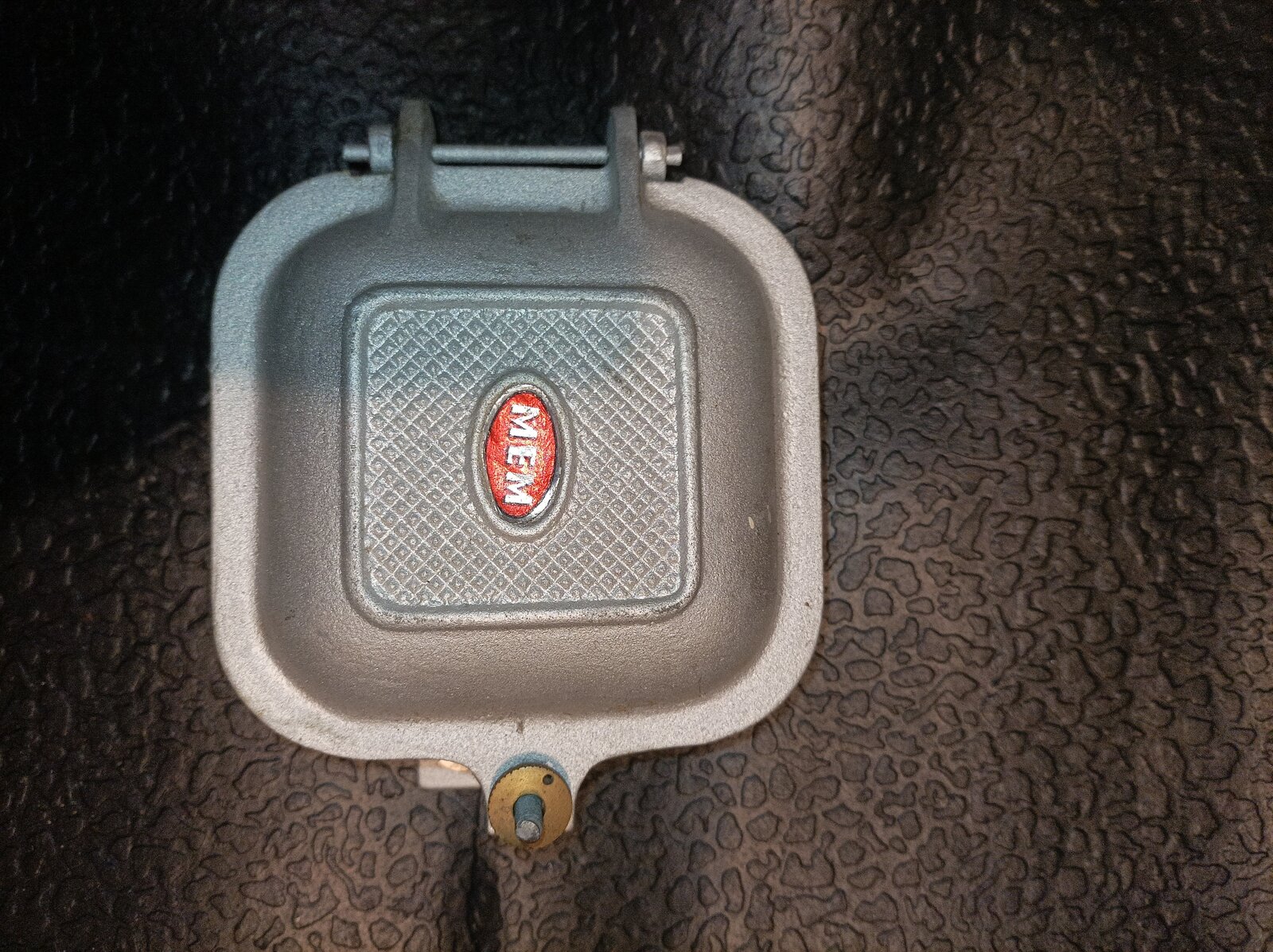

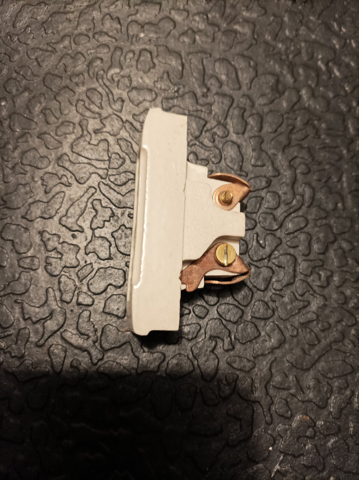

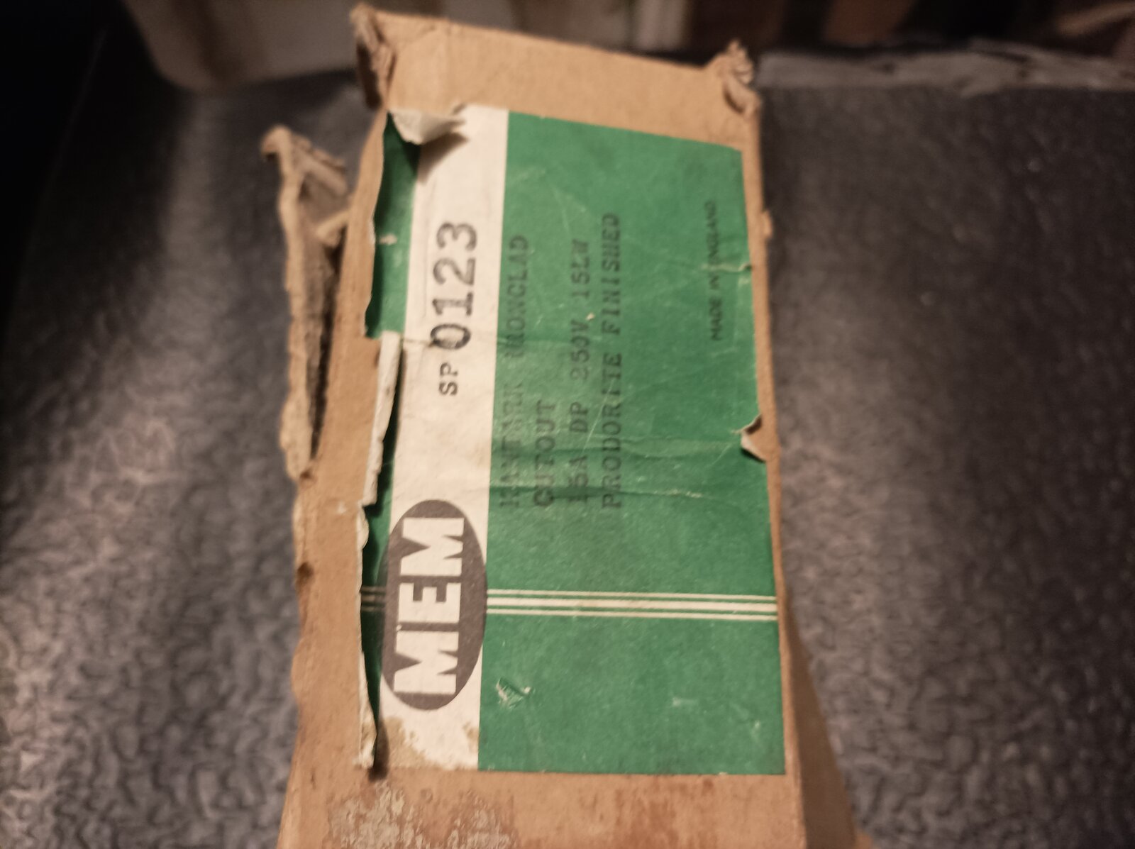

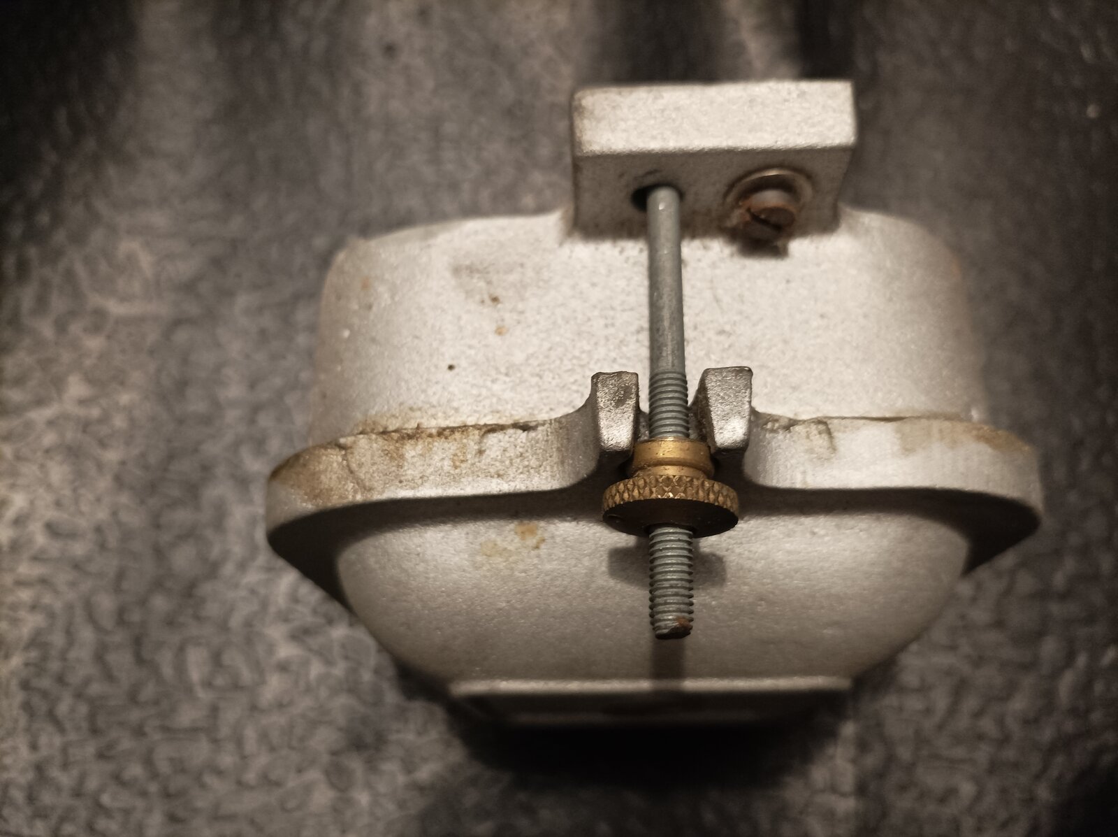

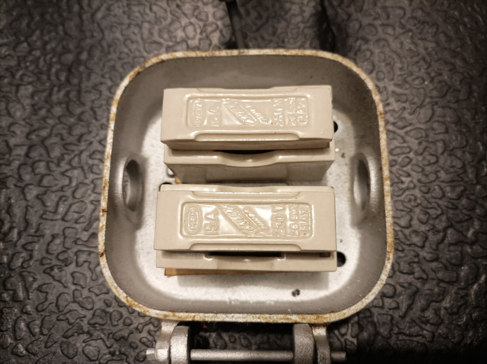

A pair of MEM15amp, wire type fuses, mounted in an cast-iron box, pre-1950's. MEM - Midland Electrical Manufacturing.
Would that be primarily for double pole fusing?
Can't really see what else you could do with it, without effort.
EDIT. Whoops, it says DP on the box, so...
Made when stuff was made to last.
Put it back on the shelf and it will outlive you, your children, grandchildren and their grandchildren.
No use today.
I gathered they'd be no use Today, but yes, just going by the weight, you can tell they were built to last.
I was thinking, could they be Service Fuse Cutouts? Although only 15 Amp, perhaps at a time when electricity was used only for lighting (5 Amp)?
No, I don't remember a time, when rewirable fuses were ever used, besides which, there is no ways to seal them.
And rated at 15 amp.
I envisaged this would be used for adding a new circuit such as an immersion, or a 15 amp socket, or lights - where the existing fuse box would be full.
I don't think a double pole switch was considered important.
I think even as recent as the early 60s, a fuse carrier as shown in the picture, marked say 15 amp, would happily have say 5 amp fuse wire put into it by the electrician.
Also, tails coming out of the ISCO block to a new additional fuse box would often be as small as it possibly could be.
Film/TV props company might be interested?
I guess only useful when needed for a close up
Rewirable cutout fuses were not a lot different to those ceramic units and I've always regretted losing a cast iron unit during clearing up after a job, my first house had something similar,
(courtesy of JW YT) which I was given permission to do temporaries prior to timber and damp treatment while renovating.
