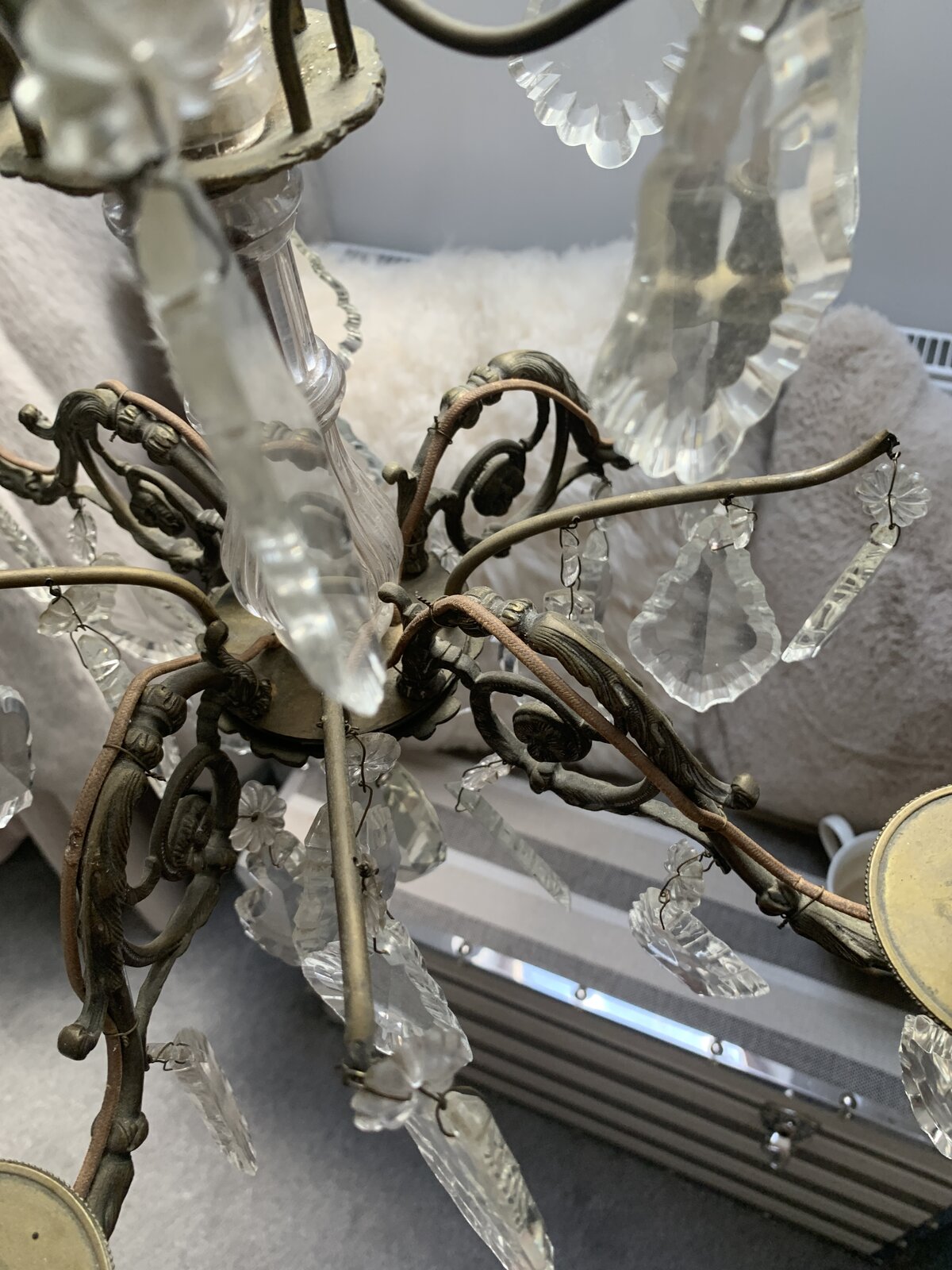

Hi All, I’m happy to install light fittings and fixtures but my wife has recently set her heart on a vintage French chandelier from an antique shop.
I took a look and it’s clearly pretty old with no earth and just 2 wires that are the same colour. We live in a 5yr old house so with fully up to date electrics etc. I’m a little concerned about what happens if anything goes wrong with the light? What’s the worst that can happen? Is there any chance of a fire? Will things just trip? With no earth is there a risk of electrocution (mainly metal light fitting)? Or, does the benefit of modern electrics protect us from all of these fears??

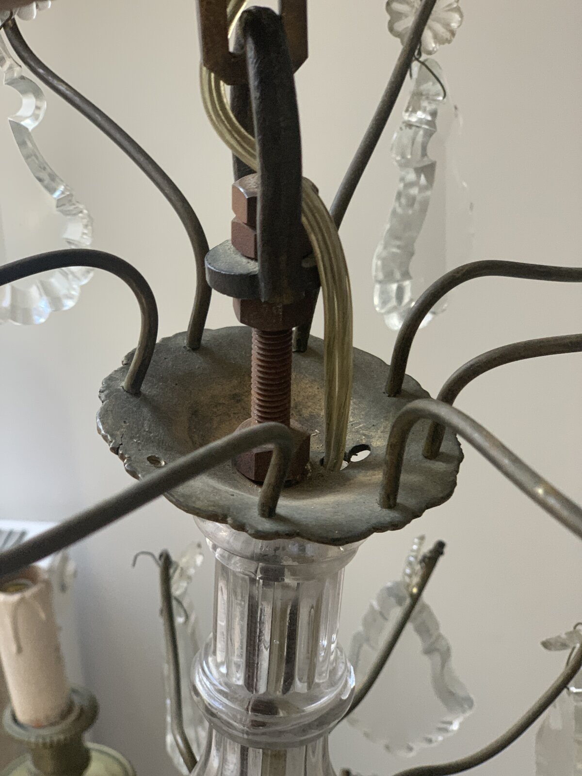

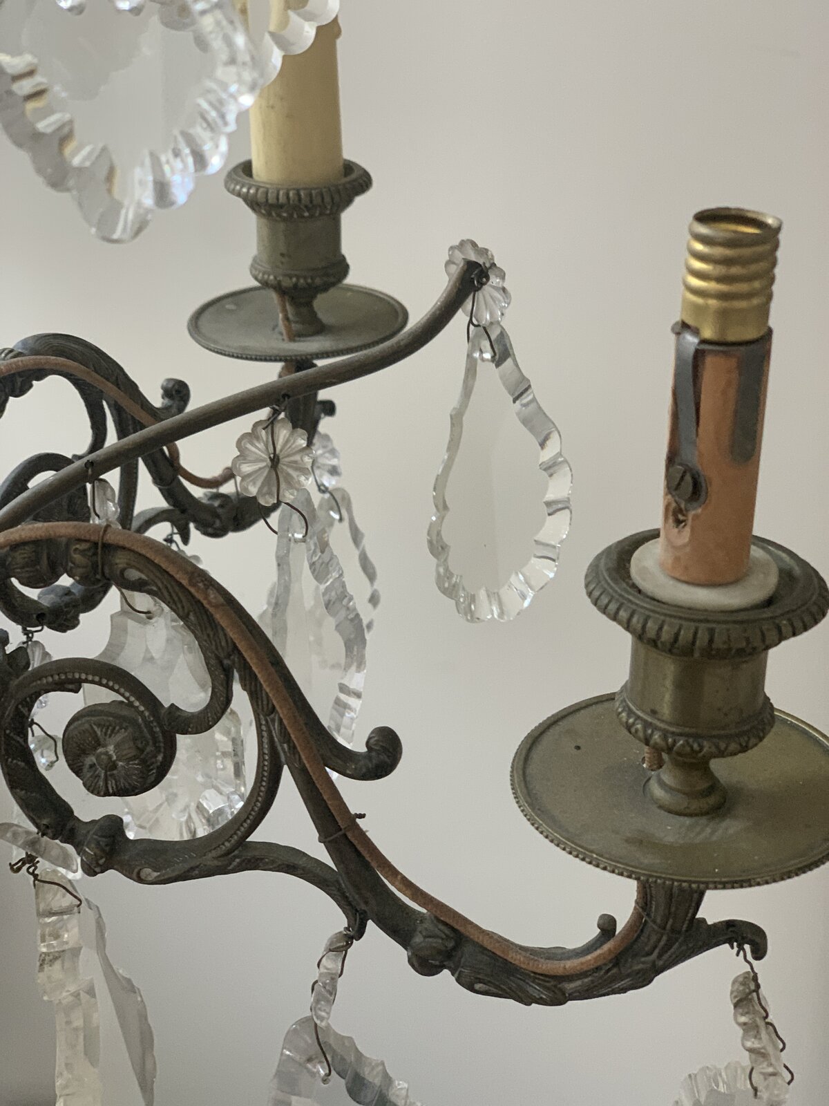

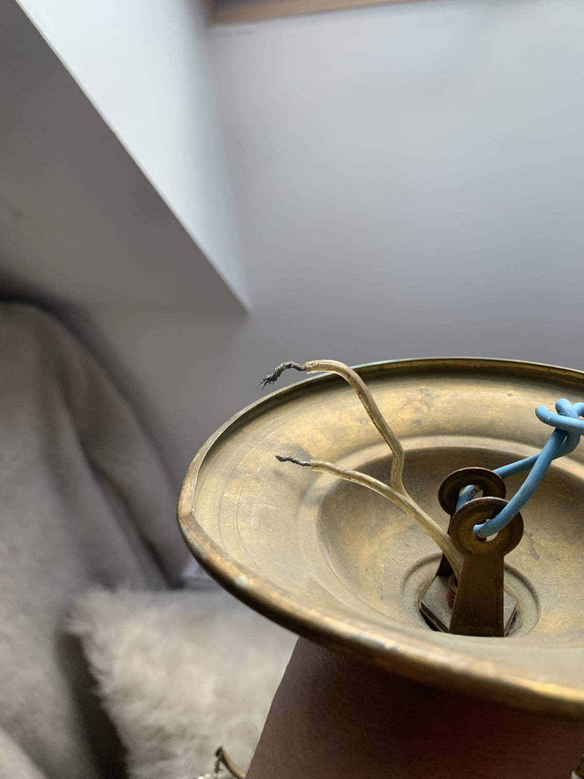

Thanks for the help. A few pics as requested….

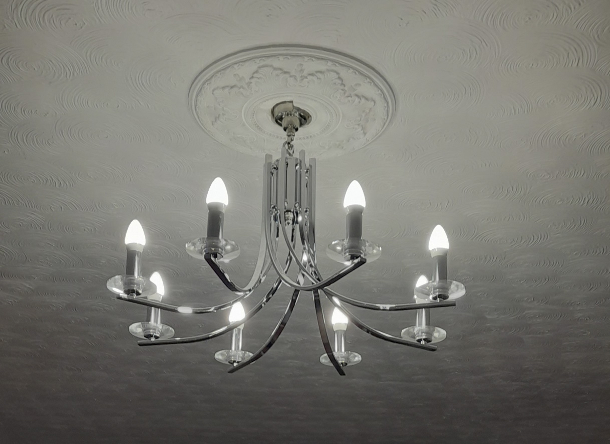

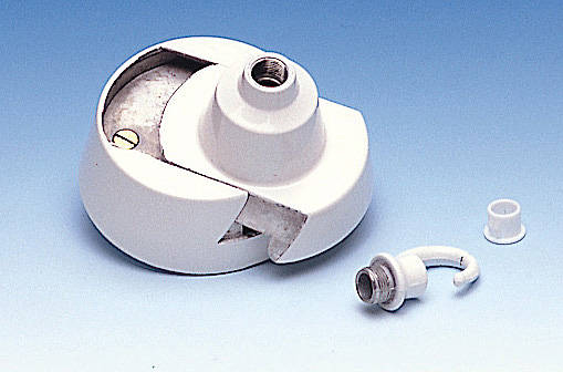

At 70 plus holding a chandelier while wiring it up, is for me a non starter, so I use plug in ceiling roses, expensive, but once fitted easy to fit what ever light fitting I want. Ceiling rose.jpg 20220415_000328_1.jpg As long as switched off before you change a bulb there is very little chance of a shock, but since the ceiling rose I used is metal and earthed, and the chain link connects it to the chandelier, I would be very unlucky for the RCBO not to trip with an earth fault before I touched the chandelier.
I am not saying one should rely on a chain link making a good earth connection, one clearly should not, but you I am sure can assess the risk, and decide if worth it.
That needs a complete rewire and new lampholders. Cotton braided flex puts it well over 60 years old.
The plastic twin flex at the top is probably a later addition, joined to the cotton flex inside the base section as that was easier to do than replacing the whole lot.
I agree with Flameport. Total re-wire essential. May be necessary to covert to ELV ( Extra Low Voltage ) using 12 volt lamps and a transformer.
