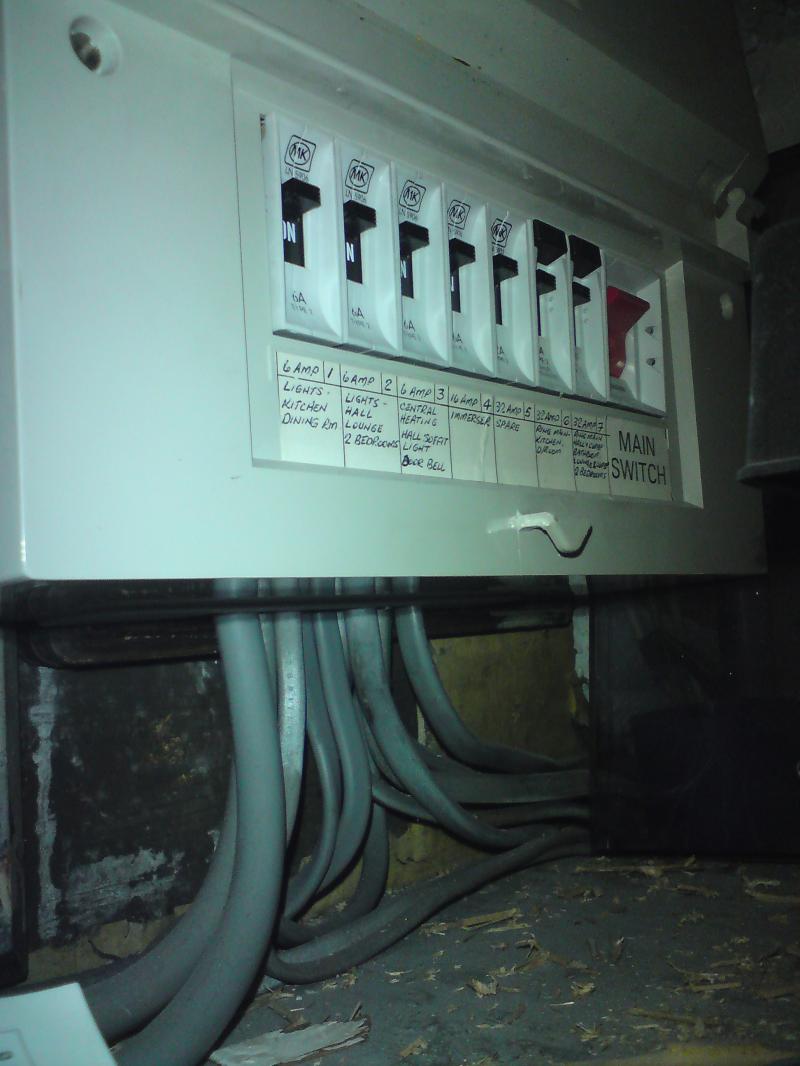

Thank you to everyone for all the useful replies.
I've attached a photo of the ceiling rose showing the old wiring; and also of the earth leakage, which only has modern wiring coming out of it...
Also just to clarify, i've not changed the light fitting yet, the chandelier was installed by the previous owner(s), I've only got as far as opening it up.

Morty - you need to investigate the wiring to that light fitting more closely - there will almost certainly be an earth wire there somewhere, it's not unusual for people to tuck it out of the way if they're fitting a light which doesn't need an earth. Check the switches and other lights to see if one is present.
That doesn't look like modern sleeving to me.
And a single red (switch) and 2 neutrals looped in would be typical old conduit wiring.
I wonder for how long the modern wiring continues away from the new CU?
:evil:
The wiring looks like it is VRI Vulcanised Rubber Insulated cable. Being organic, this is beyond it's sell by date and it crumbles when overheated (at terminations). Even though an insulation test is satisfactory, the wiring can't be inspected along it's length for signs of degradation.
There was no requirement around the time this type of cable conformed (1960's?), for an earth (CPC), to be provided for lighting circuits. Class I fittings and accessories are not permitted where there is no earth bond, class II are.
