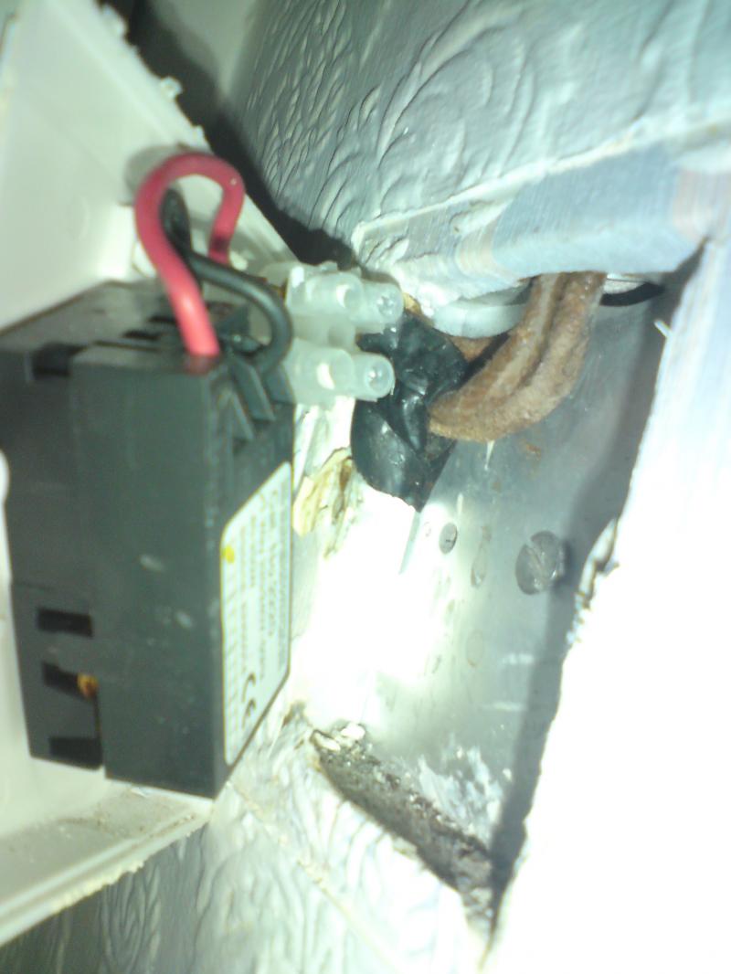

I've checked all my wall sockets, they have the same modern wiring as that coming out the trip board. However, the light switches are once again the old wiring.
More worrying for me, the previous owner installed dimmer switches on these lights (which have metal turn dials to switch on/off), as shown in the photo below :-
I prodded around the ceiling rose but could not find an earth wire tucked away anywhere, so have to assume it just doesn't exist.
So I guess its time to get the lighting rewired.
Just like the cables from the CU could be joined to old wiring shortly after leaving, so could the cables from the sockets, you need to get it all properly checked out.
They look like plastic switches with no earth terminal. If so then they don't need earthing.
Or possibly the whole lot, depending on what the inspection uncovers.

Lots of older properties have conduits installed into the wall, you may be lucky and could pull the new cables through, minimising disruption to the walls.
You can check this by (safely) removing switches and looking for a tube around the cables.
