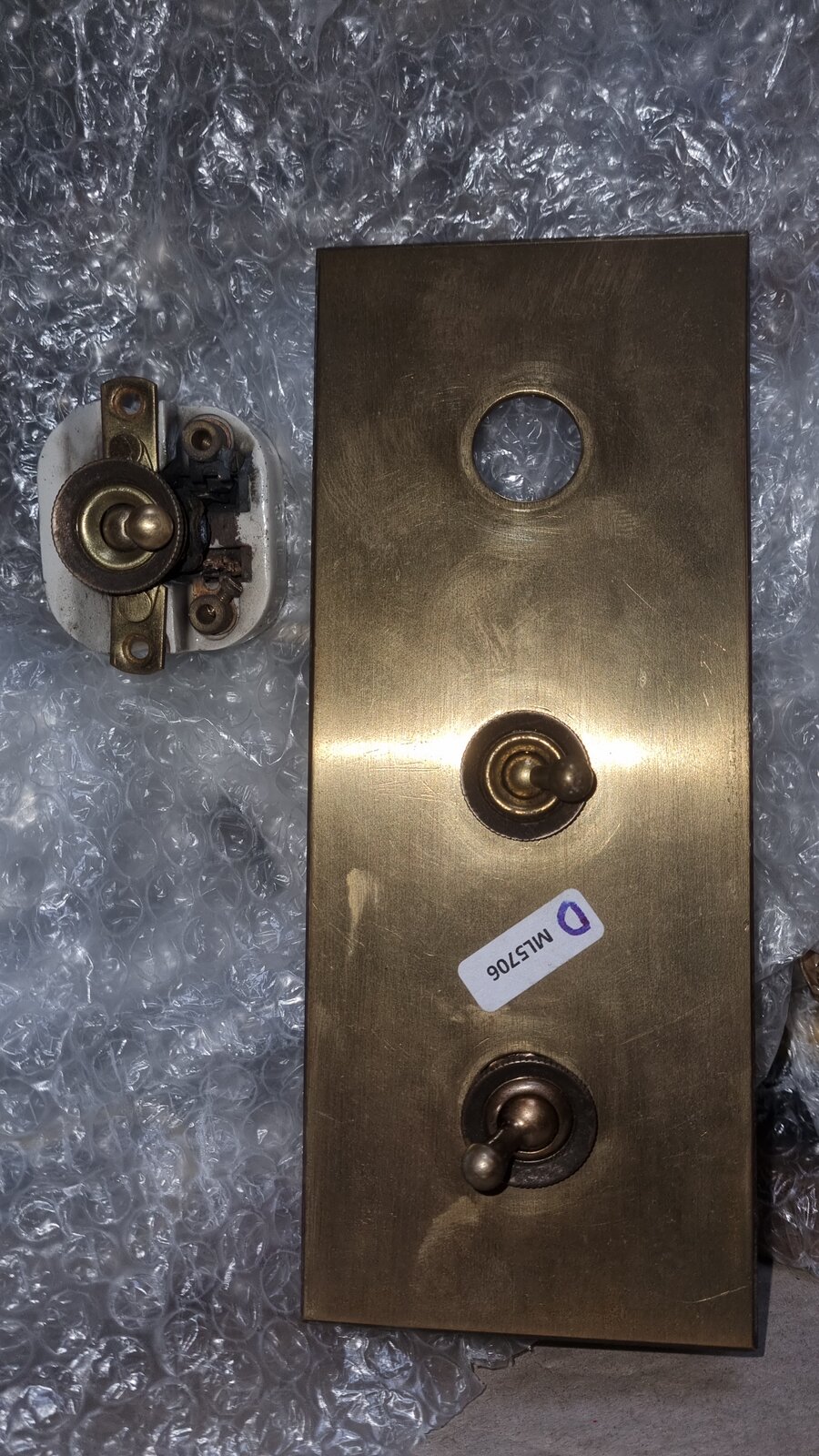

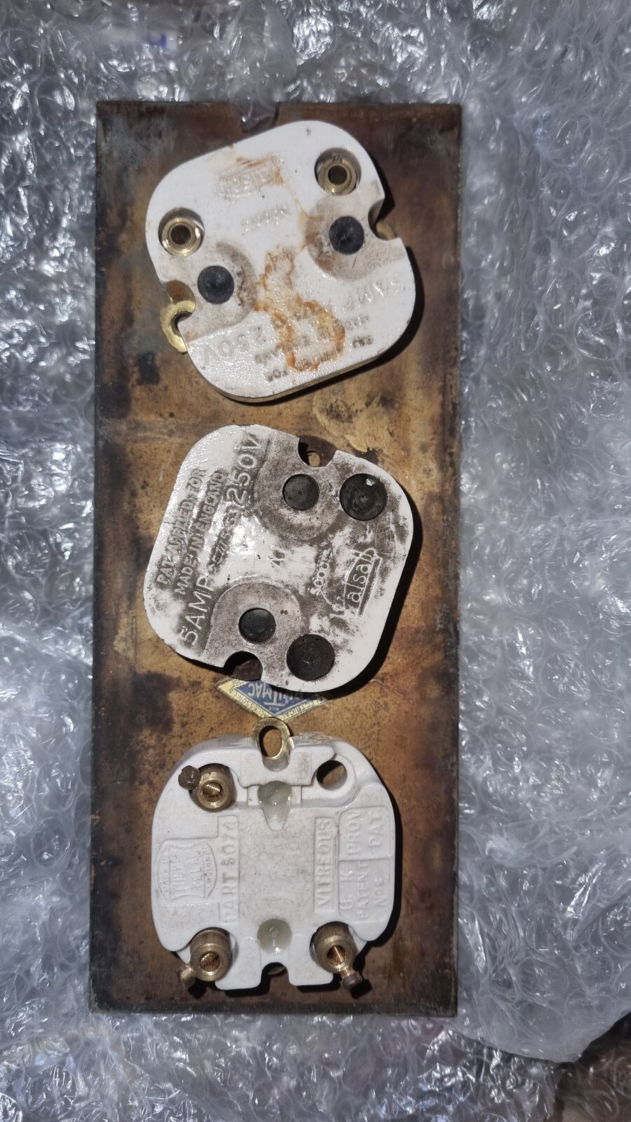

So I have a load of lovely old brass mains light switches (pictured is one of the plain ones, some of the others are much more special) that I would like to use to give my Victorian house a slightly more appropriate period look than the awful 80s white plastic installed by a previous owner. Problem is (I'm told) the lack of earthing on the switch units - is anyone aware of any safe modern replacements that are available to attach to the brass plates in the same way pls? Obviously the actual switch part of the unit would need to be brass/brass-coloured too.
Are you saying there is no earth available at the switches? If you have, perhaps you could adapt what you have, to add earth terminals, such as soldering a brass bolt head, to the brass plate, to form an earth terminal?
It almost seems too easy/obvious a solution to be what I need... I have actually just found this post on a similar topic - https://www.diynot.com/diy/threads/vintage-light-switch-reused.12310/post-67843 - so will investigate both solutions later this week, thanks :)

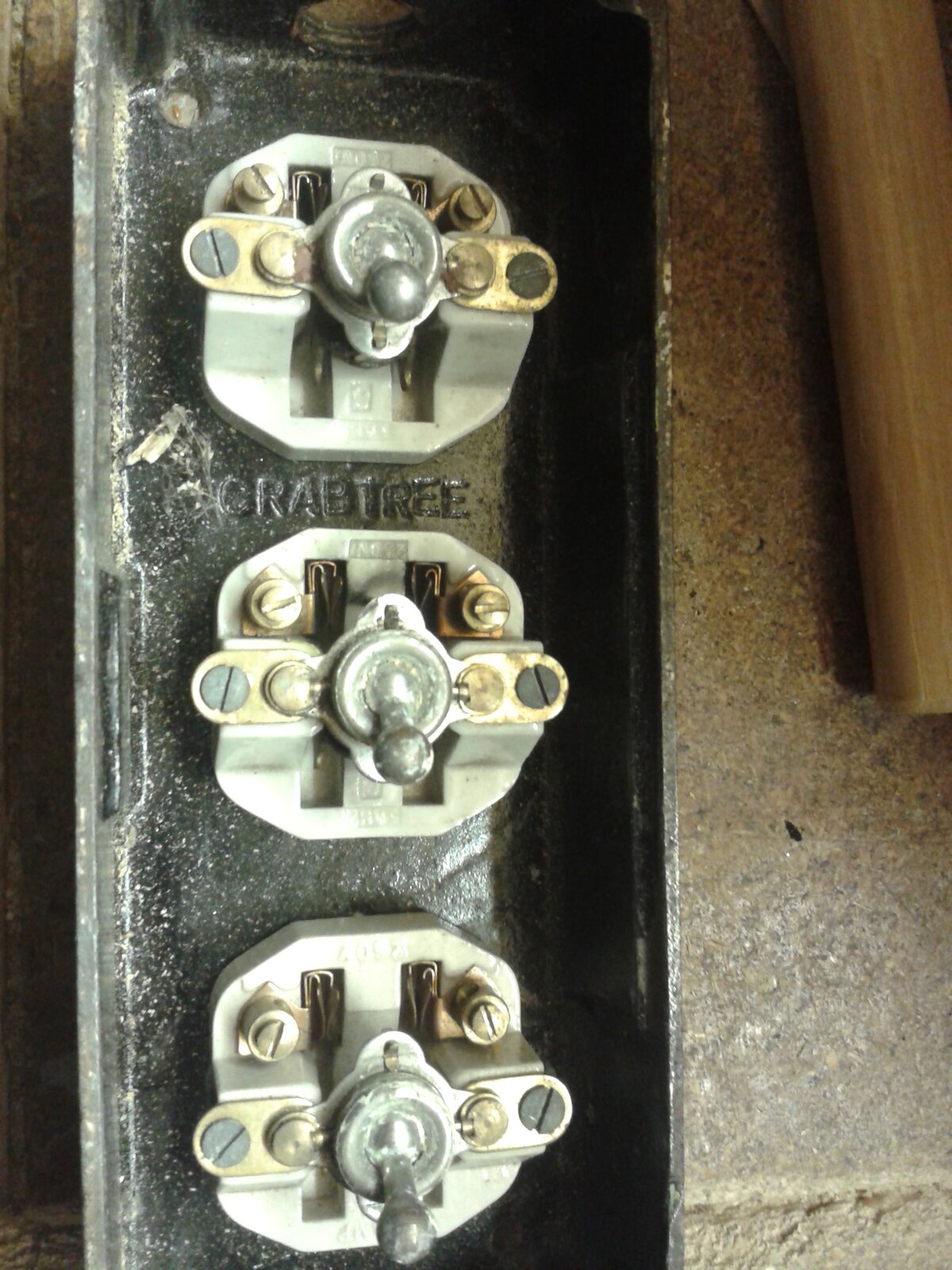

Hopefully you can see in the picture the switches are screwed to the back of the box.
Then the brass plate is held in place by the lockrings.
That's not to say all sortsof "alternative arrangements" have been created over the years (50 years ago I used some mounted on a hardboard panel in the way your pic shows for my trainset)
The pic I used came from https://www.diynot.com/diy/threads/using-old-crabtree-dolly-light-switches-ed.628850/
The only times I have come across those lovely old Crabtree ceramic switches with the cast boxes, they were wired in conduit connected back to a cast board, so solidly earthed.
But I guess the boxes could have an earth terminal retro-fitted. As to attaching one to the plate, that's not going to be easy.
But, as Sunray says, the plate will be earthed when attached to the switch modules with the threaded ring.
