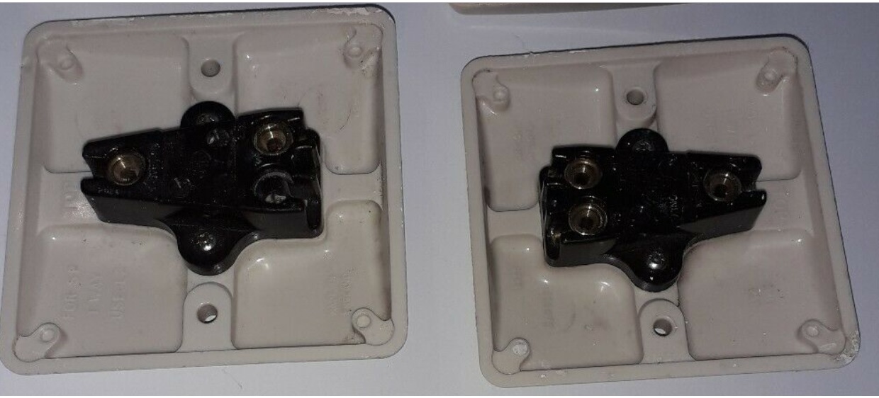

The photo shows the inside of two vintage MK light switches. Is the one on the left (switch 1) a one-way switch and the one on the right (switch 2) a two-way?
If this is correct, does this mean if one of the brass points in switch 2 was removed and transplanted into switch 1 at the point where there is none, switch 1 would then become a 2-way switch?
Yes to the first question. No to the second as you also need the internal contacts.
In some case it is Yes to the second question.

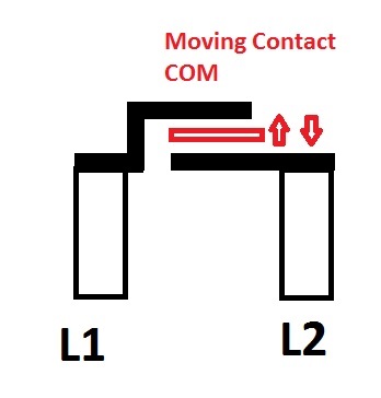

It depends if the terminal and the switch contact are assembled into a single item. If they are and the moving contact has contact pads on both sides then what you propose could be possible.
The bigger question is :--- Why do you want to make the one way switch into a two way switch and the two way switch into a one way switch.
I only want to make a 1-way switch into a 2-way switch. I have two 1-way switches, but not a 2-way switch which is what I require.

Them old ivory ones came with a few different toggles over the years, a picture of the front may help.
What about the right-hand one in the photo you posted - do you not 'have' that one?

Very true (albeit it's possible that he already has one, and is needing the second), but he appeared to be saying that he didn't have a 2-way switch, despite the photo. I therefore wondered whether it was perhaps a photo of someone else's 2-way switch and that he, himself, did not 'have' it.

Whats confused me, is you seemed to say you want to take the lug out of that Two way, to make the other One way into a Two way, is that Two way in the pic no good for some reason
