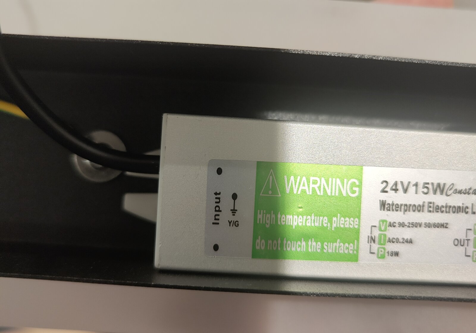

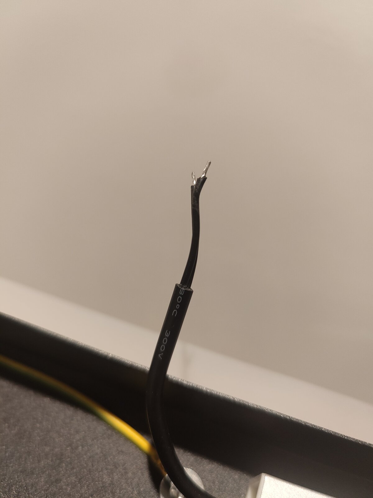

Anybody know how to wire this wall sconce?
20 Feb 2020
400
12
I bought this off Amazon but it has no wiring instructions and the wires are not marked for neutral or live.
Any ideas?

The black cable is 230 volts live and neutral in. It doesnt matter which way round they go.
Also I can see what looks like an earth wire in the second picture? If so, that needs connecting to earth.
Great, thank you. I will connect up the earth too.
