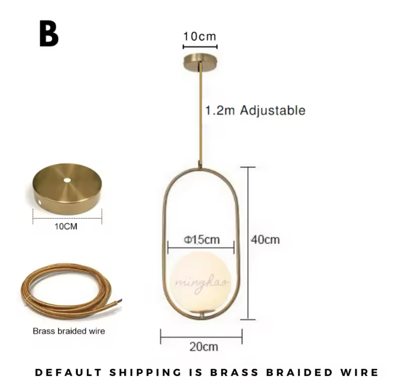

Hello all!
I’m hoping to get some assistance/directions with this.
I live in a new built flat, so the wiring is pretty recent - if relevant.
I have bought 2 sets pendant light sconces (hanging from the ceiling) and I’m stuck as to where to get power from. (One for the sides of the bed and the others for either side of the sofa).
I cannot use the main light as obviously I’d like to light the sconces independently from the main light but I guess I could take connection from a nearby socket for light 1 and then daisy chain to light 2 (I’m ok with both being controlled with one switch as seems easiest solution).
Would I use 2.5 or 1.5 T&E for this?
The second part where I’m unsure as to how to proceed is the switch? What’s the easiest way to have one? - I’d be ok with something techy like a kinetic type switch or whatever too.
Walls are plasterboard and steel studs, so at least that’s good..
Thank you all.
The conventional way is to take a spur from the supply in the existing ceiling rose to a new rose and wire via the switch to one of the new lights and connect the second to the first. Sometimes the switch is used as the junction box instead of the ceiling rose. Others will argue for the simplicity of wireless switching but conventional physical cable has got to be more reliable in the long run.
A new house may only have supply at the light switch. Need to open and check.

You could use an FCU as the switch. 2.5 T&E from the socket to the FCU, 3 A fuse, 1 mm T&E to the lights.

Have you considered, simply wiring this up with flexible cable, either run from a plug, or from the centre ceiling light, if it includes a permanent live? You could simply drape the flexes, and light fitting from hooks on the ceiling, which is quite fashionable, and control them via smart switches. If/when you move, you can easily remove it and little damage to repair.
I was going to say earlier you could get away with using 1.5mm as a light won’t overload the circuit.
Ideally you want an fcu near the socket or at arm level. Then a kinetic switch receiver if the location isn’t good.
You can have multiple receivers to one switch by the door
Ideally get a twin back box (2 singles)
1 fcu 1 for receiver and blank on the front.
Bit ugly. Would be better to put receive in uplighter bottom if it will fit
