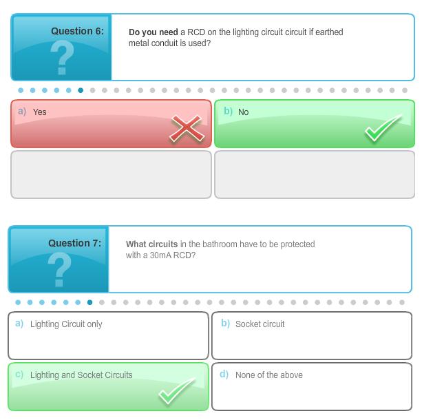

http://www.schneider-electric.co.uk/electricity.nsf/17th-edition/take-the-test

Those answers are correct.see 522.6.7
