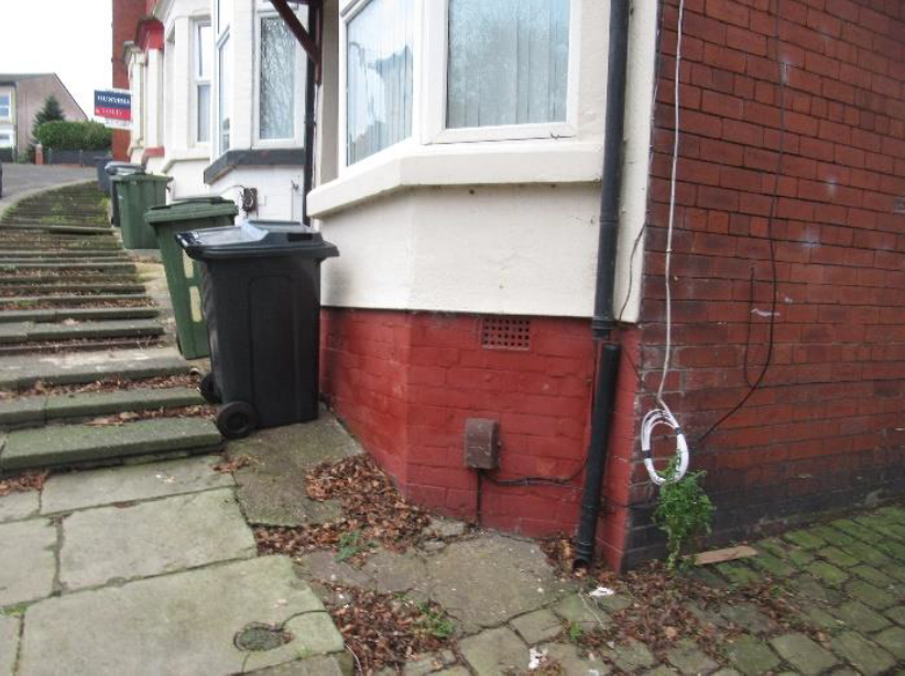

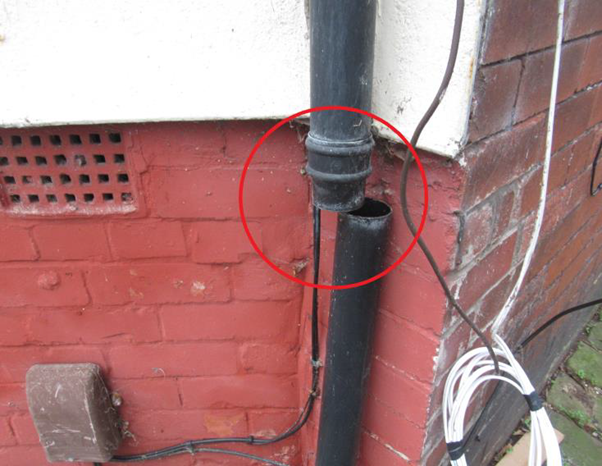

is Contractor A going to mend the downpipe? If water is running down the wall it will be a constant source of damp.
If it's plastic it might be a trivial job he didn't bother mentioning
but if cast iron there may be cracks, bad joints, rusted supports.
while he has the scaffold up will be the best time
Thanks for all your help so far - really appreciate it. JohnD - not sure what these tiles are? I will ask contractor A about the downpipe, although the property is on hill so not sure the water would affect the property, but it would look neater anyway.

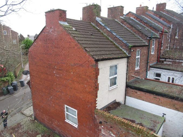

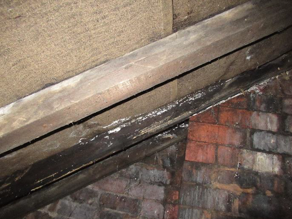

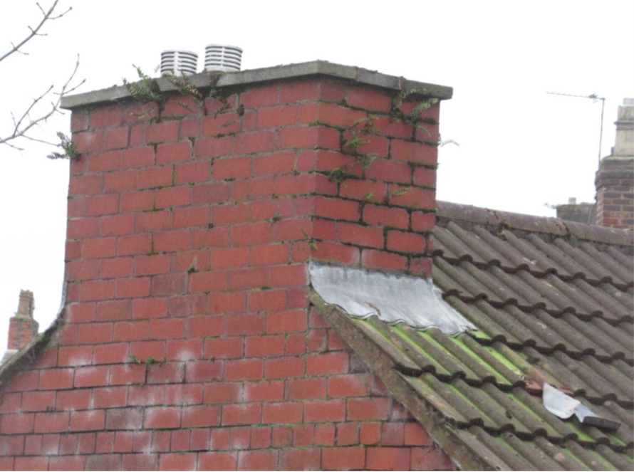

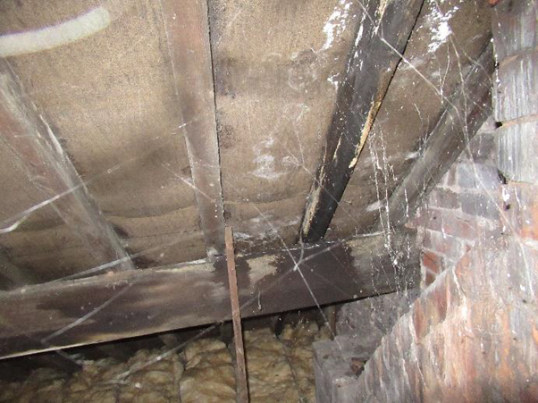

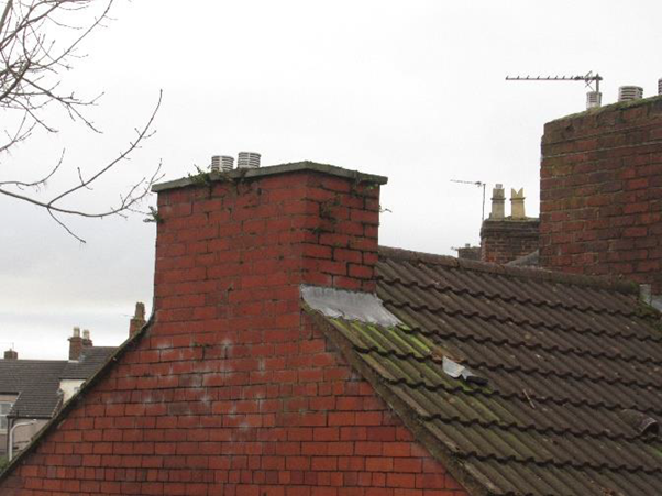

Here are some images.
And the tiles you have are concrete, it looks like the whole terrace was reroofed many years ago.

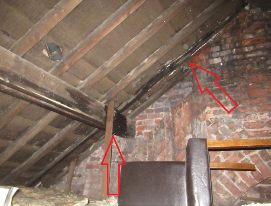

The quality of the original brickwork when the house was built looks very good, but neglect and water damage are bad. The lead flashing round the chimney is very bad. The bricks beneath the blocked gutter on the front of the house look damaged, though I can't see it clearly. I don't see a soil pipe or waste pipe so I guess it does not have an upstairs bathroom. Prod the roof timbers with a flat ended screwdriver to see how bad the rot is. Don't use anything round or pointed as the marks will look like woodworm.

1. Being easily movable a 6 x 4 tower will work best for access at the gable & the front

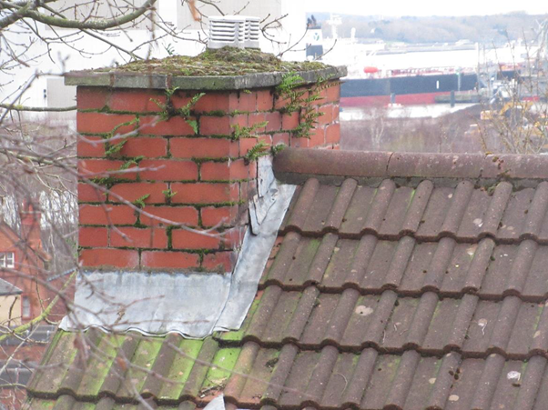

2. No need to drop the chimney stack - the flashing & the stack capping are the causes of water penetration.
3. All the flashing needs removing and re-installed with one-piece step and cover flashing that covers another 150mm over the next tile profile.
Is that a loose piece of step flashing further down the roof not far from a roof vent?
4. The capping needs removing and a correctly detailed flaunching with clay pots & cowls should be installed.
5. All flues need sweeping. This is essential.
6. The stack needs to be raked out (using a thin grinder blade) to 25mm deep, & pointed (the whole gable probably needs re-pointing?).
7. Such thin beds & perps might need Mastic Sand pointing.
8. The bay CI down pipe can easily be repaired.

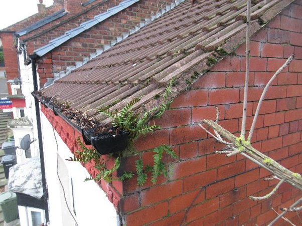

The main roof gutter is semi-blocked.

9. The rotten rafters in the loft can be cut out one at a time.
10. Treat the area with fungicide, & replace the rafters if necessary.

FWIW: Only one air brick can be seen & it looks to be too high - you need air bricks every 1.5m. All A/B's to be below suspended floor level.
Someone needs to go into the crawl space & examine all joists for rot?
What a wonderful terrace that is - hopefully, it can retain its original features.
AAMOF, all the stacks in view need work - a good job for a good roofer who can do leadwork & pointing.
A wonderful terrace where the end stack, the blonde lady's house , is already lower than the rest - option A get it gone (y) probably cheaper than new lead - IF you can find someone competent to do leadwork. And they'd want to do it over the ridge tile.

Oh ree if only you were local. What a comprehensive answer! I think it is a loose piece of flashing. I have had gutter guards fitted so there should be no blocking but I will check. No manhole on the cobbled area.

If the stack is taken away and roofed over, you have no more need to repair that part, or renew the lead flashing, now or in the future,
Full gutter likely to be cause of much of the wet roof. Yours is very full .
But not the cause of the damp above gutter level, or the rotting roof timbers, or the broken downpipe.
