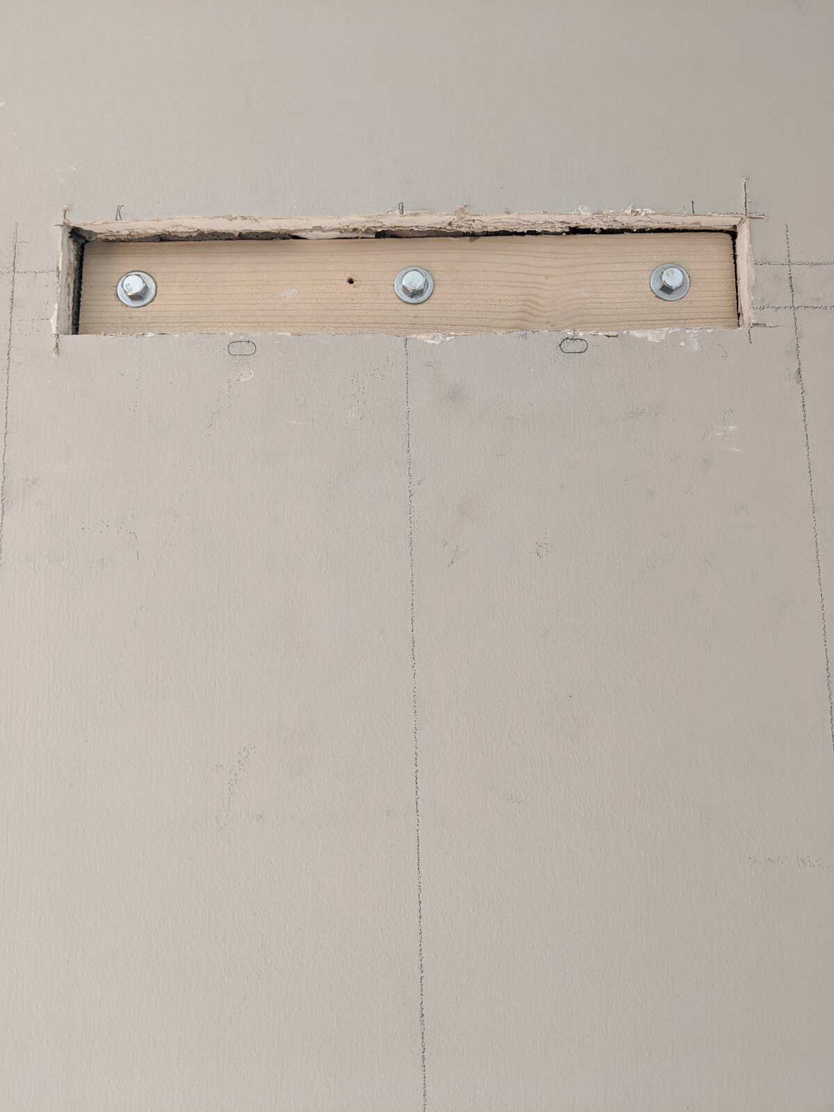

I actually found the corefix screws really hard to work with. I drilled 10mm holes with the correct masonry bit but in 4 out of 5 attempts, the rawl plug wouldnt bite and the screws ended up spinning freely. I can accept one attempt going wrong but not four. I'm at a loss as to why it's not biting into the block work? :confused:

rawlplugs rarely do the job when a plasterboard is bonded to the wall and hollow behind. the weight of the rad will force the bracket diagonally into the board. that’s why i use sleeve anchors.
the sleeve stops flush with the board stopping the bracket pulling in whatever happens.
After trying again with the corefix plugs and a smaller 8mm drill, I've totally given up and instead will put wooden battens in and cover with plasterboard. I'm planning to attach the batten with sleeve anchors and then screwdown the plasterboard and finally use a strong timber screw for the brackets

In the end this is how I resolved the issue.
I attached a batten cut from some C24 4x2 that I had and secured it using 3 85mm/M6 Rawlbolts. I had to upsize the washer as the ones supplied with the bolts barely cover the 12mm opening. I have a 15mm recess left, which I will refill with 12.5mm plasterboard and a 2.5mm skim of easi-fill. The radiator brackets will then screw into the timber batten. I haven't carried out any scientific load testing but the batten is solid as a rock now.
I hope anyone reading this in the future finds this method useful in case they have the same issue.
