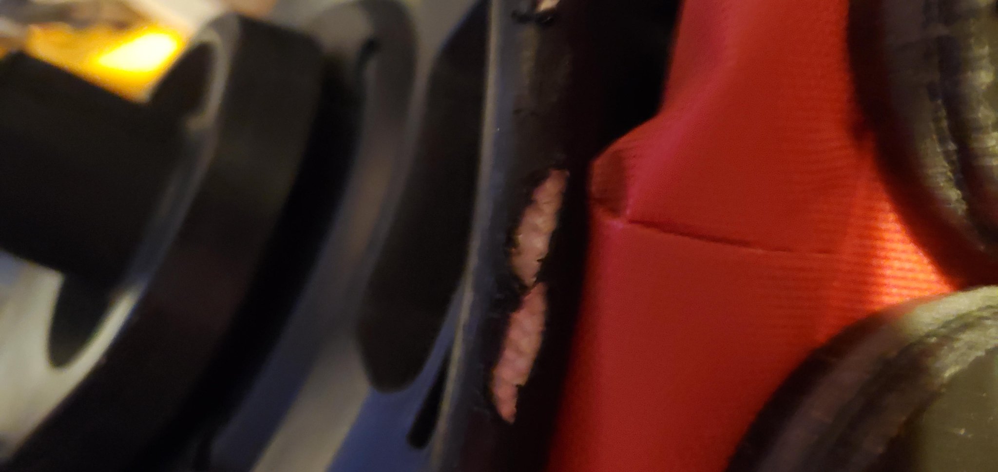

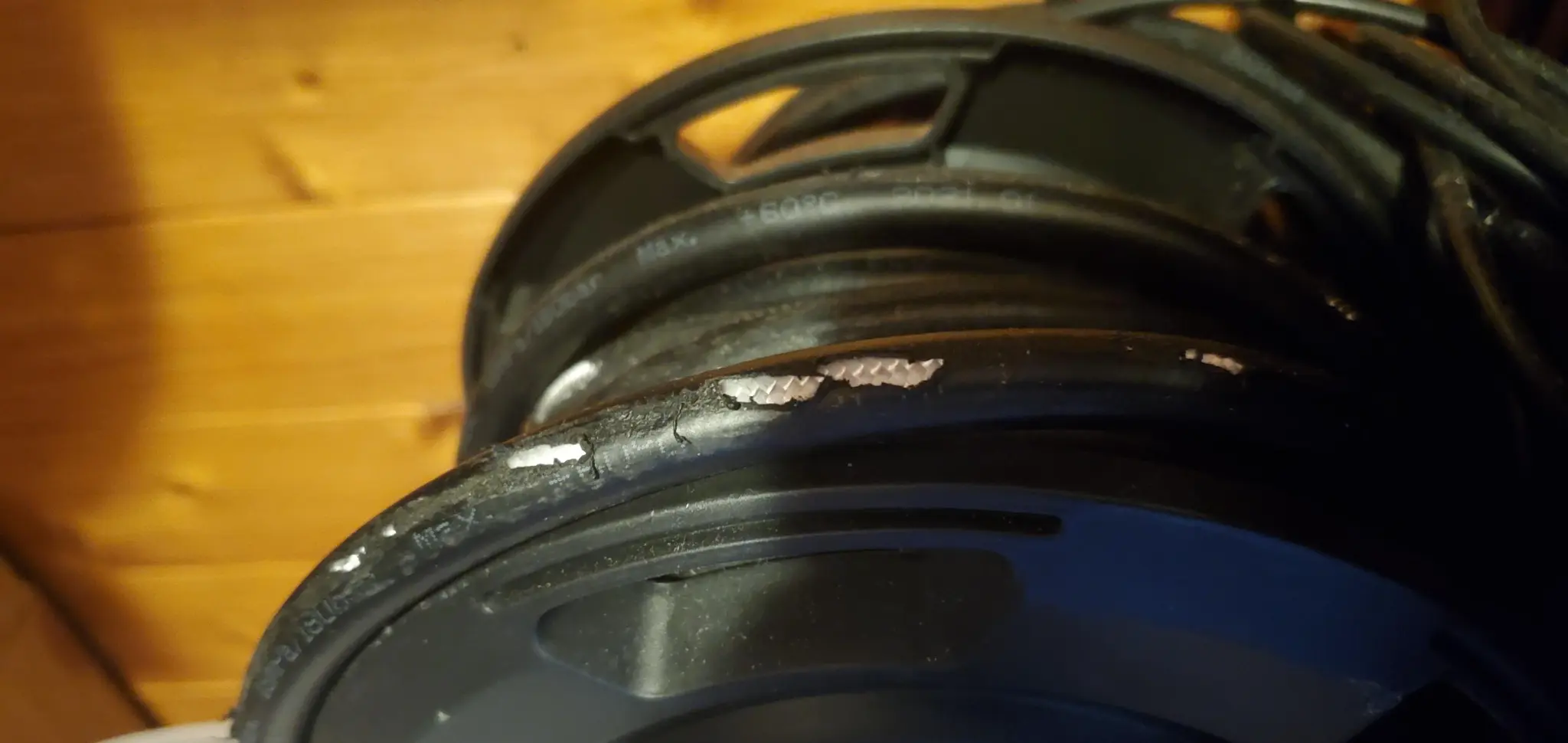

Hi there.
We have this power washer (2 years old) and sadly The outer cable looks like it's worn away and the fabric sheeth(?) inside is visible.
Its only been used 4-5 times and earlier this year, whilst cleaning the front garden a log fell on it (we have a few random ones around the garden for decoration) and rubbed/worn the rubber cable away as we've moved back and forward
It was a £159 new two years ago.
Is it worth/safe repairing it? We sadly don't have the money for a new one at the moment.
I was wondering about using a heat sleeve with adhesive?
Here is a photo of the power cable/Electrical cable that plugs into the wall. This is halfway down the cable.
ANY advice is welcome <3

Here is a photo of the power cable.
Is that the power cable, or the high-pressure hose?
If the latter, which is what it looks like, just repair it. The plastic which is damaged, is just a sleeve - protection from abrasion. I would wrap it well with electrical tape.

Hi, no, sadly it's the power cable.
One end has a plug on the end and the other plugs into the jet wash.
OK.
The cable then, appears to be a tough-armoured one, and assuming the metal armouring is undamaged, the same fix will work of simply repairing it with tape. If you can remove a plug from the end, to enable heat-shrink to be fitted, then even better, use that.

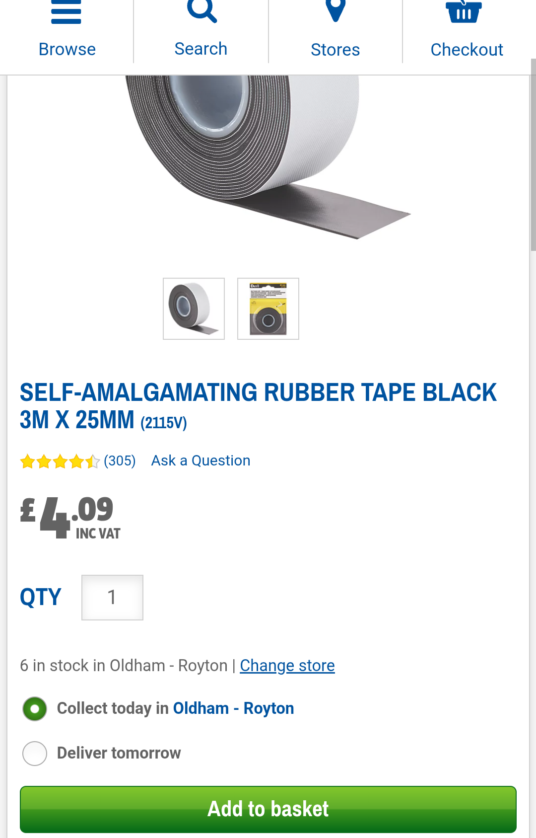

Buy some "self amalgamating" tape, ideal for repairing that - it fuses together as you apply it.

So would heatshrink make it waterproof etc? It's hard to see if the metal armouring is damaged as it's just the fabric sheathing under it.
Thank you!
Should do if applied properly but as there don't appear to be any exposed cores then you only need mecanical protection ( from future log falls ) and tape would be adequate

You can buy heat shrink cable that has adhesive inside to make it "watertight". It will however make the cable slightly more rigid at that point.

Hi. No its not. I check the cable everytime I use it and after. It was fine before using it and when I was putting it away (lifted the log) it was damaged under the log.
I think he’s confused the two
Are you saying that you believe he/she was mistaken when writing:
Hi, no, sadly it's the power cable. ... One end has a plug on the end and the other plugs into the jet wash.
I would have thought that most people could distinguish between an electrical plug and something connected to the end of a hose?
It is a very confusing picture. The damaged component is on a reel and does appear to be a hose while in the top RH corner of the picture is what looks more like a cable.
