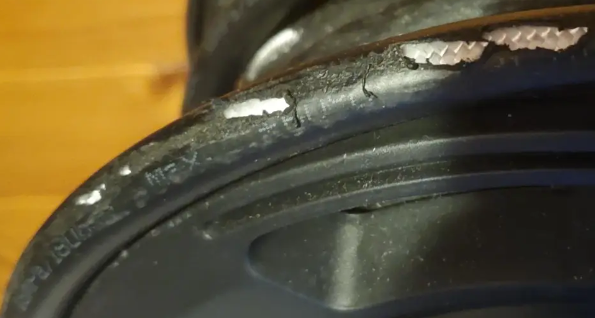

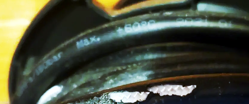

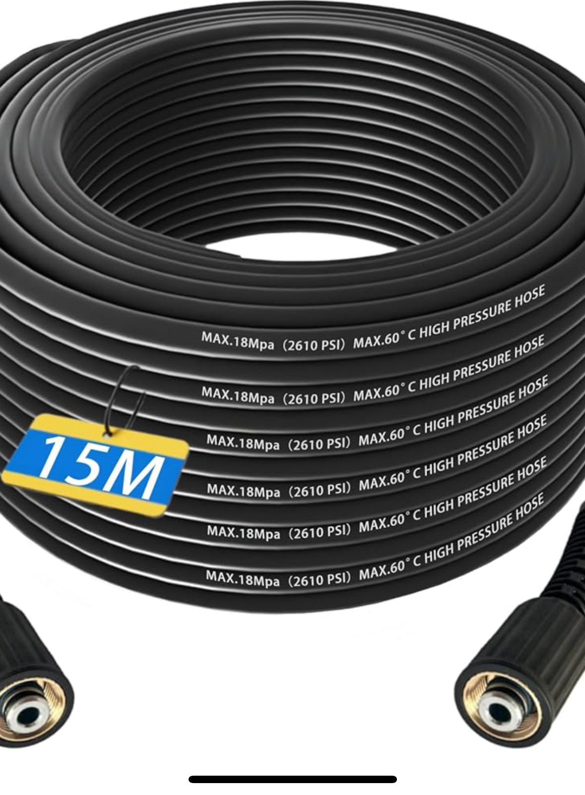

Mmm, I really think that photo of the black thing with the missing chunks showing the white thing is the high pressure water hose. It bears the text “max 60*C” which is typical for a jet hose:Here is a photo of the power cable/Electrical cable that plugs into the wall.
Anyhoos:

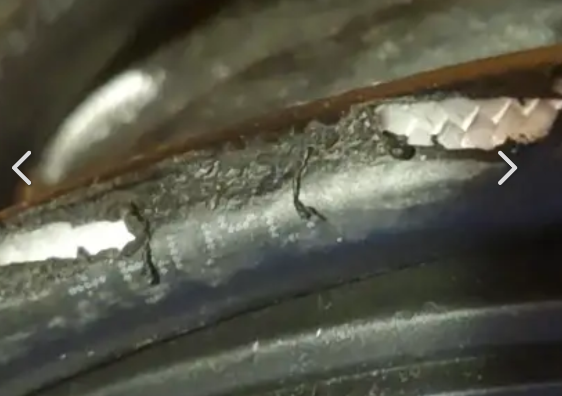

That there with the white showing is more likely to have been damaged by lying on an abrasive floor and being vibrated by the machine. You can see where it has a flat spot worn into it between the white parts.
You can repair this with tape or heat shrink, or rubber paint etc. The outer cover doesn’t contribute to the pressure carrying capacity; that is offered by the now exposed white braiding. If that wears through the soft inner hose will burst
