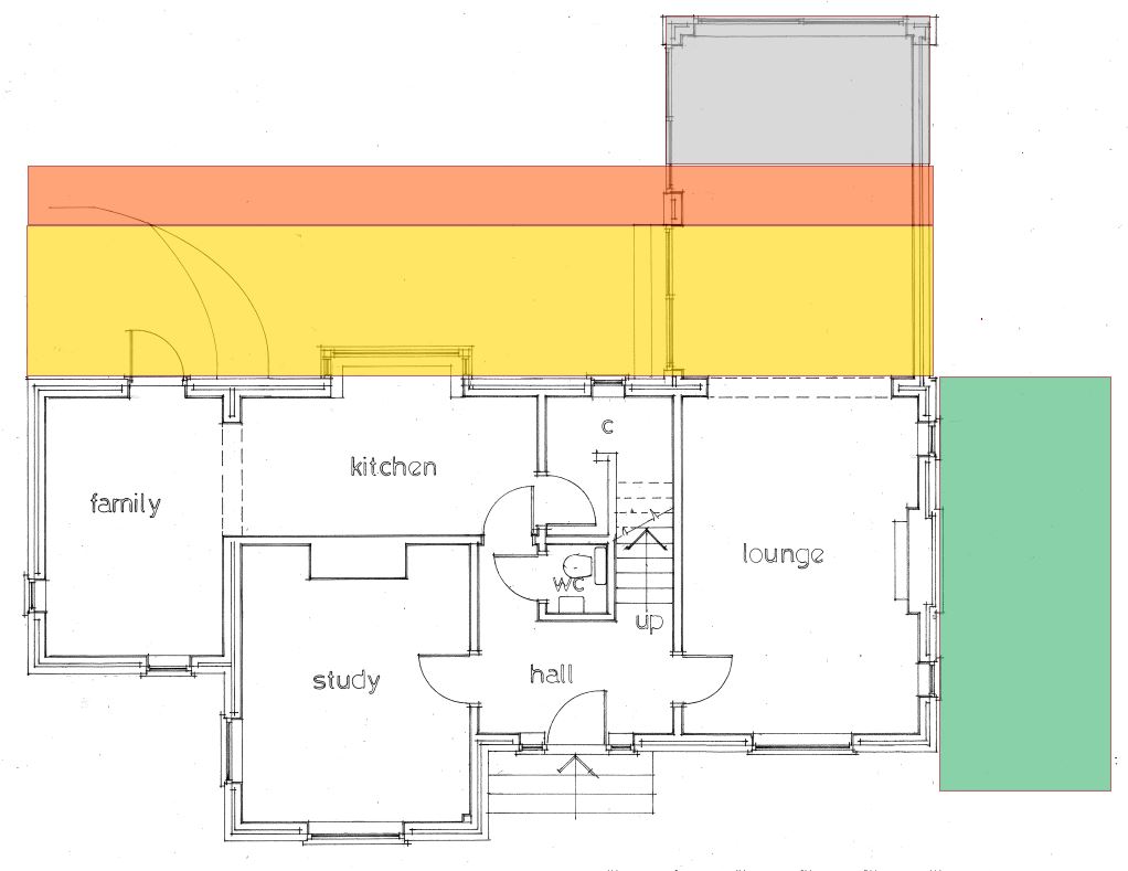

A summary of the situation is as follows:
  • We wish to extend our detached, greenbelt property by approx +85% from original.
  • The council tends to limit development to +35% increase in the greenbelt.
  • We applied for a 2-storey side extension (+35%) — approved.
  • And then a 3m 2-storey rear extension under PD (+65%) — agreed.
  • [Combined these would give us a 2-storey rear & side extension with +100% increase].
  • However, we feel that a c4m rear extension (+85%), without any side extension, would be a better design.
  • Therefore, we applied for a 2-storey 3.8m rear extension (+82%) agreeing to the inclusion of a condition that the permitted side extension wouldn't be built, using the rear & side as a fallback to demonstrate special circumstances to justify +82% in the green belt (i.e. +82% is less harmful to greenbelt than +100%) — refused (as LBC felt that the fallback was neither allowed, nor likely to be built).
  • We appealed — Inspector agreed that fallback was possible, likely and more harmful, however, didn't believe that a 'condition' was enforceable (and needed to ensure we didn't build both side extension & a larger rear extension), but implied that a legal obligation could be used?
I understand we would resubmit our original application with the inclusion of a legal obligation. If we can get the legal obligation correct we hope that the council would have to approve based upon the inspectors decision.
I am after interested in whether anyone has used a legal obligation [or knows of any planning application that relied upon one] so I can see the wording / legal form used.
I have included a plan. Green is Permitted Side Extension, Yellow is Agreed Rear 3m PD, Orange (+Yellow) is desired 3.8m scheme. Grey is to be demolished.

In which case I would (I suppose) prepare an agreement that bound me not to build my extant side extension should I be granted permission & build a rear extension???
Does this sound plausible?
And then what's to stop your wife building the extension, or the people you sell the house to?

I think there is some confusion here in how a unilateral undertaking if formed.
Often UU's are used for standard things set by the LPA's policy, therefore the LPA will have a suitable template (e.g. for paying affordable housing contributions). However if they do not you will need the LPA to draft a bespoke one (most likely they will charge the cost for doing so to you).
The writing up of a bespoke UU is not something you do yourself - as the LPA will need to ensure it us drafted properly it will be done by their solicitors. You then simply agree to it.
As you have an appeal decision basically saying the scheme is acceptable as long as the UU exists, what you are perhaps best to do next is to re-submit the planning application and get the LPA to write up the UU and you to sign it.
I don't believe in this instance it will matter whether you submit the application or get the UU drafted first.
I would perhaps submit the application with a brief planning statement/covering letter saying "following the appeal decision... the application is resubmitted which was deemed acceptable subject to a suitable UU, which the applicant is willing to enter into a UU and request the LPA suitably form" - and then once submitted to chase up the case officer to get this sorted.
If they do the UU and then still refuse the application you should stand a good chance at appeal based on what you have said.
