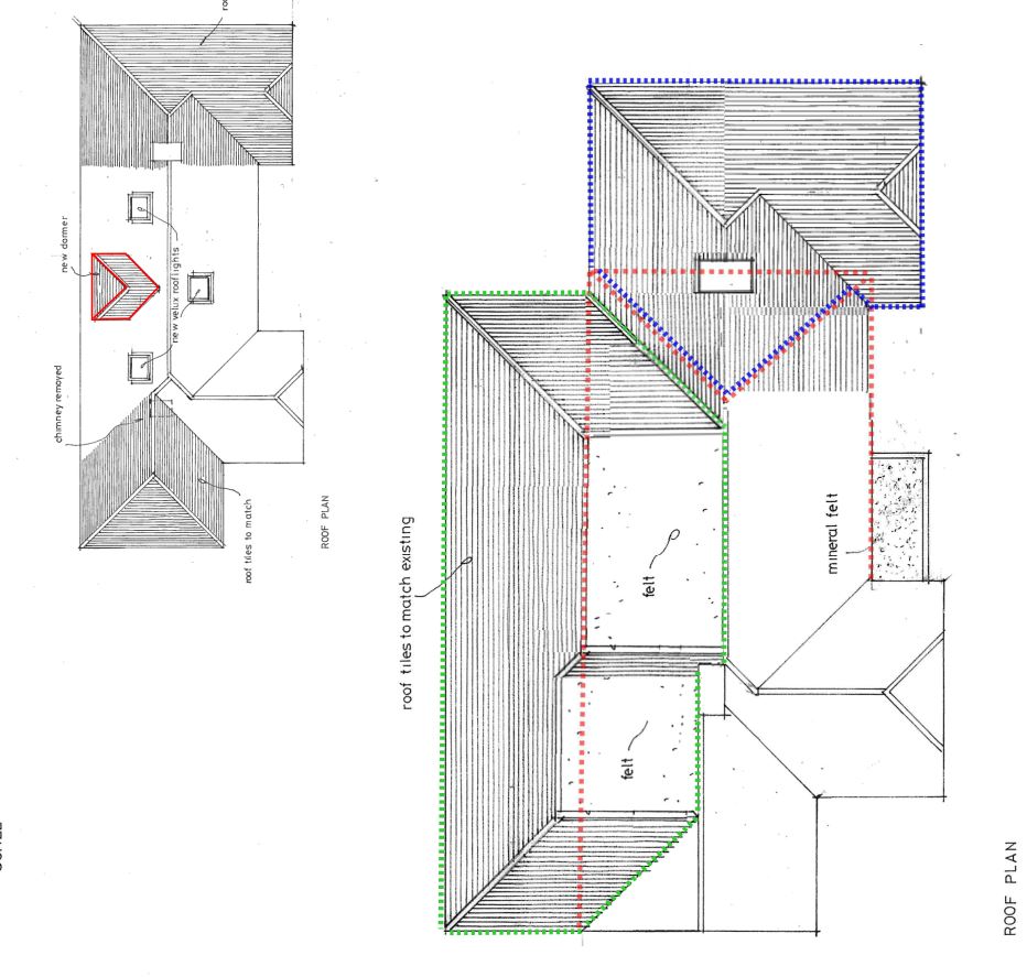

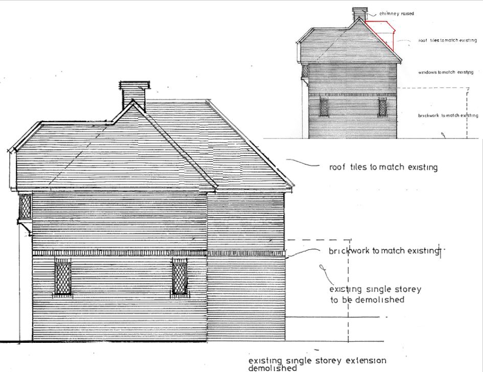

That is the plan. Having build the 2-storey rear extension, the part of the roof that the rear dormer would have occupied has extended rearwards by 3m, so that the dormer would be sitting in the midddle of the loft !!
Hence I want to be able to show that it is legitimate to build the 3m rear extension (PD), then the side extension but without the rear dormer.
See Elevation: Large is Existing+ 3m 2-storey rear; Small is Existing+ rear dormer

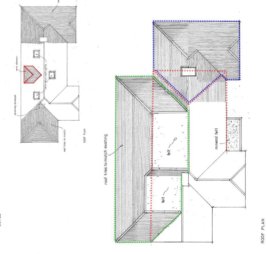

[I have added a roofplan showing just the side extension (A), and then with both side extension (A - BLUE) & rear extension (B - GREEN)]
