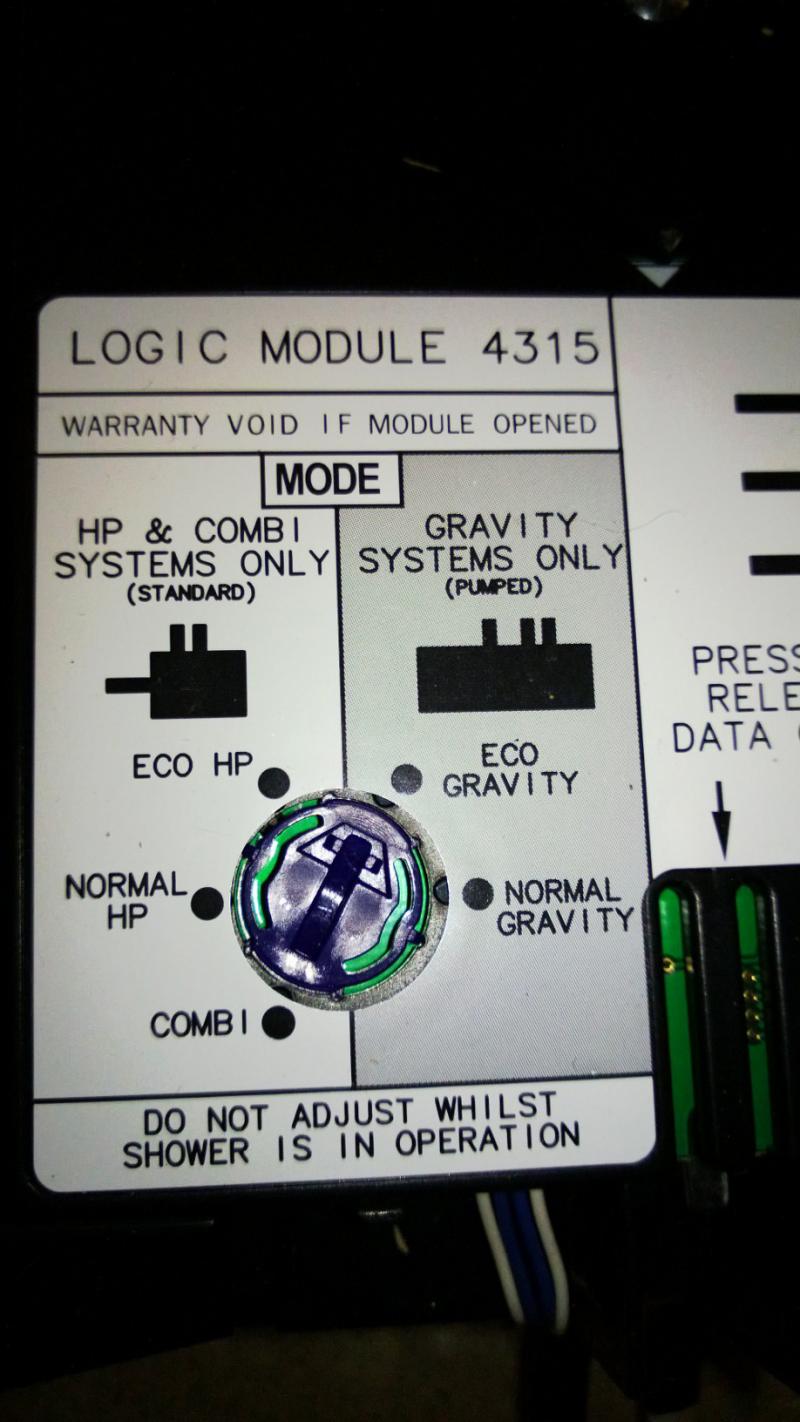

I have an Aqualisa Quartz digital pumped shower connected to a typical boiler system with the expansion tank and cylinder, so the hot and cold water is piped separately to the Quartz processor box in the loft which mixes it and supplies the mixed water down to the shower. I'm replacing my boiler for a combi system, we have good water pressure and im going for a min 24 output boiler i think.
My question is A: can i use the pumped processor with a combi boiler?
I know you cant pump mains water, so can I simply turn off the pump? The processor box has a switch (See pic) that allows the selecting of 'Combi' for combi boilers so I'm assuming this just turns the pump off? The max pressure for this kit is 1bar though, so it may be a 'it works until it leaks' scenario. The replacement box without the pump is £250, so

Your best bet is to ring Aqualisa and ask them if your processor is suitable for a combi boiler (you can't pump mains water). I can't see why they would specify that the mains pressure should be under 1 bar when you have the option of turning the processor for a use on a combi!!
Nb - a 24kw combi normally supplied 9 litres a minute which is pretty disappointing. Personally I would be looking at a minimum of 30kw (12 ltr/min).
looking at your second pic it's looks like the piping is different to the processer pump attachment.
as above i wouldn't dream of fitting a 24kw combi
No you can't use the pumped version on a combi.
You'll need to change the processor and remote.
The gravity version is 1 bar max the standard version is 7 bar max.
But they both have the same module fitted.
