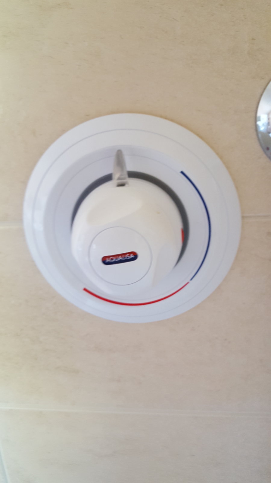

Hello everyone,
I'm looking for model of this Aqualisa shower model (pics attached). Based on search I think this is Aqualisa colt concealed shower.
It is leaking continuously in main vent and dripping water from the open close knob as well. The shiwer is fed from Combi boiler. I presume that removes the electric supply question.
I'm comfortable in replacing like for like models. Also anyone know where is the screw or first step to open this?
Thanks in advance,
Gnans
looks like a 600 series to me
https://www.aqualisa.co.uk/parts-accessories/modules/aquavalve-600-thermostatic-and-430-manual-mixer
otherwise try
https://www.aqualisa.co.uk/showers/identify-my-shower
It probably needs a new cartridge
https://www.aqualisa.co.uk/parts-accessories/cartridges/thermostatic-cartridges
Observe the colour ring on the old one
as you have a combi it should be a high-pressure one - there is a chance your existing one is wrong, since it is leaking.
there are dozens of utube videos on that
they are designed so that after removing the round trim, you can maintain them from the front without having to dig them out of the wall. The mechanism is quite simple.
If you're working on it, clean off any limescale using a nylon brush and bathroom cleaner. Plastic parts are safe with acid. Rinse off well. You should be able to make it look and work like new.
It's a very high-quality mixer

@JohnD By any chance do you where is the first screw or step to remove the outer covering? I suspect it is either behind the Aqualisa label or I should pull out on/off knob.
can't remember
search "utube aqualisa change cartridge"
there might also be instructions on the maker's website
