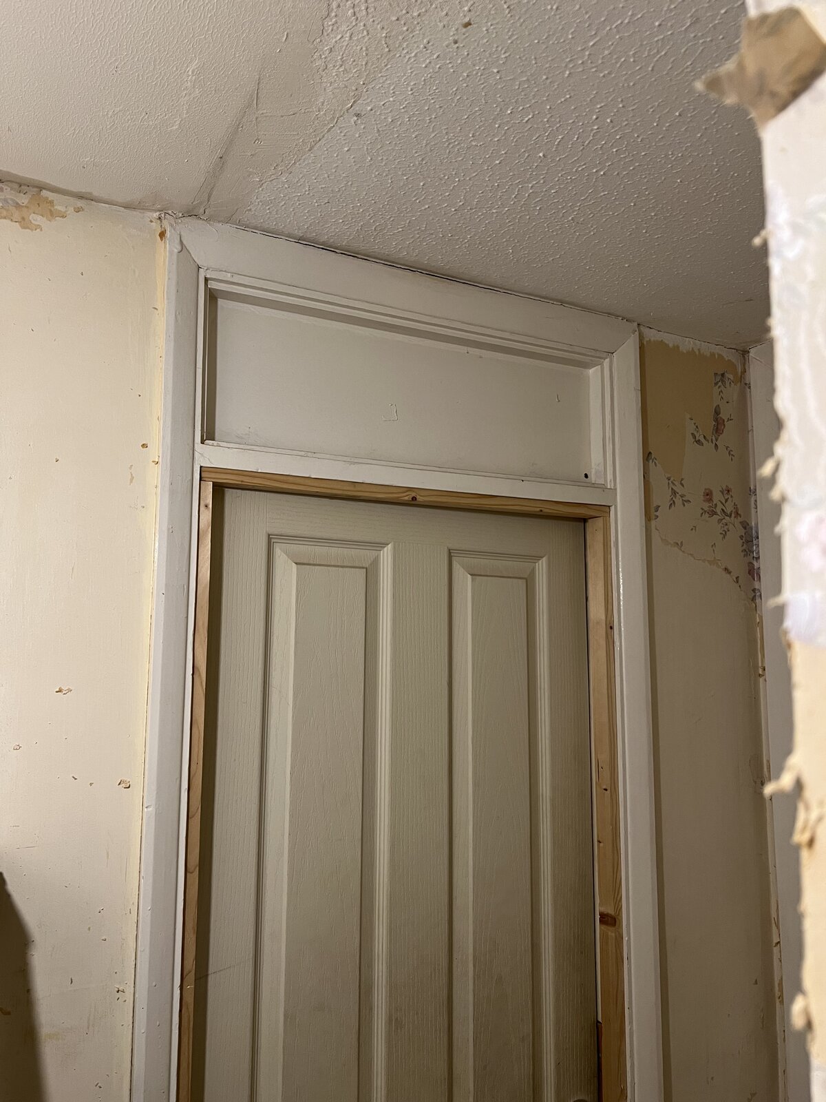

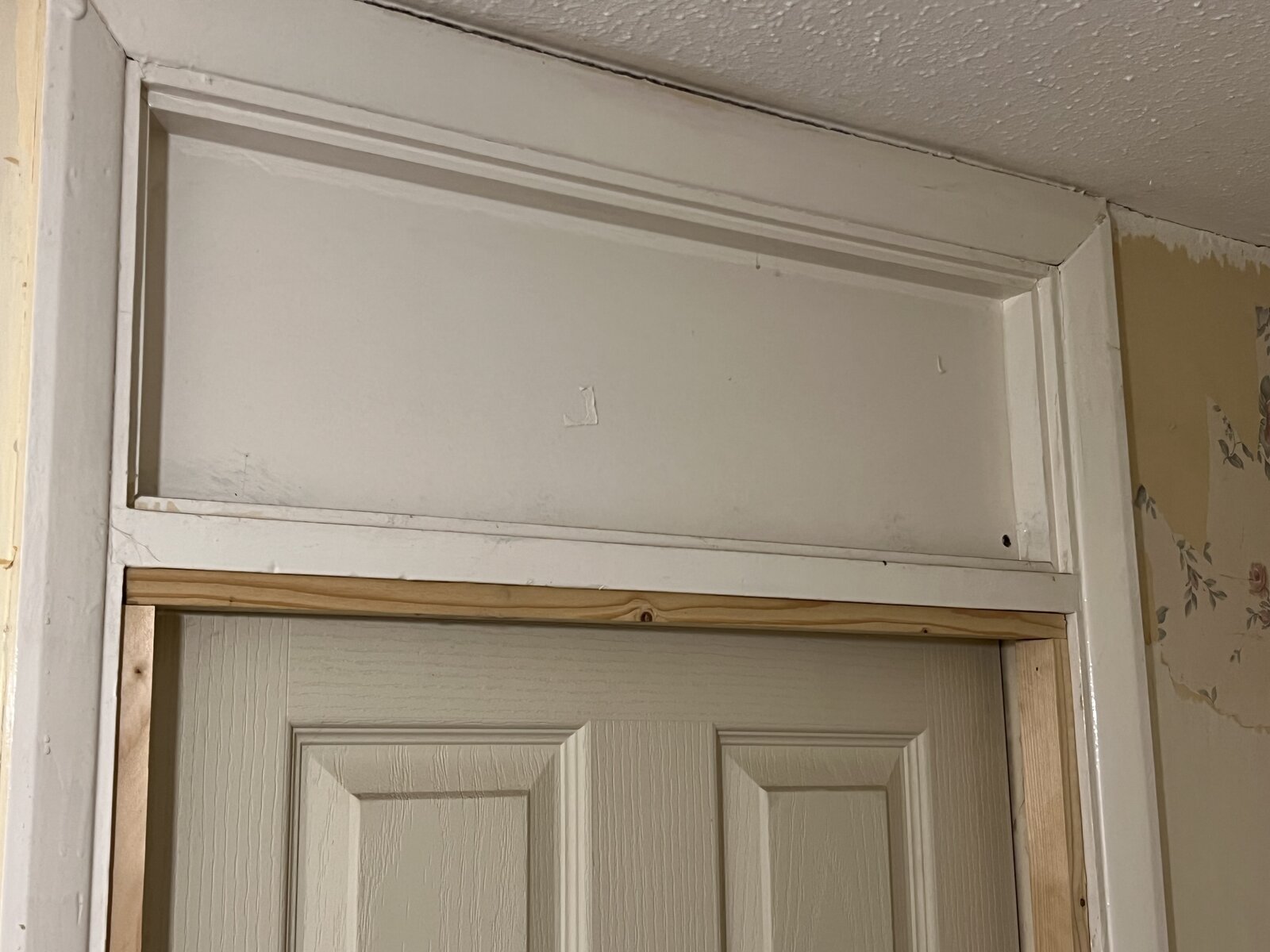

I want to amend these door frames and get rid of the top section. I want the architrave just above the door. Can you please suggest how I blend the top into the wall and fit my new architrave just above the door, like they are with most doors.
Thanks in advance.

you will probably have a "borrowed light " above the door covered over[window to add light to a stair or corridor without a window]
your solution will involve loads off work and possibly broken glass
you will have to remove the panel and glass iff fitted
reform a frame for the plasterboard to fix too then you can think off the architrave

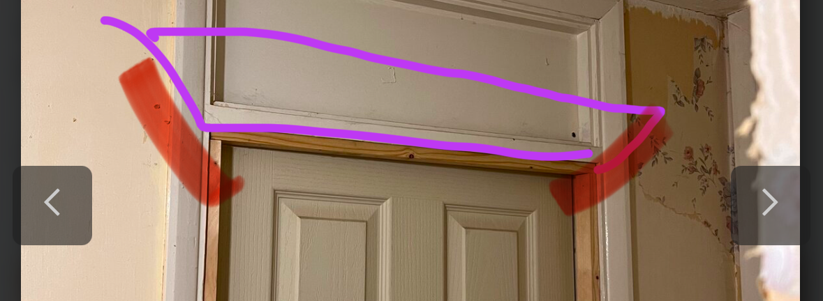

Can I carefully remove the glass and then use a recip saw to cut here (black lines):
I can then build a frame for some plasterboard above this?
I assume this isn’t holding any structure above it or load-bearing in any way?
Thanks again.
no load just a remove [or cover ]glass and panelling and treat as part off the wall
in general do not recip you need to expose what is there and form a game plan what will be behind will probably be a frame that needs panel and glass removed then baton added to give a lip for plasterboard to sit on
you can fudge or bodge it but you need old and new edge to be tied in together to avoid cracks so iff you have at least 20mm behind the plasterboard so around 35mm from the front face you can just apply a 22x22mm baton but suspect sealed finished face on the back but the step on the side you show needing removal
in general recip saw tend to be full wooden window removals and demolition virtually never small internal as internal tend to be studs with timber added so more prise apart back to stud then add
I've just done one of those.
Remove the beading, panel/glass pane, build a stud frame, add insulation, plasterboard both sides.
Cut back top layer of plaster on both sides, add scrim tape over the joint between old and new, to avoid cracks later
Plaster over the top and then sand and paint.

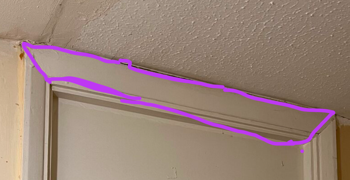

With regards to your architrave, don't use recip saw or cut square as indicated! Use tenon saw or mini circular saw/multi tool to cut the vertical ones to 45 degrees to fit the top original part properly and refit that above the door
Carefully remove this piece in a one-er and clean up the angled sides
Move it down to here and use it to mark the cuts you need to make (red highlight):
Cut, dispose of all above-door architrave etc, fill the hole above the door with stud/plasterboard/plaster etc, fit the architrave top in the new position

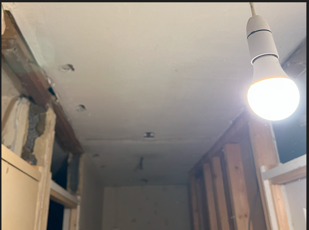

Bit of an update on this. I removed the beading as suggested above and removed glass pane. No casualties.
I then cut off the frame to leave a bit of a section that I can pin my new architrave to. Against some of the advice here, I used the recip saw for this bit. It will be hidden behind the architrave anyhow.
Not the greatest pic but this is where I am at:
I can now build a small studded section here and figure out its placement in relation to the new plasterboard but i think I need to go beyond the door and then scrim tape it in as else it will keep cracking?
The plaster on most walls is on the blocks as seen in the pic. What do I use to cut in and how far do I go? Also, How do I stick this section to the blocks?
