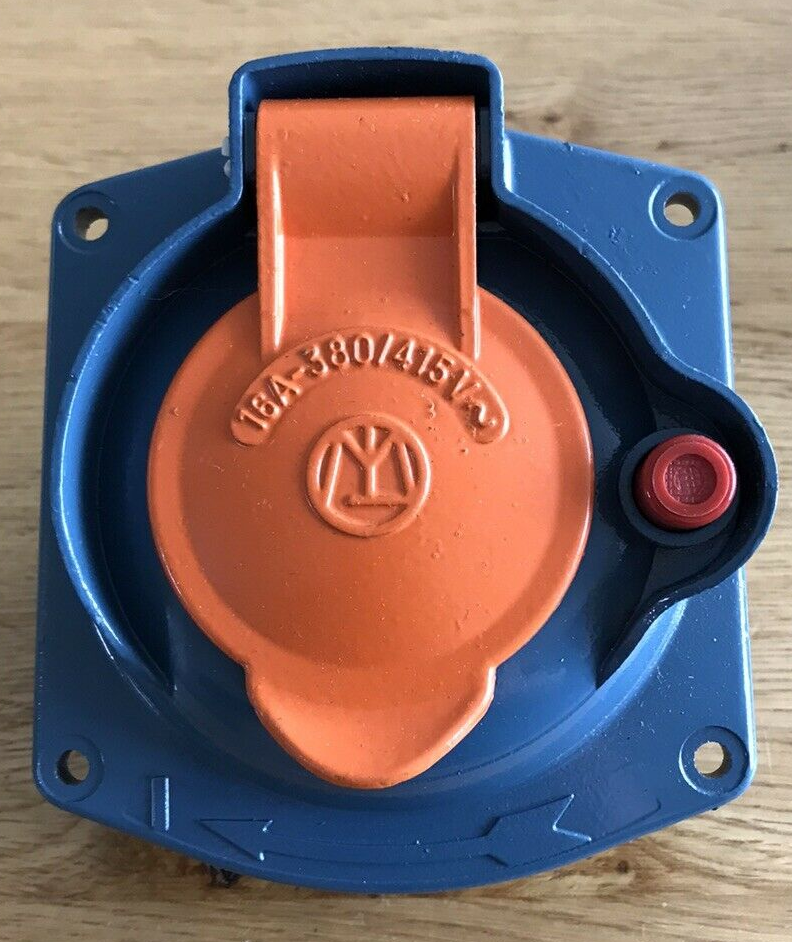

Where I worked we had these View attachment 257541 mainly the 32 amp version, made by Martin Lunel these were far better than the cheap plastic versions we use today, the plug had to be inserted and turned to make it live, and the button released it. Technically not to British standard listed in the book, however some times we need to use some common sense, and we all know there is nothing really wrong with a 32 amp extension lead with commando sockets, just being petty and pedantic.
Blooming horrible things, prone to failure.

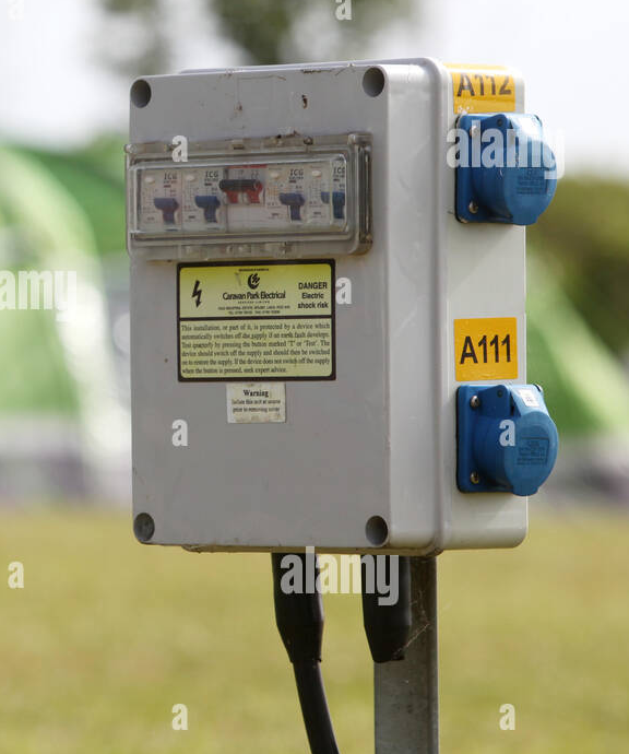

https://www.lewelectrical.co.uk/2019/02/12/18th-edition-regulations-caravan-parks/ claims the requirement was added in the 18th edition. I haven't verified this with primary sources though.
Ah - I din't realise that you were talking about BS7671 (a section of BS7671 which I've never had a reason to look at!) - so, yes, you're right...
BS7671:2018 said:
708.55.1.1 Every socket-outlet or connector shall either comply with:
- BS EN 60309-2 and shall be interlocked and classified to clause 6.1.5 of BS EN 60309-1 to prevent the
socket contacts being live when accessible, or
- be part of an interlocked self-contained product complying with BS EN 60309-4 and classified to clauses
6.1.101 and 6.1.102 of BS EN 60309-4 to prevent the socket contacts being live when accessible.
BS7671:2018 said:
708.553.1.8 Each socket-outlet and its enclosure forming part of the caravan pitch electrical supply equipment shall comply with BS EN 60309-2 and meet the degree of protection of at least IP44 in accordance with BS EN 60529.
708.553.1.14 Socket-outlet protective conductors shall not be connected to a PME earthing facility.
... The means of connection between the caravan pitch socket-outlet and the leisure accommodation vehicle should be an assembly of the following:
- a plug complying with BS EN 60309-2
- a flexible cable type to H05RN-F or H07RN-F (BS EN 50525-2-21) or equivalent, with a protective conductor and having the following characteristics:
- continuous length 25 m (±2 m)
- for current rating 16A, minimum cross-sectional area: 2.5 mm2. For a higher current rating, the crosssectional area must be chosen so that secure tripping of the overcurrent protective device is achieved at the lowest fault current calculated at the end of the cable extension set - conductors to be identified in accordance with Table 51
- a connector complying with BS EN 60309-2.
Unless I'm missing something, it doesn't seem to be explicit about what is required at the female end of the cable connecting the supply to the caravan, although it could be said to be implicit that it is required to be 'interlocked' (or shuttered but i doubt they exist) (it is after all, a 'connector', hence 708.55.1.1 would seem to apply) - ut, as has been discussed, I didn't know that leads with such connectors existed (not that I know anything about caravans ;) ) - for all I know, they may be 'standard'?? @eric????
Kind Regards, John

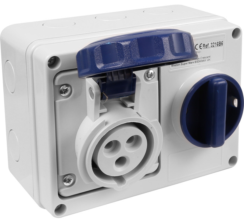

Caravan sadly gone. I did a google for "16 amp in-line interlocked socket" with no results, can't really see how they could be made and fit on the space around the fixed plug on the caravan?
Although it says
553.1.4 Every socket-outlet for household and similar use shall be of the shuttered type and, for an a.c. installation. shall preferably be of a type complying with BS 1363.
I think the question not explicitly answered is whether BS7671 covers just the fixed wiring installation, or by implication whether it also covers items connected by plug and socket. I would have thought not, so in my amateur opinion the end of an extension lead or mains cable would not be a "socket-outlet".
On a related point there was reference to the garden being a special location. If portable equipment and cables fell under BS7671 then logically would you have to notify Building Control when you run an extension lead for your hedge trimmer etc?
They are made, I think Lewden as an example, but they are the insert and twist style which in My experience do not have a long enough life expectancy and they cost a lot too.

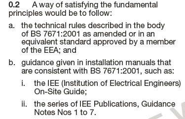

OK I have a copy of BS 7671:2001 I will look latter as to shuttered requirement.
BS 7671:2001 said:
553-01-04 Every socket-outlet for household and similar use shall be of the shuttered type and, for an a.c. installation, shall preferably be of a type complying with BS 1363.
So that hasn't changed,other than for the reg number.
However, that has absolutely nothing to do with the main point I was making - namely that I'm not sure that you were necessarily correct in saying that Part P is not applicable (hence notification not required) if an item in a kitchen in Wales is installed via an extension lead fed from a plug/socket
Kind Regards, John
