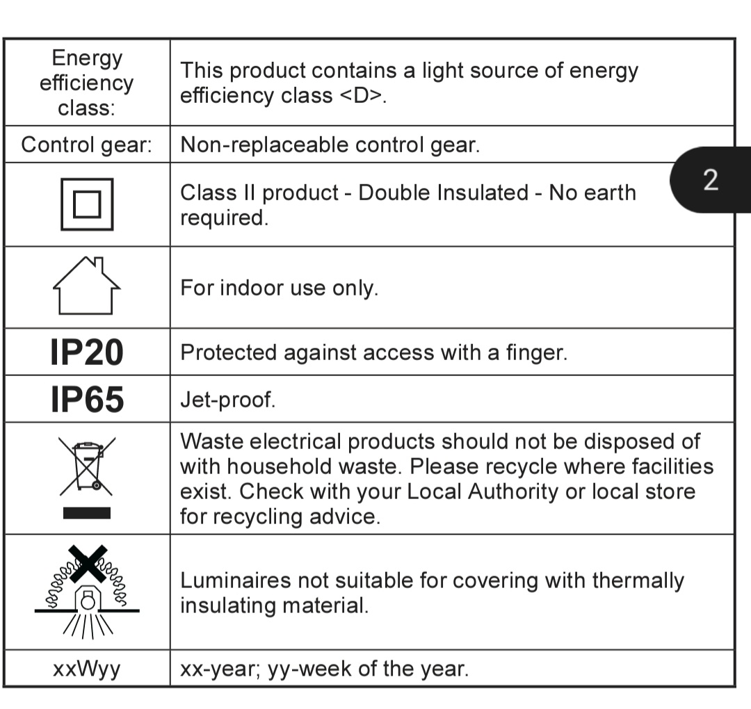

I'm afraid I disagree here.
Whether the LED downlight requires an insulation hood, depends on the manufacturers instructions.
It has nothing to do with fire spread and is heat related.
There is no need for fire rated downlights or covers, if the the ceiling doesn't have a fire spread requirement.
I.e. in normal domestic houses, they wouldn't usually be necessary, whereas in flats, or HMO's they would.
For example, these LAP LED spots would require an insulation hood..

In the old days, we had two types of reflectors, those which would reflect only light, and those which would reflect heat and light, with the former behind the lamp needed cooling, so suitable for pods and the like, when for example lighting a picture, so the picture did not get hot, but not as a down light covered with anything be it a hood or insulation.
However, with LED cooling can be built into the bulb,
so yes does depend on the manufacturer, but be it a hood or insulation it is still covering the lamp, so neither suitable if it says not to cover.

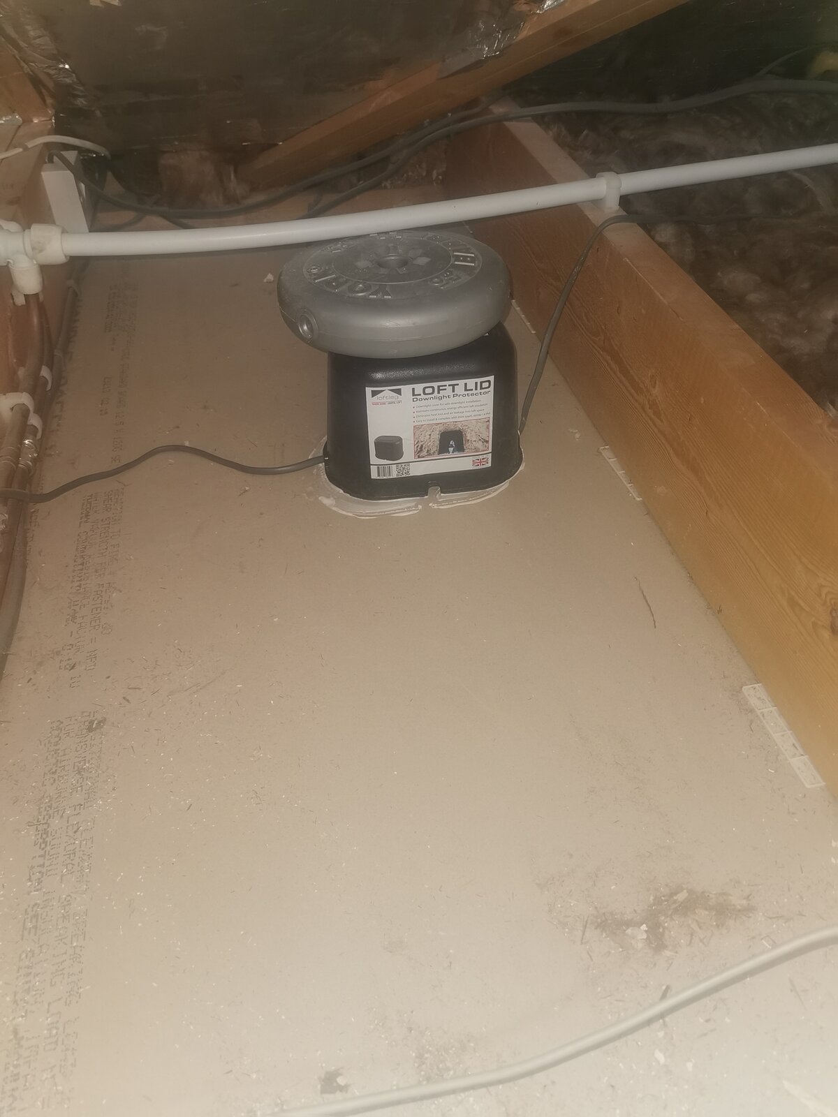

Couldn't find the details for the lights I'd fitted so I went with loftlid covers from screwfix.
Forgot to take a finished picture and there covered by boards now but they have done the job well enough.
