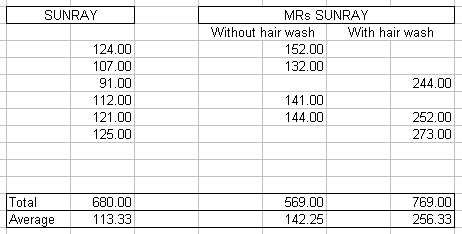

I have a cheap event timer showing how seconds a contact is closed for.
Adding a current switch (clamp) to our shower supply I've been able to acurately show the duration our shower is powered for.
My average time is 1 min 53 sec and Mrs Sunray 2min 22 sec or 4min 16 sec with hair wash.
However My daughter and her husband seem to take 10-15 minutes, or that's how long their noisey booster pump thumps away for.
