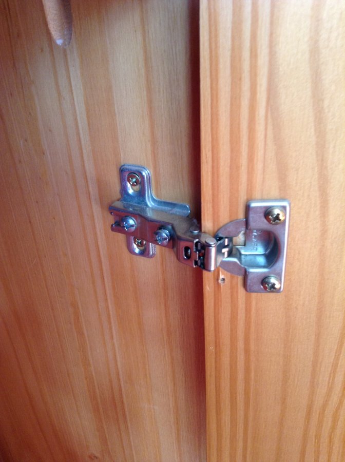

As the title says are hinges standard sizes? I enclose a photo of a cupboard hinge I want to replace with a 170 degree hinge so that it opens fully? Do I measure the diameter of the round hole it slots into on the door?

Kitchen hinges have a standard bore size of 35mm regardless of make. You may find that the cruciform plates which sit on the cabinet sides vary somewhat but as most hinges are sold as sets it isn't much of an imposition to change them as we'll
