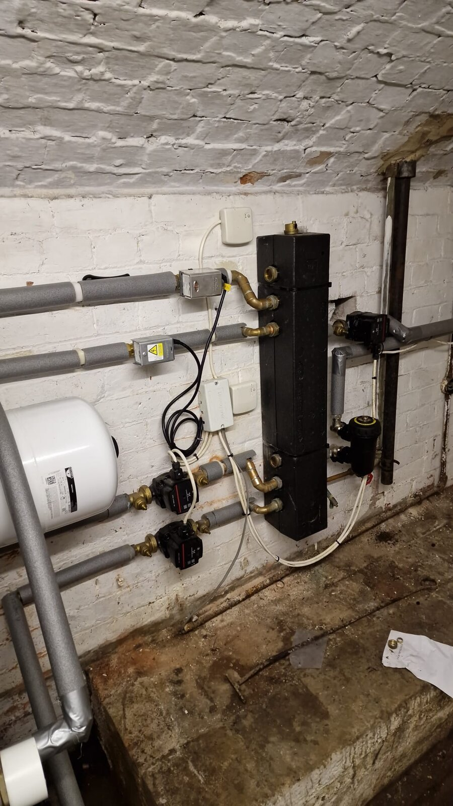

On the left top of the LLH you have two motorized valves which presumably are feeding the heating/HW side and two pumps on the returns from them?.
Got you.
So the top motorised valve is for the heating, and the bottom motorized valve is for the hot water. They both work independently and are powered by the Honeywell Total connect system.
The pump on the right of the LLH is direct from the boiler. The top pump on the left of the LLH is the heating return. and the pump beneath that feeds the hot water cylinder. That is currently set to constant speed two.

If the CH is on then take the top left temperature after the motorized valve and the temperature after the top (left ) pump, if the HW is on take the other two, and if you can run the system with both systems on take the 4 temperatures, in all cases take the right hand temperatures as well, can see then if any mixing going on.

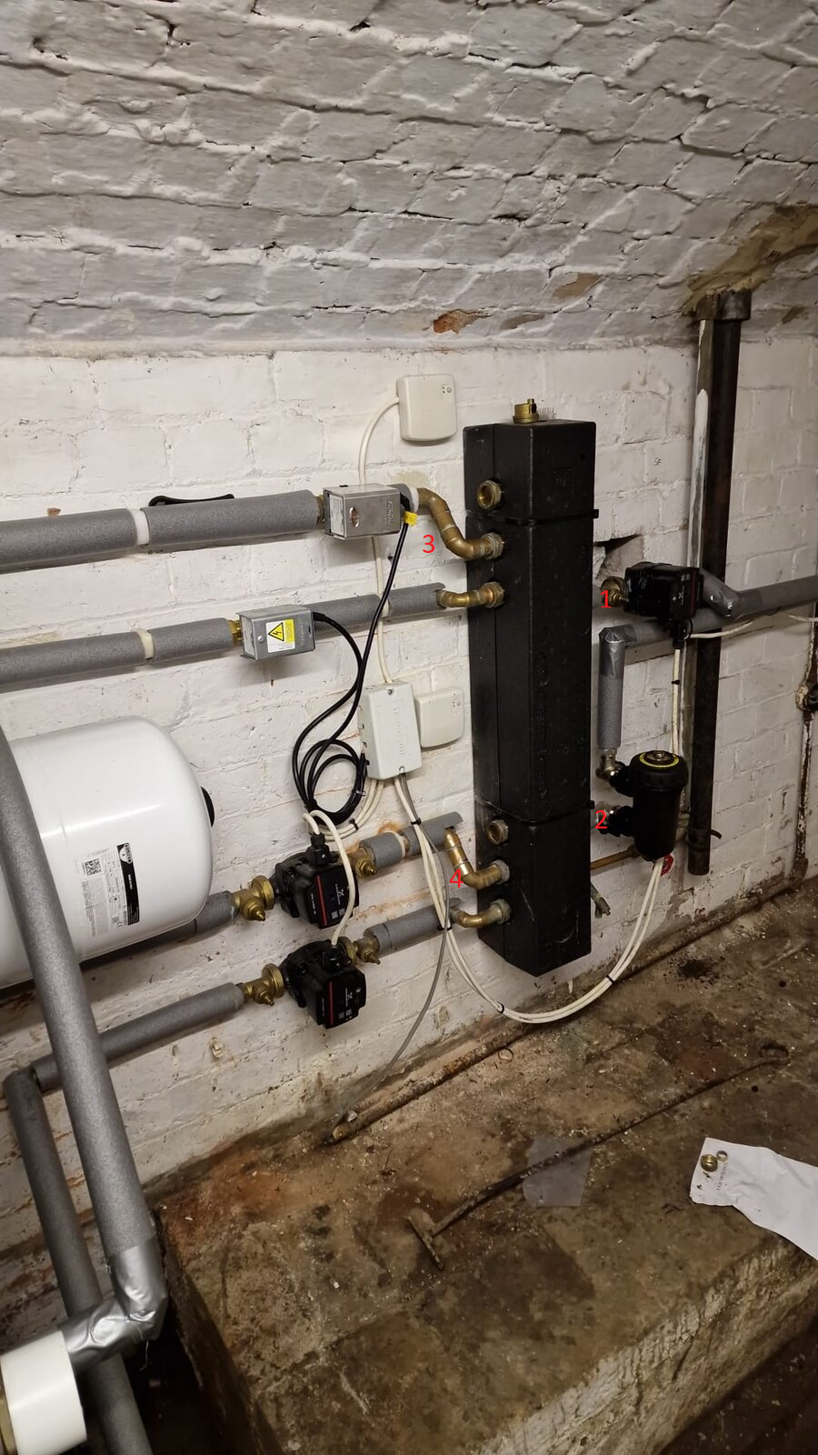

OK, I will try and make it a bit easier, these tests will help tell if the pump(s) are on the correct settings.
Do this test only first, CH only on. and post back your readings.
1 should be the same as the boiler flow temperature, around 65C?
2 should be fairly low ~ 35 to 40C
3 should be similar to 1 but may be lower
4 should also be lowish.

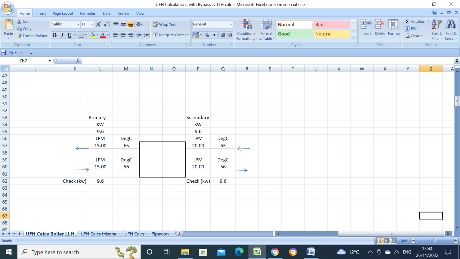

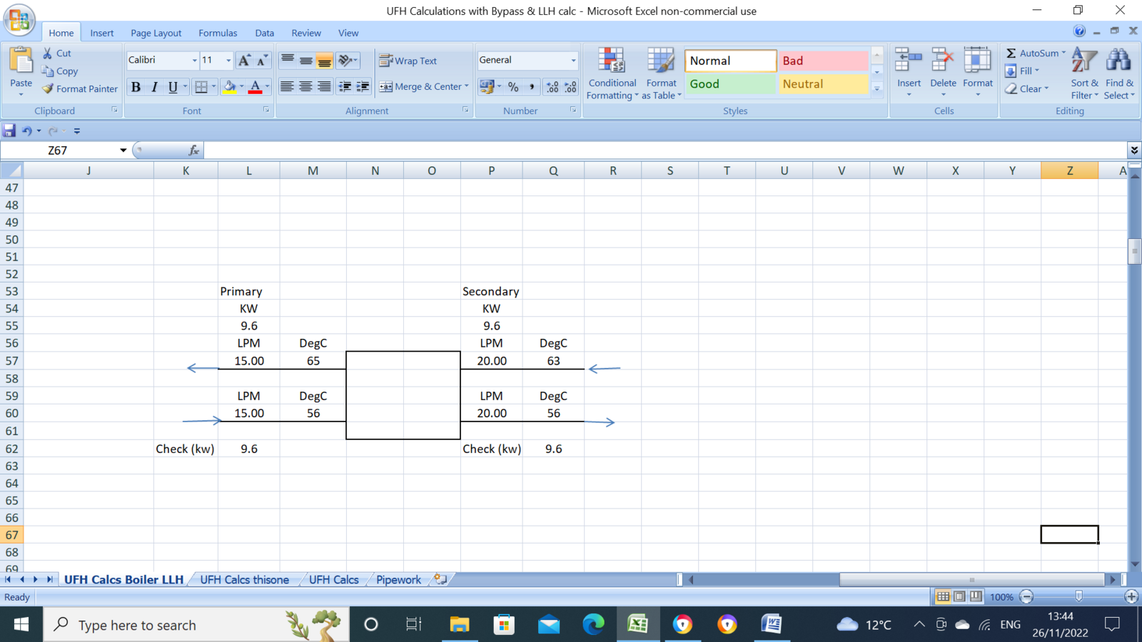

You say your heating costs £800/month, £27/day. At a natgas price of 10p/kwh this means your gas consumption is 270kwh/day, if you have the heating on 24/7 then consumption is 11,25kwh/hr = boiler output of 9.6kw at 85% boiler efficiency.
Don't know the actual temperatures at the LLH but assuming the boiler is running continuously and not cycling on/off due to the Honeywell TRVs (if TPI) then you might expect something like below.
