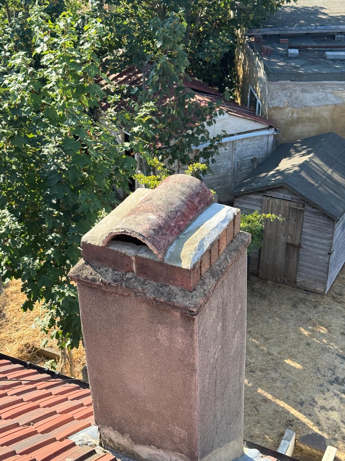

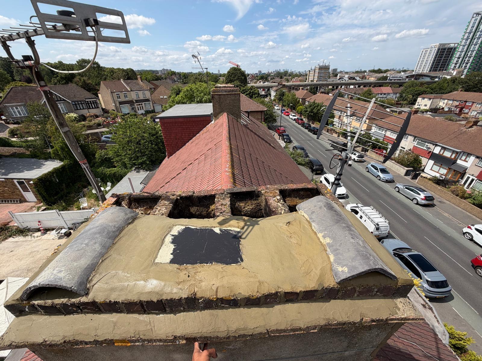

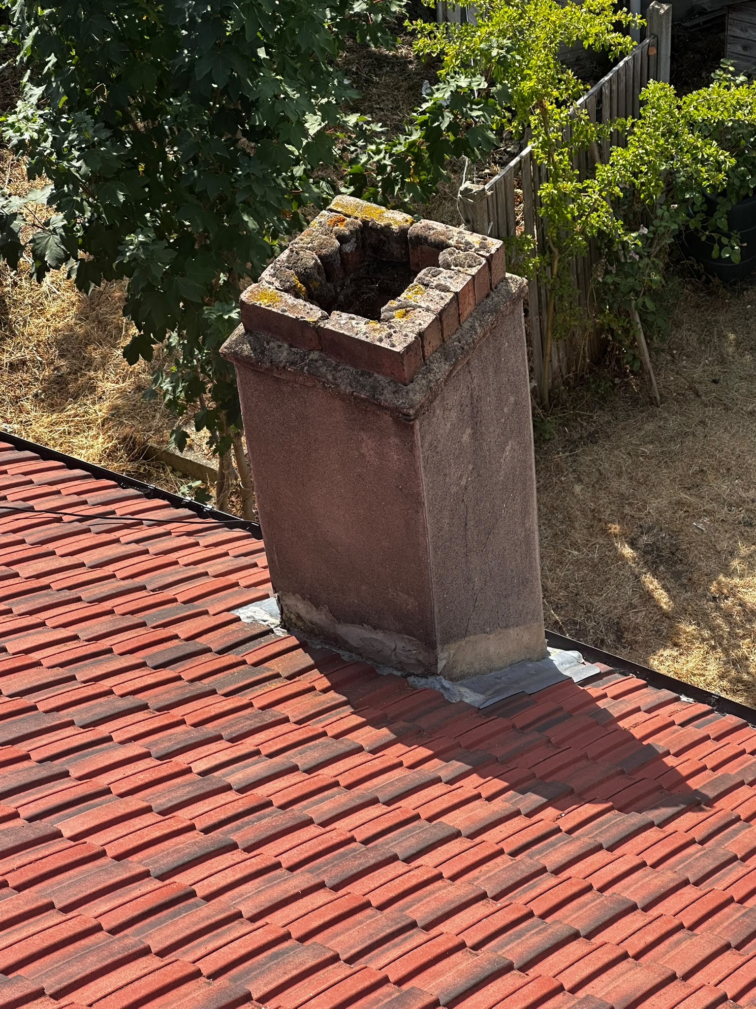

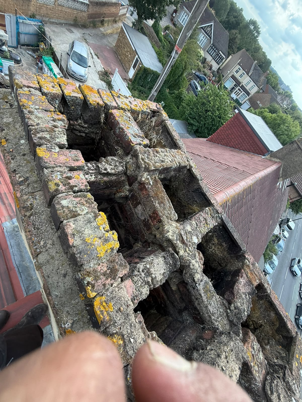

Are these chimneys capped off properly ? Attached the before and after pictures. The chimneys are no longer in use

1. No, the chimney stack flues, even tho they are redundant, are incorrectly capped off. Best that each redundant flue have its own terminal.
2. Correct redundant flue terminals such as mushroom hoods are best practice. Dont use cheap metal terminals or cowls - they soon rot out.
3. The idea is to keep rain, birds or animals or blown debris from blocking the flue.
4. FWIW: Redundant flues must be swept.
5. FWIW: Ventilation must be provided at the bottom of the flue.
6. Eight open flues can be seen where the stack brickwork has been dropped. Do you want some kind of advice ref that pic? Or am I missing something?

They are ok. As Woody has said, it's inviting to our feathered friends and difficult to mitigate with that set up.
That black square looks like water will pool on it when it rains.
Gives the birds a little bath :)
