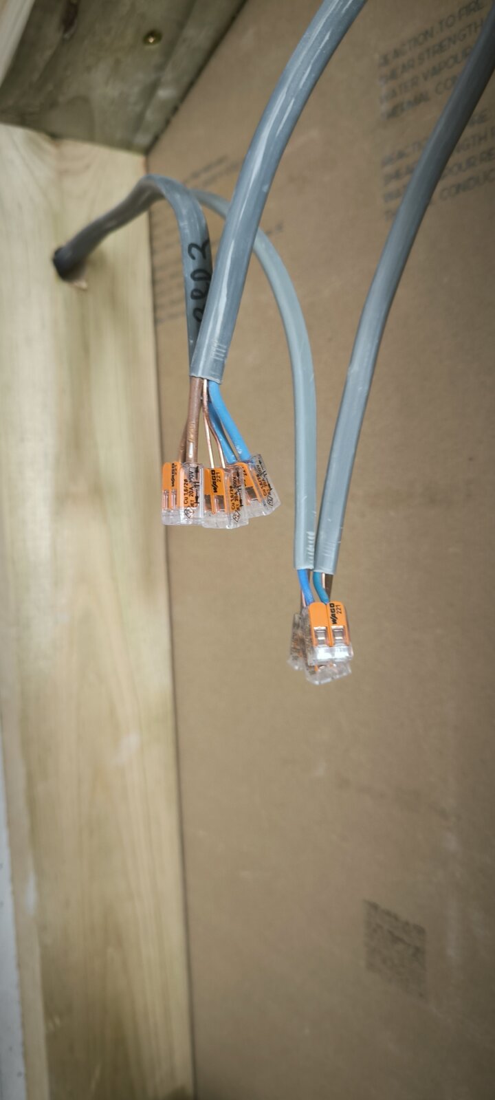

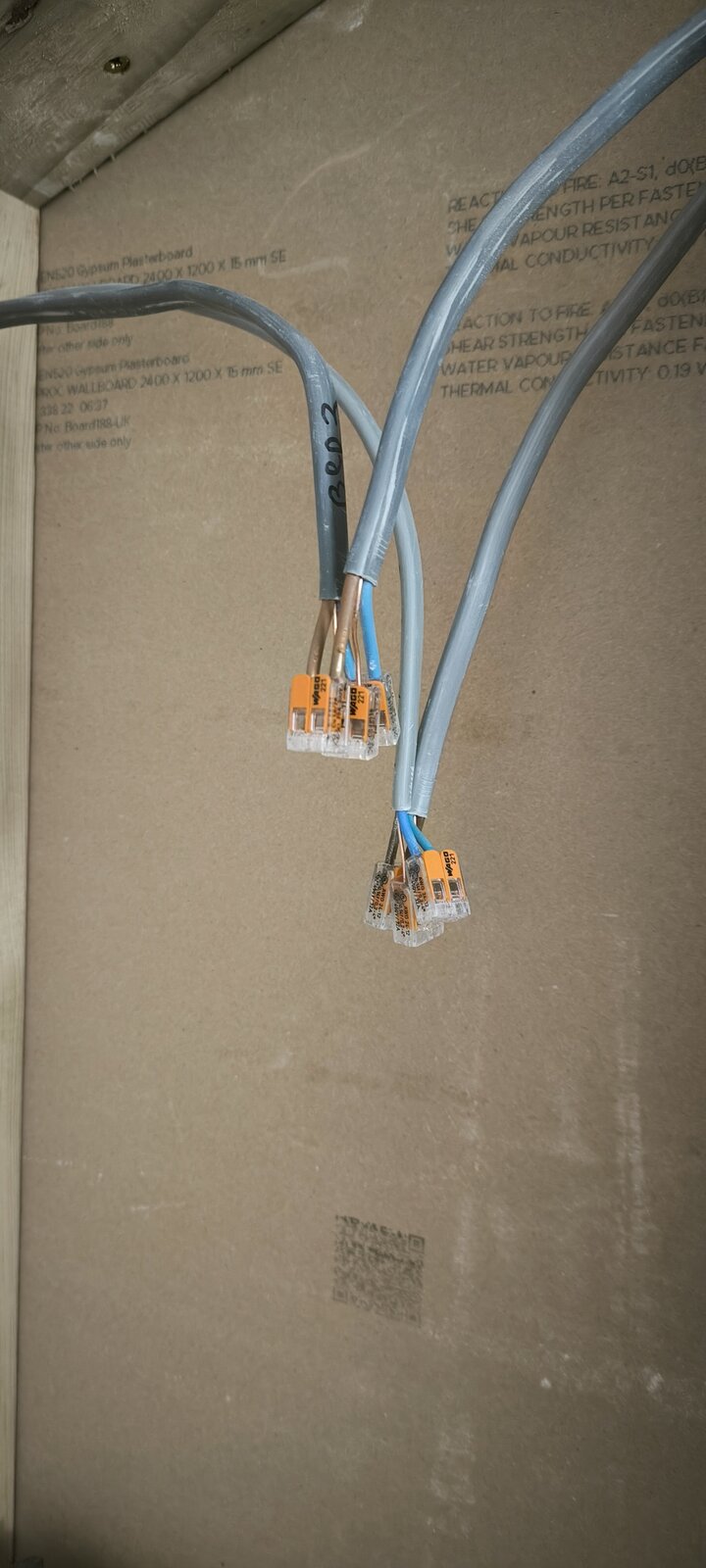

I have joined two cut cables using these wago 221 connectors as shown on photo. I am not convinced they are good for the load especially the sockets circuit. Should i be using the old fashioned screw terminal blocks instead?

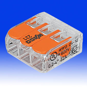

do they have the amp rating on the side ? 32A ??
last lot i used last year had a rating on them and cable size
should have green/yellow sleeving on the earths - and where are they going to be - i would put in a box

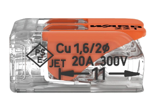

They have 20A marked on the side which is technically enough for a ring circuit.
Interesting. Last time I made that statement, you, JohnW2 and several others stated that the connectors had to match the MCB value.
I think that they say 20A on one side and 32A on the other. Different testing standards I believe. Either way they will be ok for a ring circuit although they should be inside an enclosure, a maintenance free enclosure if they are going to be buried in a stud wall. They also appear to be dangling down so they are probably outside a "safe zone". Clip the wires up to the studwork and fix the enclosure to the studwork so that everything remains in a safe zone. As above, slide a bit of green/yellow sleeving over the earths.

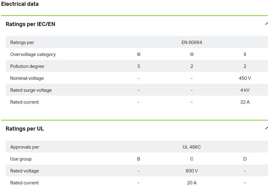

So up to 450v they are rated at a 32 amps. That drops to 20 amps at 600v.
I am not an electrician, but I find them to be far more convenient than the cheap screw connector blocks. And they take up much less space behind light switches, etc.
Where did you see that? It shows 20A @ 300V.

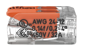

On one side:
and on the other side of the same connector:
I do think that they could have made this clearer for the average user.
