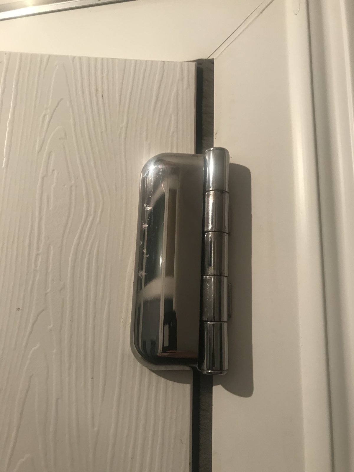

Are these Silodor hinges adjustable?
14 Sep 2010
7,065
905
Rochdale
I could do to slightly adjust these if possible:

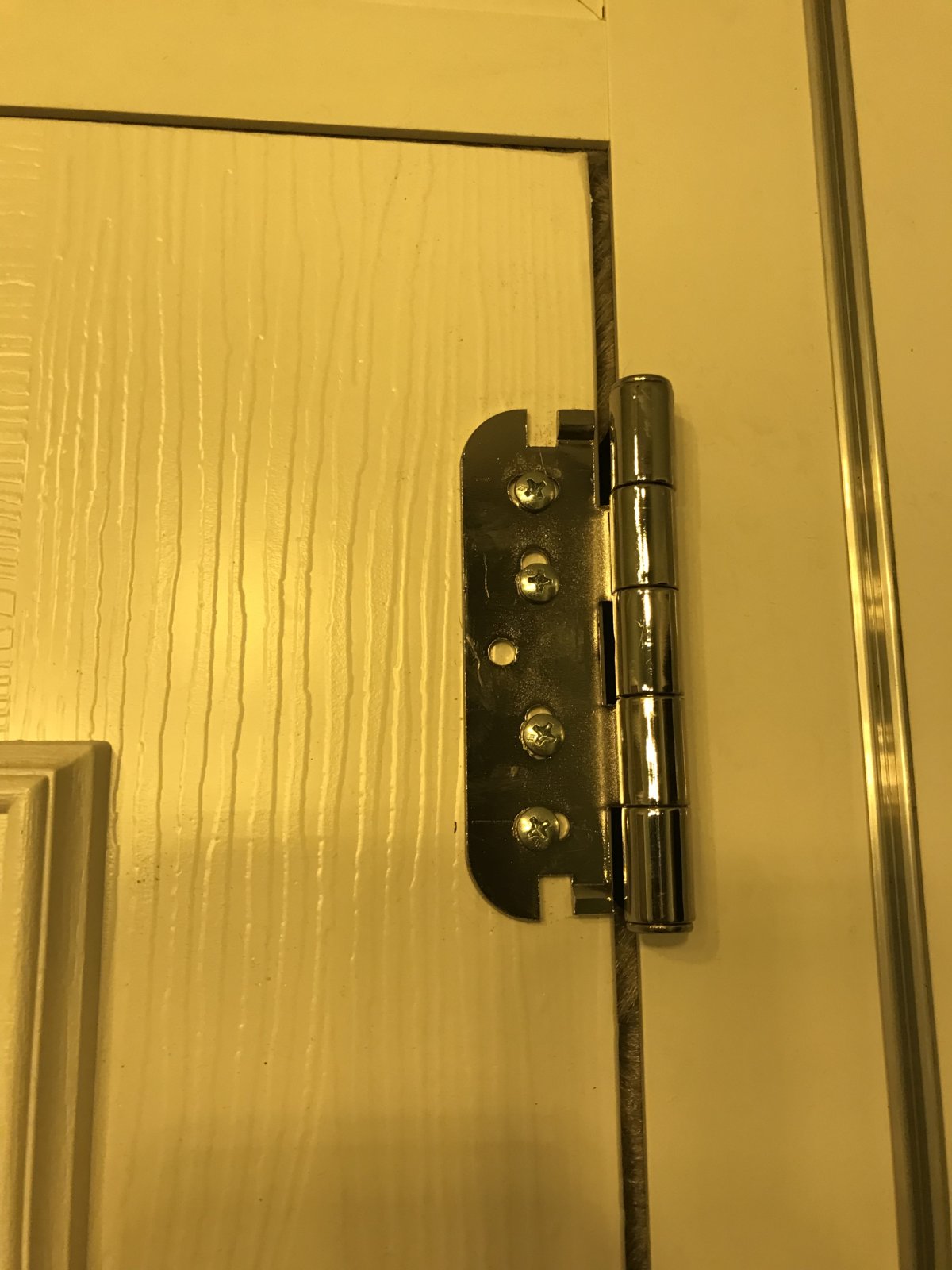

There was a tiny bit of adjustment in the screws under it. I loosened the screws and tapped a wedge in the other side, the door shuts much better now.
