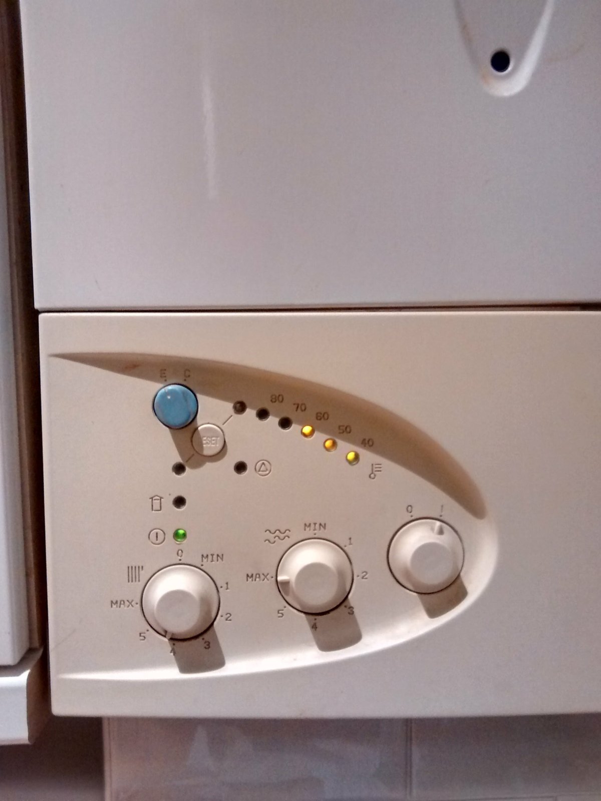

Hi, I have an Ariston 27 MFFI combi boiler, with only DHW running when I turn the Hot tap full on and the DHW Temp dial set at Max the temperature LED's on the boiler go up to 60 and no further.
Is that correct as I have seen a YouTube video where the same model boiler lit up the higher LED's when testing the DHW.
I'm wondering if the DHW temp probe on mine might be faulty ?

Hi, thanks, I just tried it again with the minimal DHW flow and it still stayed at 60.
But then I noticed something strange. The CH Flow pipe leaving the boiler was just as hot as the DHW pipe and stayed as hot until I switched the DHW tap off. And the CH hasn't been on for hours. When the DHW stopped the CH Flow pipe cooled off quickly.
The reason I am checking the boiler today is while the CH was on at t-time, the DHW was'n hot, just warm, I was easily able to hold my hand under the tap. When the CH was switched off the DHW got hot but the LED's stuck at 60. Hence my original question.

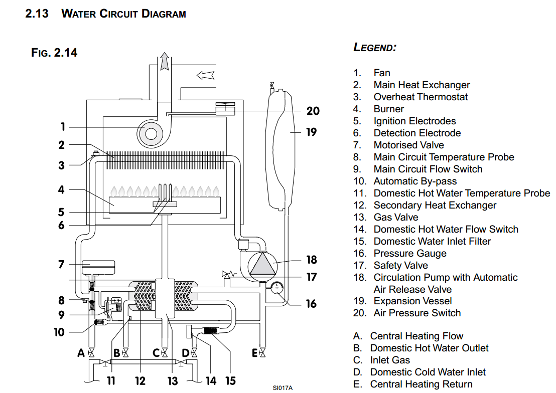

But now I'm wondering if the Diverter valve is not fully sealing and allowing hot water to flow out through the CH Flow pipe when DHW is requested.
If so I think you can get a Diverter Valve repair kit that might be worth a try ?
I've bought a new Diverter valve instead of the kit and to avoid draining the complete house CH system I can shut off the Flow (A), Return (E) and Cold (D) with the valves under the the boiler and drain the DHW by running the hot tap (B)
But I can't see any tap to drain the water that will still be inside the boiler heating circuit.
Is it a case of uncoupling the Flow nut above its isolator valve (A) and catch the water there, at least it's outside the boiler enclosure so won't get all the wires & internals wet ?
Yes; but you may also find that once you've done this, the heat still doesn't reach maximum, as you've also got a clogged up heat exchanger as well.
