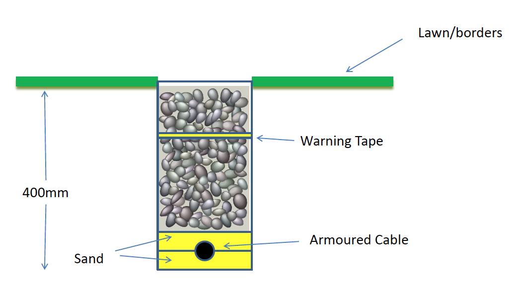

I'm digging a trench for an armoured cable to run power to my man cave / garden room.
how deep do I go? and is it ok to run it diagonal across the garden?
I'm getting an electrician to do the final connection and certification. but want to make sure I do the rest right.
Has the electrician told you what size cable to get before you bury it?
2.5mm armoured. but I have lots. was going to dig 400mm down and put warning tape at 250mm

Depth depends on what is above it. As a general guide

@Taylortwocities Do I have to do anything to stop rain water running in to the ducts?
Armoured cable is designed for outdoor environments, including bring totally immersed. You don't need to worry about water!
