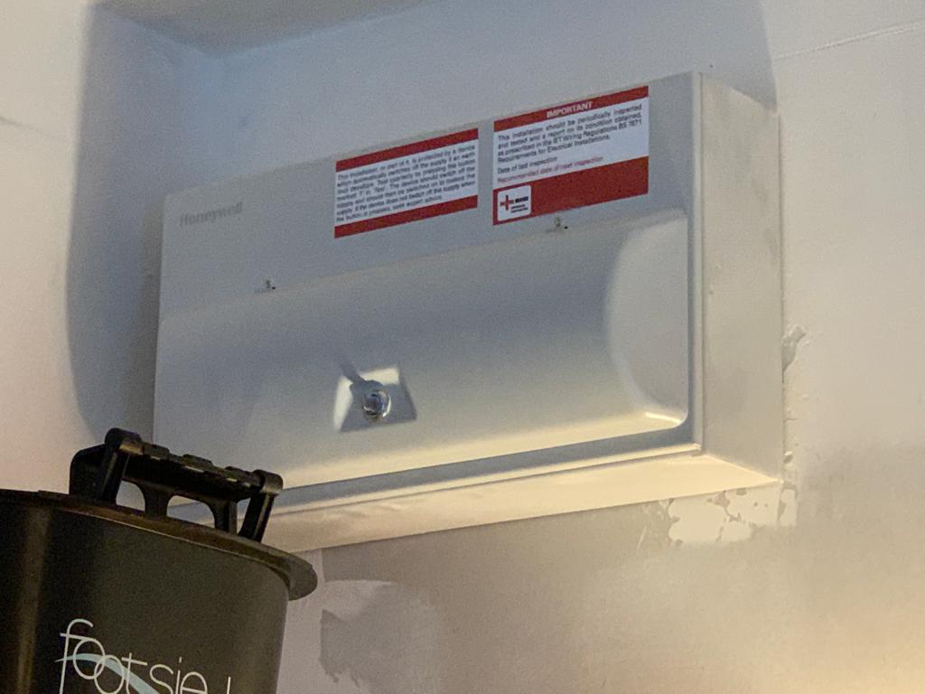

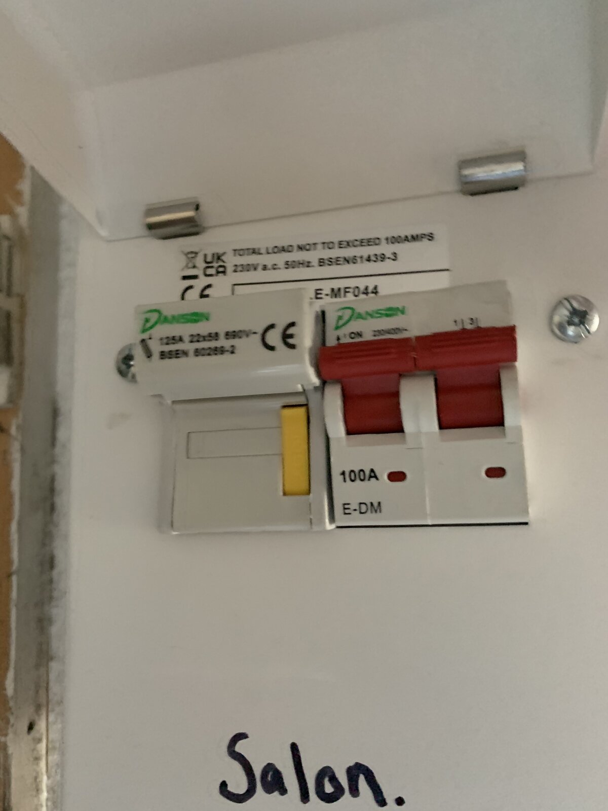

to what is the studio cable terminated? sockets, a small cu? pics will help
We went for 16mm as it’s a nail salon. I installed a ring for the sockets and a radial for the lights, all signed off, no fires, pops or fizzes! The shed will have lights and sockets, prob a fridge for fishing bait in the summer but nothing heavy.
Perhaps taking a feed from the CU would be best as we have multiple free banks, we’ve only used 4 out of 15 or so in the CU.
Yeah, assuming the shed is close to the studio, feeding it off a breaker in the studio CU seems the most sensible approach.
That's a switch not an MCB. Possibly you have fuses in the carrier to the left of it.
The nail salon could be fed from henley block and it's own tails so that 100a switch is what supplies the salon direct from whatever the main cutout fuse is.
That would be wrong if that were what was installed, the DNO will not allow their fuse to ptotect a private submain.
But what you have pictured is a SPN switchfuse, what size fuse is fitted?
I'm hoping the Danson consumer unit has a 63A Danson "consumer unit" <<<< 88 type 2 I think
Whats the ZS/ZDb inside the Salon consumer unit? (should be on the Test results the installer has hopefully supplied you)
