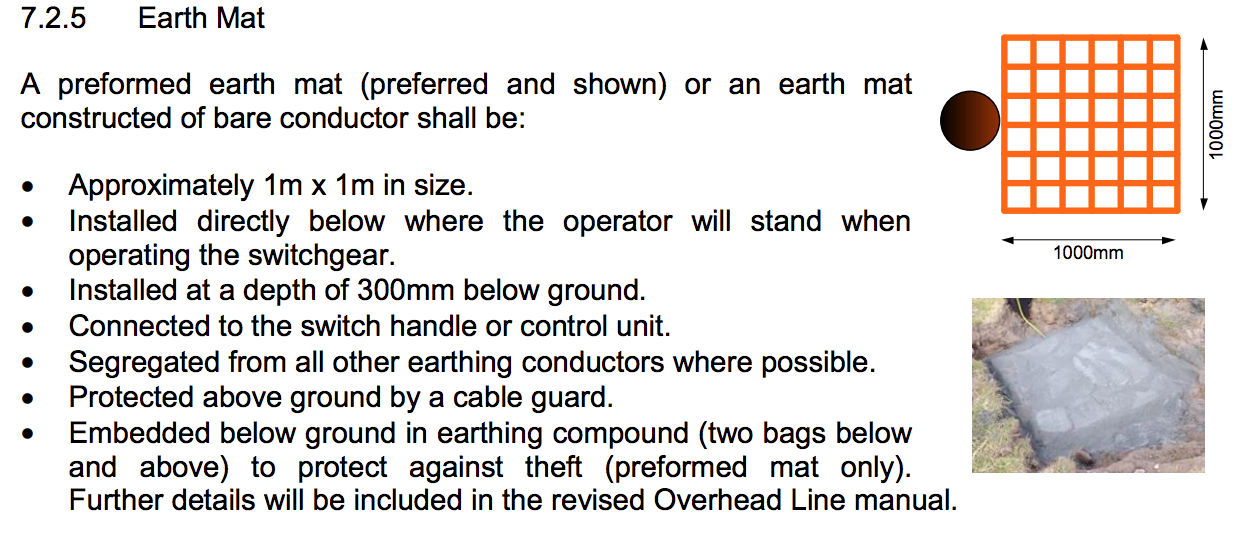

To help answer your question, it's not really dealt with a lot. it's only really mentioned in the literature here:
https://www.voltimum.co.uk/articles/q-day-extraneous-conductive-parts
re farm/livestock, so not really domestic:
http://www.installeronline.co.uk/wp-content/uploads/2013/05/Down-on-the-farm.pdf
"Wherever possible, metal grids should be installed within the floor and connected to the supplementary bonding. Where there is no such metal grid, the use of PME (or TN-C-S) is not recommended."
re hv->lv substations, clearly a lot more risky. bottom of p27 deals with bonding the ground
and pole mounted controls
theres a lot of interesting design of how to bond things that you wouldn't normally bond!
https://library.ukpowernetworks.co....istribution+Network+Earthing+Construction.pdf
as an additional reference, it seems UKPN will recommend against PME when there's a flat with a shower downstairs, unless it has an "earth" grid under it
" Very often these properties have concrete floors and the ground floor flat may be equipped with a shower and it is often impractical for the builder to install a bonded earth grid in the shower area. Section 6.7 describes the risks associated with showers located at ground floor level and where an earth grid is required. The absence of an earth grid should be discussed with the customer, and a TT earthing system with an independent earth electrode and RCD protection considered as a more appropriate alternative to a PME earthing system."
http://library.ukpowernetworks.co.u...+Customer+LV+Installation+Earthing+Design.pdf

... re farm/livestock, so not really domestic: ...
As we've discussed in the past, livestock, particularly 4-legged ones, create a very different, higher risk, situation - but not something one usually encounters in teh domestic situation (hence a DIY forum)!
... "... Where there is no such metal grid, the use of PME (or TN-C-S) is not recommended.
... AND ...
" Very often these properties have concrete floors and the ground floor flat may be equipped with a shower and it is often impractical for the builder to install a bonded earth grid in the shower area .... The absence of an earth grid should be discussed with the customer, and a TT earthing system with an independent earth electrode and RCD protection considered as a more appropriate alternative to a PME earthing system."
It's interesting to see them seemingly acknowledging that the earth they supply is more hazardous than a TT installation. Whilst this difference in hazards is exacerbated in the presence of livestock or with showers on concrete ground floors, it is always there to some extent - which makes one wonder how well they sleep in the knowledge that (presumably primarily to save cost) they are providing millions of customers with earths that are more 'hazardous' than they need to be!
