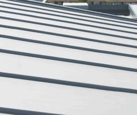

Hi,
Does anyone know about ArmourPlan roofing with regards to aesthetics? In the below image you can see vertical bars going down it which is more pleasing to my eye than something purely flat.
Anyone know how this look is achieved? Is it just wood or steel profile which is affixed to OBS3 board?
armourplans just a heat welded single ply and they standing seams are just welded on to mimic lead. its just for aesthetics when used in that situation.
Thanks for the info.
Does anyone have a rough idea what these profiles cost per strip and how long they are?
