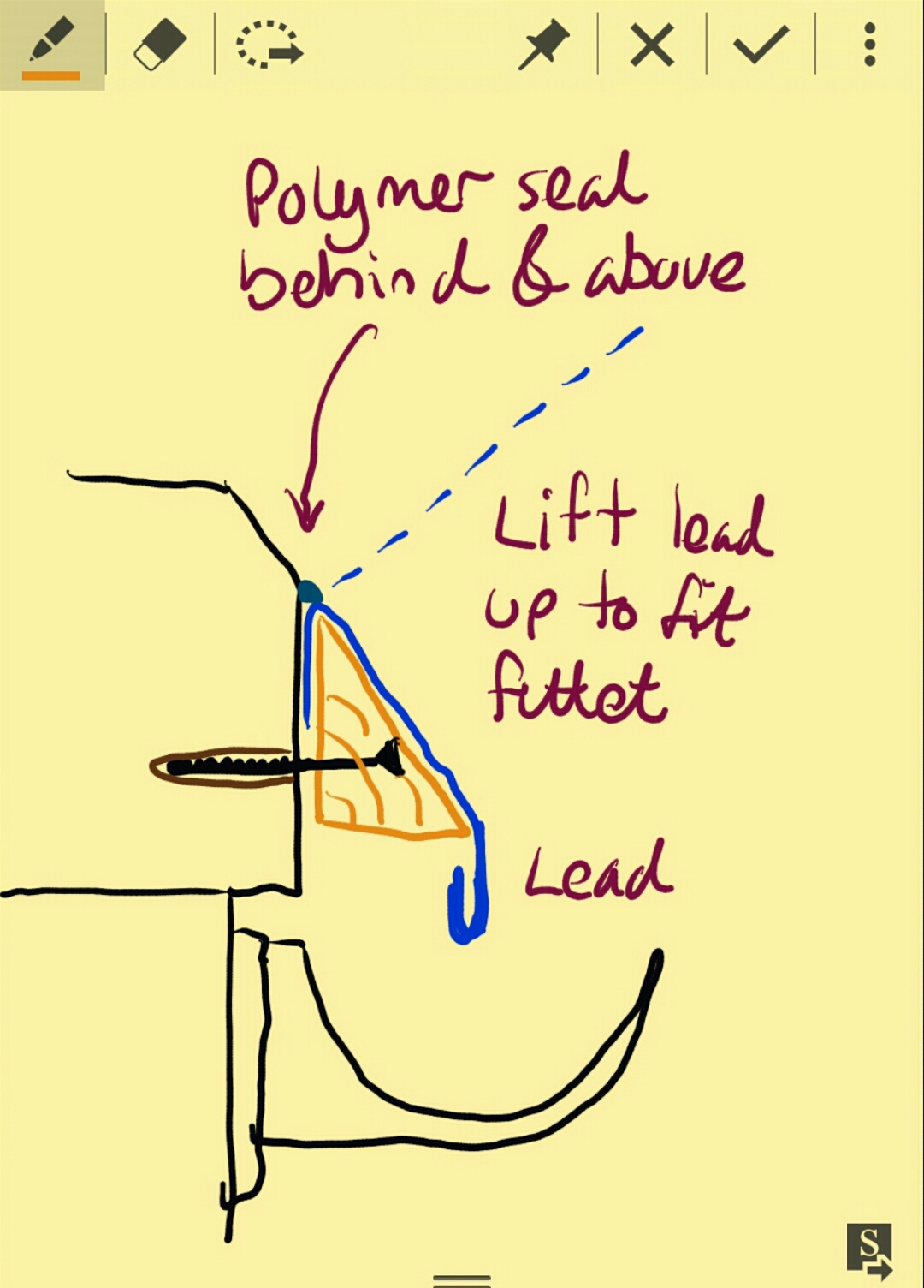

Tanalised tilting fillet fixed to roof, with lead cover. The lead will need to be in 1.2 or 1.5m lengths depending on whether code 4 or 5.
Thanks Woody. The concrete edge is already as far over the gutter as the lead in your diagram, so I think an arris would take it too far out.
What I propose to do is fix some black uPVC soffit (9mm x 100mm) flat to the edge with screws and mastic, extending downwards over the gutter and use uPVC angle at the corners. The soffit comes in 5m lengths so I can do each of the three sides without joins. Black caps over the ends of the screws and I think that will look as tidy as uPVC can.
