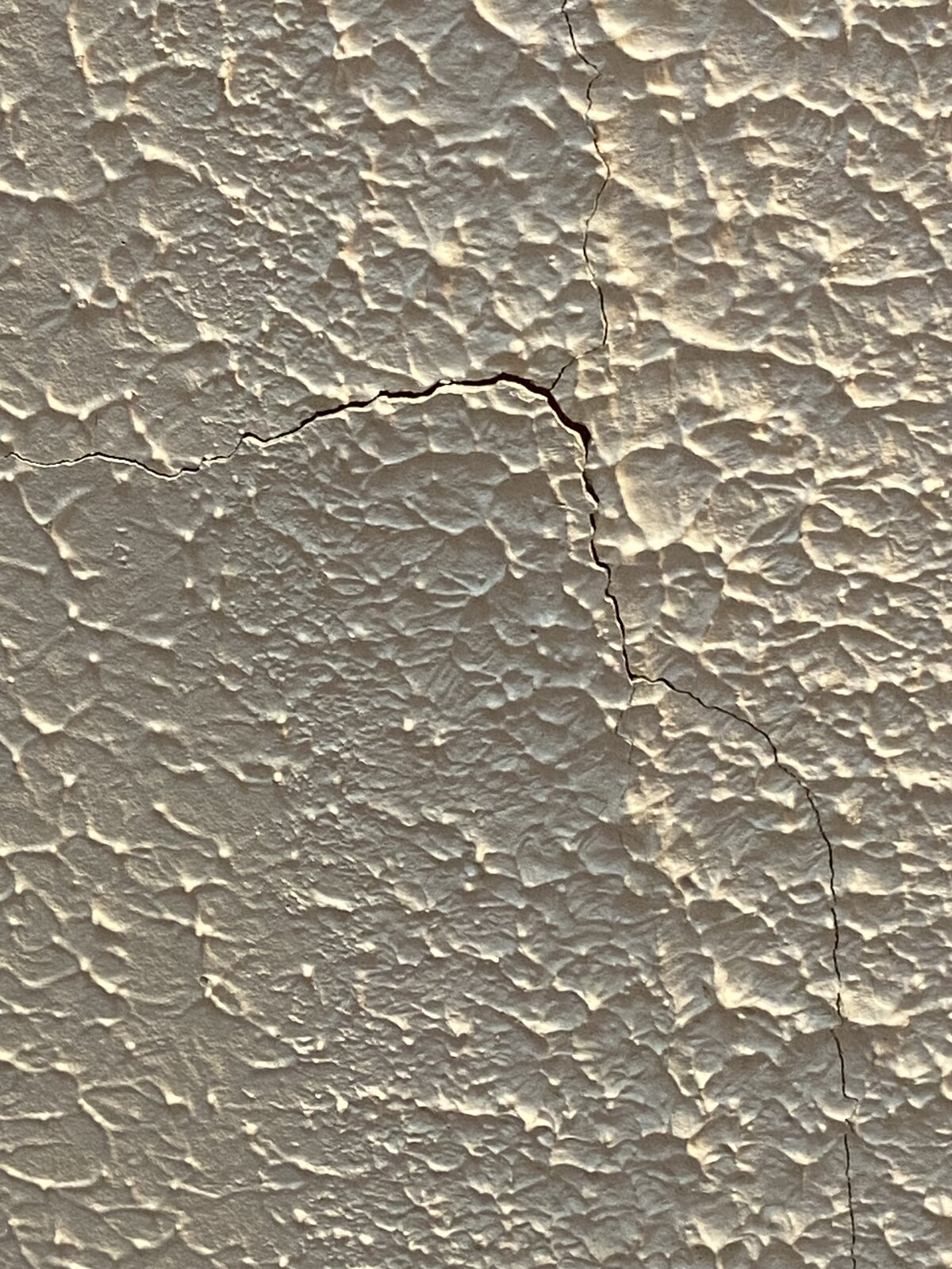

I have just bought a house and ceilings tested positive for asbestos. Cracked in places. Not really sure how to tackle this, want to protect the kids from fibres please help.

Is the picture representative of the whole ceiling or is that the worst offending area and the rest of the ceiling is relatively in tact ? If so, an argument could be made for skimming directly.
That first picture is a patch up job that someone has attempted. Still come away so i guess there is old lime wash paint under the artex. Never going to last even with another patch.
