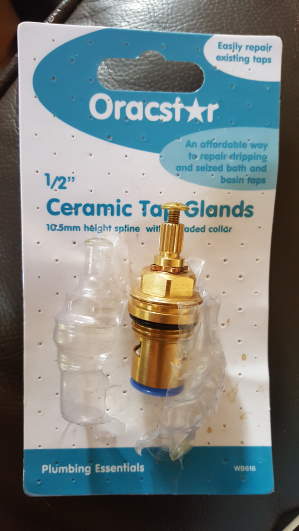

Having, with invaluable help from the experts here, replaced my toilet and fited new taps & waste to my aging bathroom basin, I've decided to tackle something (hopefully) a little simpler next. This is the sink in my utility room:
Two problems here: (1) the hot tap leaks badly from between the tap handle and the mixer body. I believe I can buy replacement "glands" from Screwfix, but unfortunately I don't know which kind - they tend to list them under brand names, eg Flomasta, Bristan etc - anybody recognise these? Don't really want to replace the entire mixer at this stage if I can avoid it, as the whole lot will probably be ripped out and replaced next year...

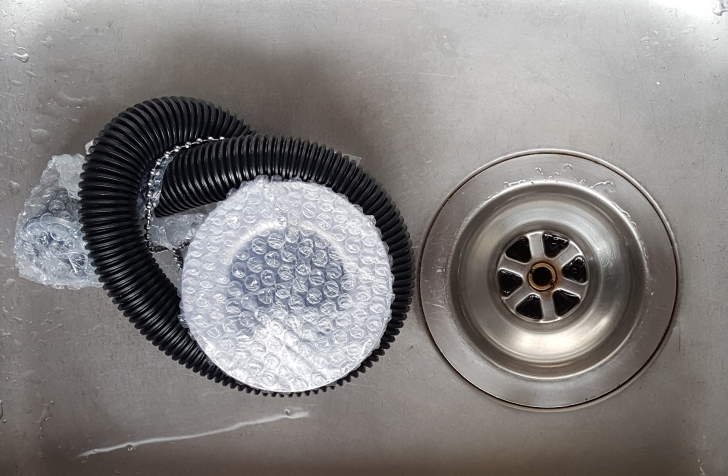

(2) no matter how firmly I press the plug into the waste, the sink empties in a minute or two, so I was thinking of replacing the waste... if I do, will I likely need to use a "basin mate" to seal it properly, or do you not get the same sealing problems with stainless sinks? PS also the waste isn't slotted - the overflow goes down separately into the trap below.

They tend to use O rings these days to seal the spindle to the tap body, so no adjustable. Fix is to buy a box of mixed O rings, as sold by Lidl/Aldi to have to hand. Alternatively, you can buy the complete tap insert, to just screw into the body - your 'glands'.

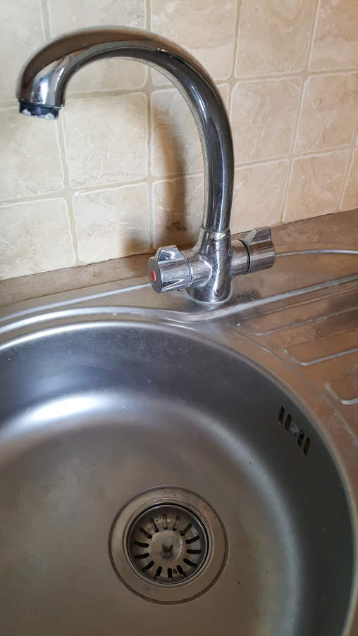

My problem, is removing the plastic filter/jet in the end of the spout in the photo. It has flats for a spanner, but it is so tight and flexible, the spanner just slips off. I'm looking to get it out, to give it a clean, but have so far failed.

Think you’ll have to use the Mole Grips. I once dated a lady called Debbie Morris, from Leominster, who told me her great grandfather or somebody had founded a tool company there, called MOL (Morris of Leominster), and invented MOL GRIPS. Wikipedia tells a very different story, which rings true… any wonder I don’t trust women…
Glands, can you unscrew one and take it with you to compare?
Waste, you need a new 'Basket waste', everything required will be in the pack. Cheap version £3.99 at Screwfix, it you want to guarantee no leaks, maybe better to buy a more expensive one. Basins are a bugger to seal due to their design.
Take the tap handle off to establish if the leak is where the valve meets the tap body ,or is it from the spindle where it 1/4 turns in the valve body ? If its the former ,wrap the threads in PTFE. If its the latter ,remove the valve and source a replacement.
If you're going to replace the sink waste then no, no basin mate needed. It uses a flat rubber seal on the underside cup and the steel face is flat so seals easily. Just ensure the steel is flat and clean and dry and give the centre nut/screw a good nip up.
Make sure you get the waste with overflow kit that will fit your current sink. Rarely get the same size of overflow pipe on a replacement basket.
Well... think I got stitched. I saw some on Screwfix which LOOKED right, but decided to go to a local plumbers' merchants with the original, and say "two of these please" to be sure.
So I got (and fitted) some, but got charged £19 for something which cost less than half that at SF... sigh... oh well, at least the tap is OK now...

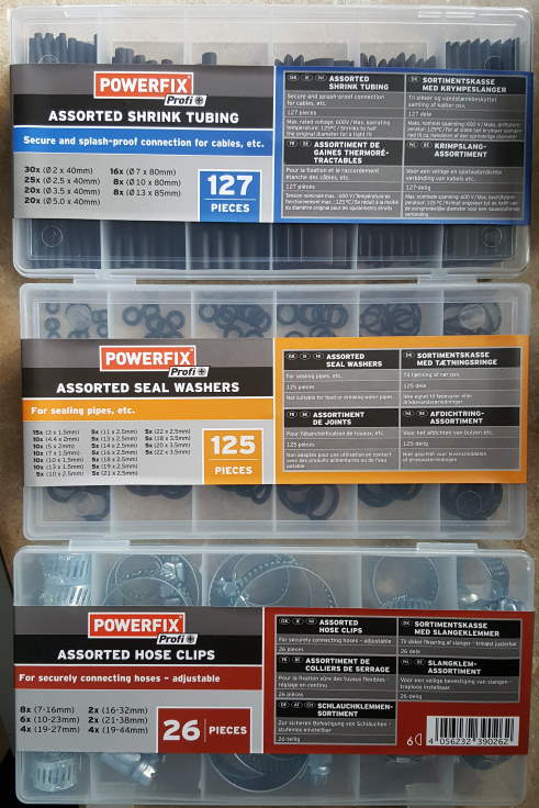

I've just got back from our local Lidl and as it happens, they have O ring kits in stock at £2.99. There was a mix of boxes of odds and ends, all in translucent boxes - washers, small nuts and bolts, jubilee clips etc.. My kit from a decade ago, came in a green specially made for O rings box and quite comprehensive mix of sizes.

Update 21/08/19 - got this little lot there today, only £2.49 a box - that'll keep me out of trouble for a while :cool:

Well I bought the £3.99 one, and it looks like maybe my sink is a non-standard size... the Screwfix jobbie measures about 90mm across the top, but mine is more like 115mm - can I get one like that? The SF ones don't appear to be described very well, saying things like 32mm etc, which they clearly aren't :mad:
I think the one you bought is the smaller type for basins (hence the 32 mm)
Think you'll need this one. It has the rectangular overflow to suit your sink, so you may replace that as well if you like!

Yes, I had assumed that my rectangular overflows were some kind of weirdo ones, and woudl have to replace the entire sink if I needed to do them, so this is good news!
