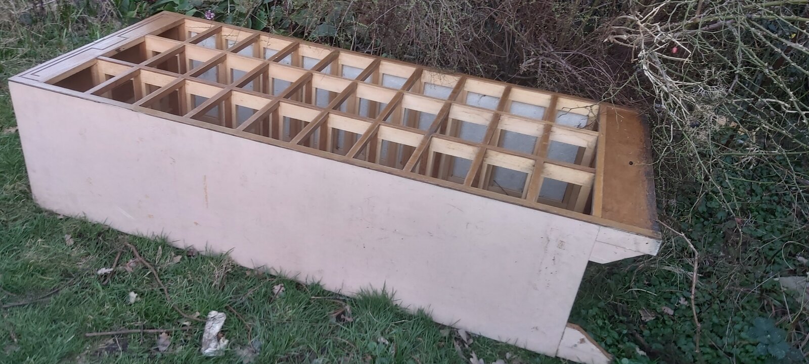

Hi
Little bit of advice needed
Do the sides and back of this potentially look like like asbestos

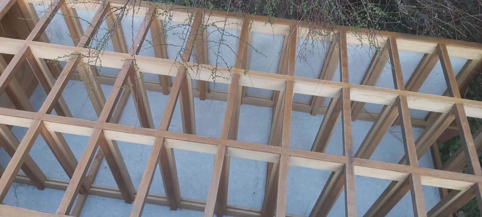

Lm2021, good evening.
OK Images are good, but? can you[if possible] get close up images of the edges of the material please.
Ans if possible images of in close up of both sides of the material.
Ken.
What was it? And what was it used for?
Not being funny but why would t be made out of asbestos?
Doesn’t look like asbestos imo.
Is the inside of the board dimpled? If so it could be asbestos cement board. It turns up more often than you might think in cabinets and cupboards.
Don't worry though, it's not dangerous. Although it does need to be treated and disposed of correctly.
it looks similar to the asbestos I found in my house though the best thing to do is take a sample and send it to a lab as no one can really tell you form the pictures, I did that at my house, it was only £15 a sample... or you can even use amazon kits that have a return label etc - if you're so worried use gloves and a mask when taking a sample and double bag it before sending it
