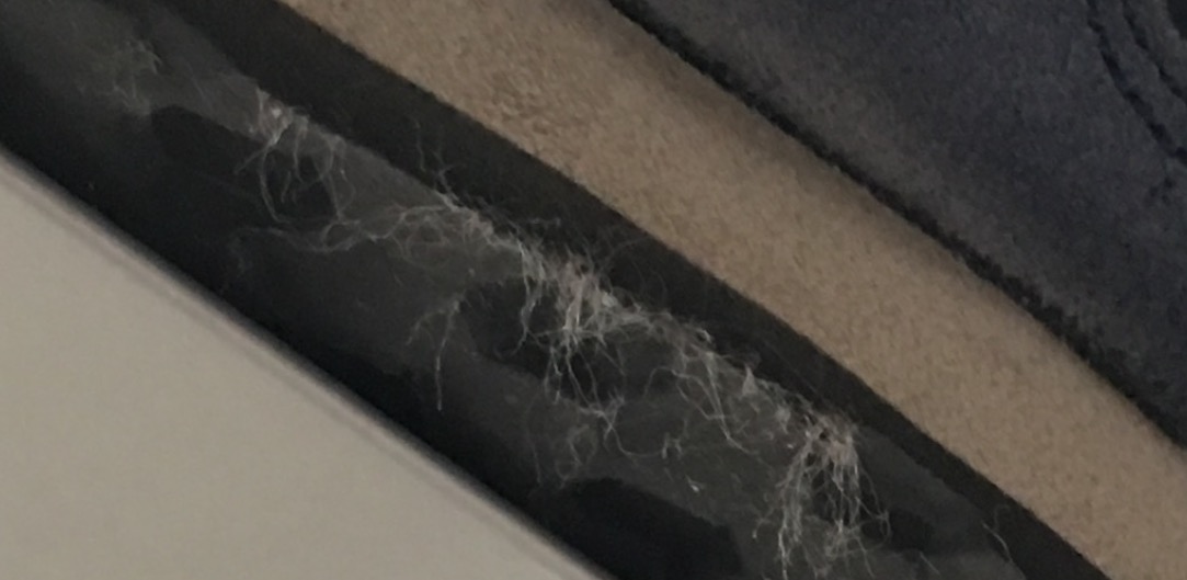

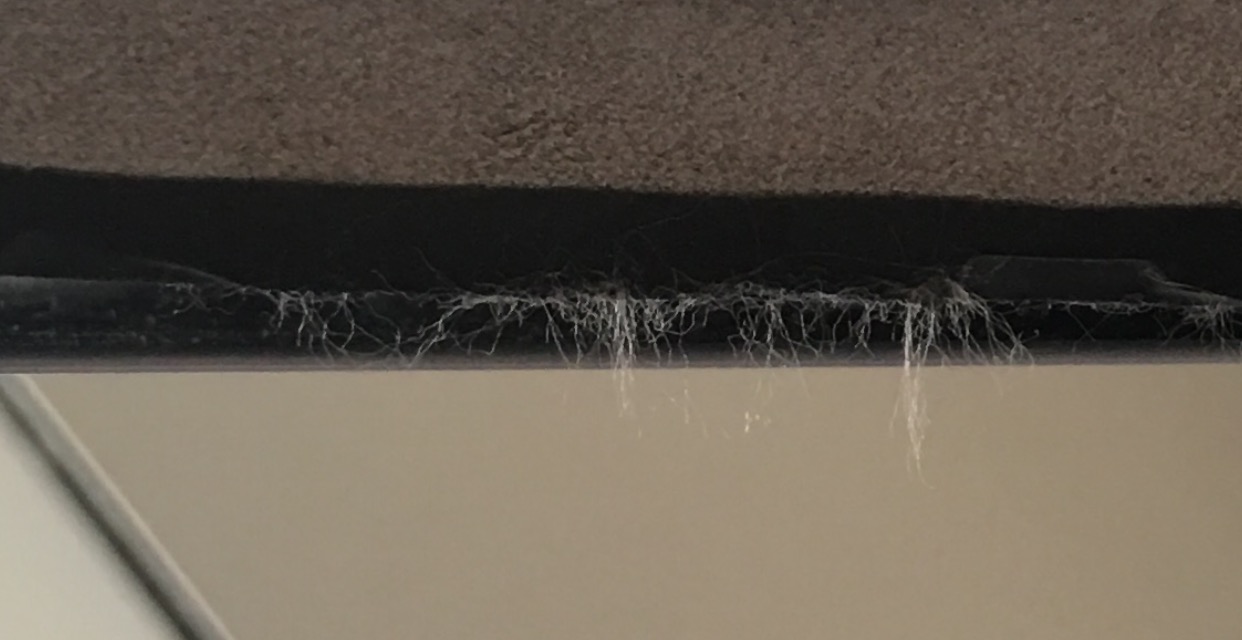

went to a house recently where they'd had asbestos insulation board removed in a porch the week before. Done by a professional company in enclosure with 4 stage clearance procedure done by anslyst etc.
I have massive worries about asbestos and wouldn't have taken my kids there had I known beforehand (house owners didn't see issue as all done properly etc - I guess many people wouldn't actually see the issue ) Anyway due to my massive fear I've got myself into a panic that I have spotted potential asbestos fibres on a shoe that was worn there (not been worn since).
Does anyone here know what asbestos insulation board debris would look like - would it be possible to pick up fibres like this (about 0.5 -0.75cm long)
I'd be grateful if you could look at the pics and let me know

AIB often contains Amosite.
Your pics look like cloth fibres to me.
Testing will be only way to prove it.

Wipe the shoe with a damp cloth and then bin it. Seems like quite a lot of whatever it is so a proper company wouldn’t have missed that much in my opinion. Plus, again in my limited knowledge, wouldn’t insulation board be more bonded like cement board? That looks like long fibre strands. More like what I’d expect of lagging..... which it wasn’t.
Be concerned and get rid then sleep easy.

I'm after someone with knowledge who can tell me if AIB debris is likely to look like that?
It is very, very,very, very, very, very unlikely that what you have photographed is asbestos.
The only way to be 100% certain is to take a sample and have them tested - nobody can give you a definitive answer except the person actually conducting the test.
PS - AIB debris doesn't look like that. The most common form of asbestos used in AIB was amosite which looks very different from long flexible thread as seen in your photo.

The AIB was removed professionally and a certificate of reoccupation issued the previous week. Im thinking it's unlikely that any residual dust would have been together in such a big "clump" plus they're not needle like fibres which amosite is. Finally, the shoe (and its owner!) walked around a supermarket afterwards. Surely this would have broken long fibres up more and they would have dropped off the shoe?
