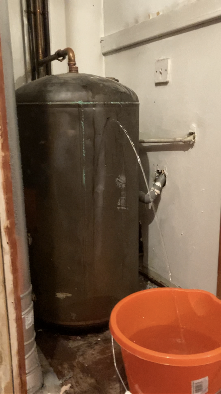

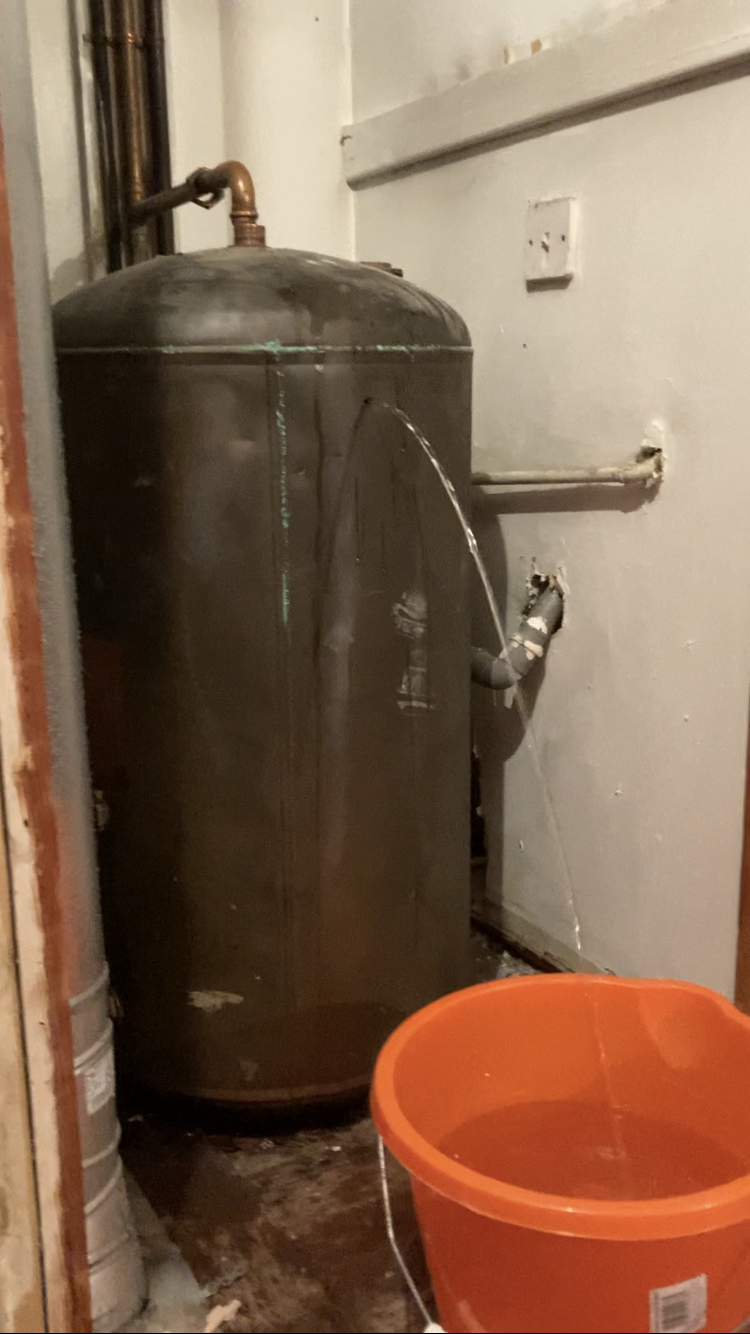

This? It had a plastic red jacket on it … that we took off x
That's the kiddie. The "plastic jacket" normally contains either fibre glass or mineral wool insulation. It reduces your electricity bill a bit by retaining heat in the cylinder. Not as good as a modern insulated cylinder, but nevertheless they do reduce your bill a bit, so why remove it unless you intend to replace the cylinder?
Edit: Just realised that yours appears to have a leak...
We’re getting a combi boiler with radiators as the house currently has a ducted air unit throughout the whole house
That is your hot water cylinder, heated by the circulator (water heater) inside the warm air heater case to the right. It has no immersion heater, though there is a plugged off opening for one in the top of the cylinder. If you are getting a new cylinder, get the correct type, probably a direct heated one rather than indirect. Nice bit of scrap value in the old cylinder.

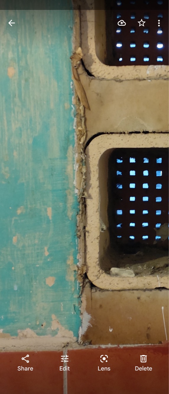

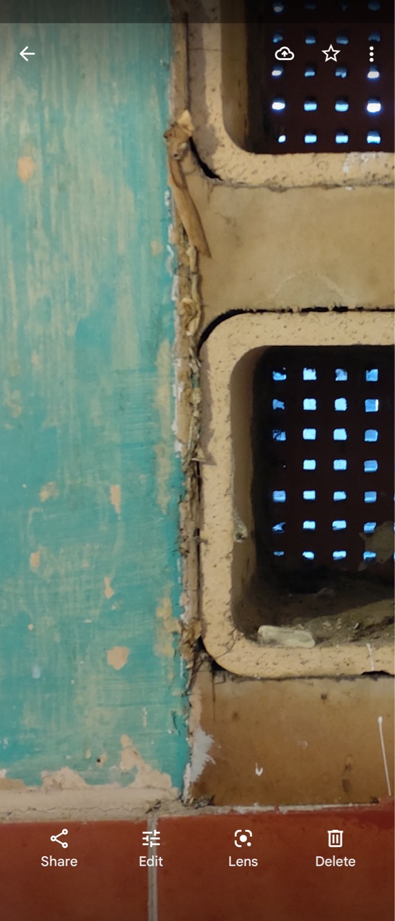

What do you feel about this around the kitchen window? Plasterboard? Also could the vents be made of anything dangerous?
