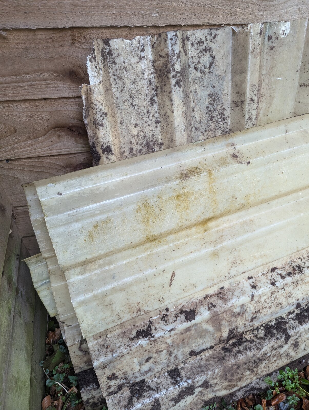

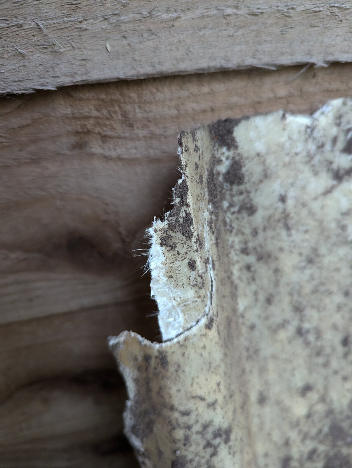

Hello!
I removed these translucent plastic looking corrugated sheets from the bottom of the garden (recently moved in), on seeing the fibres photographed I then got worried that they could be asbestos. I appreciate difficult to say but does it look more likely to be fibreglass or asbestos? Thanks!

Fibreglass, asbestos wouldn't be translucent and these fibres are too big, you'd need a microscope to see asbestos fibres
